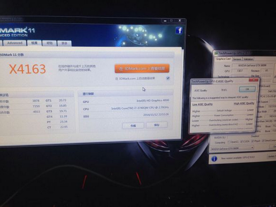

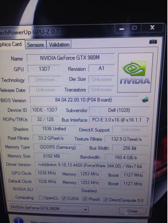

This is M17x I guess?
我似乎把GTX980m装上去了……_alienwareå§_百度贴å§
I don't think SLI and Optimus is even possible
Maybe johnkss is trying to figure out if the BIOS work with Optimus vbios. It may not actually use Optimus, just let it boot properly perhaps?
我似乎把GTX980m装上去了……_alienware吧_百度贴吧
M17xR4 PCI-E 3.0
i7-3740QM HD 4000
SLI and Optimus? O_o
Edit: Oh you are just using one GPU to see if that method makes it boot up properly? Then what? :)
Yeah only one 980m can work as optimus.
Optimus and Sli dont work together. Yeah you're right.
M17xR4 PCI-E 3.0
[ATTACH=CONFIG]13125[/ATTACH]
i7-3740QM HD 4000
[ATTACH=CONFIG]13126[/ATTACH]
That picture was done with optimus right?
