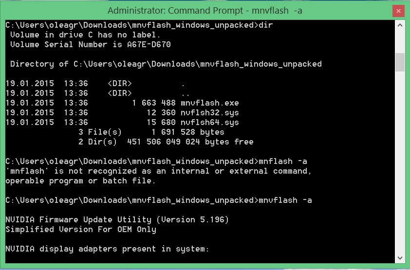

  1. You are not reading what I wrote. Read: You obviously have Legacy enabled because you were able to use mnvflash. It doesnt work with Legacy disabled and UEFI enabled. Thats pure UEFI. You understand the difference? Alienware 18 with 970M/980M can only use pure UEFI. No legacy, no mnvflash or nvflash. GT72 can use whatever it wants. Legacy or UEFI or both
  2. It won`t work. You have UEFI and Legacy enabled. We have UEFI and Legacy disabled. mnvflash only works with Legacy. If we enable Legacy we are fucked so we can`t use that option. Disabling 1 or two cards, deleting drivers, running in windows, using cmd etc etc, it doesnt matter. UEFI are in the way both mnvflash and nvflash doesnt support pure UEFI.
  3. Nothing happens. You just disable the Nvidia driver. The cards continue to run on Windows drivers. But its useless. I tried disabling the drivers, SLI on and off, with drivers, the mnvflash still cant find any cards. Its because it doesnt support UEFI. So we are stuck I posted screenshot a few pages back

  8. @svl7 : Any chance you can mod nvmflash to be usable with UEFI (Alienware 18)? It tries to find the adapters but is stuck. Right now I can`t even flash my GTX 970Ms on this locked down machine :/ I`m looking to downvolt my GPUs because HWInfo can only do 0, low and high fan settings. And the low is almost enough but I need to downvolt them to be able to. Here is what I get using mnvflash. I tried having it on for 5 minutes but its stuck
