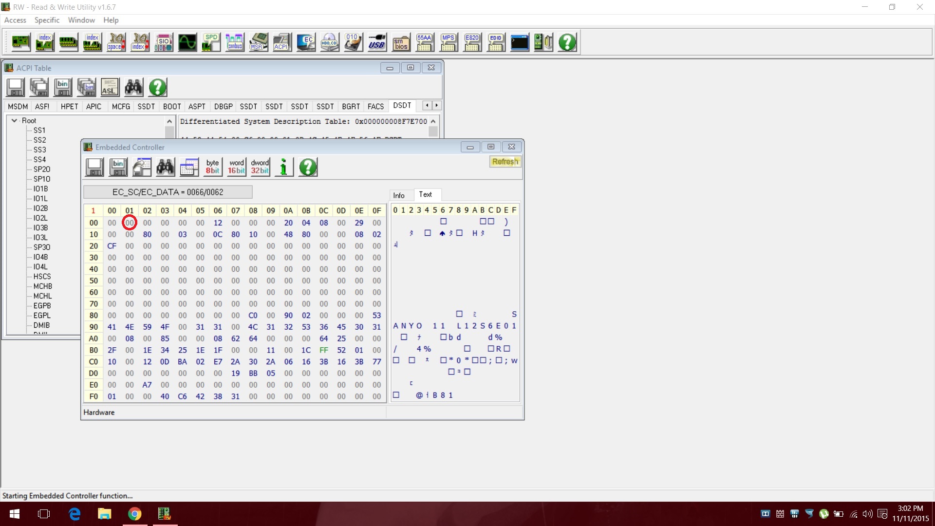

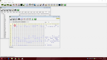

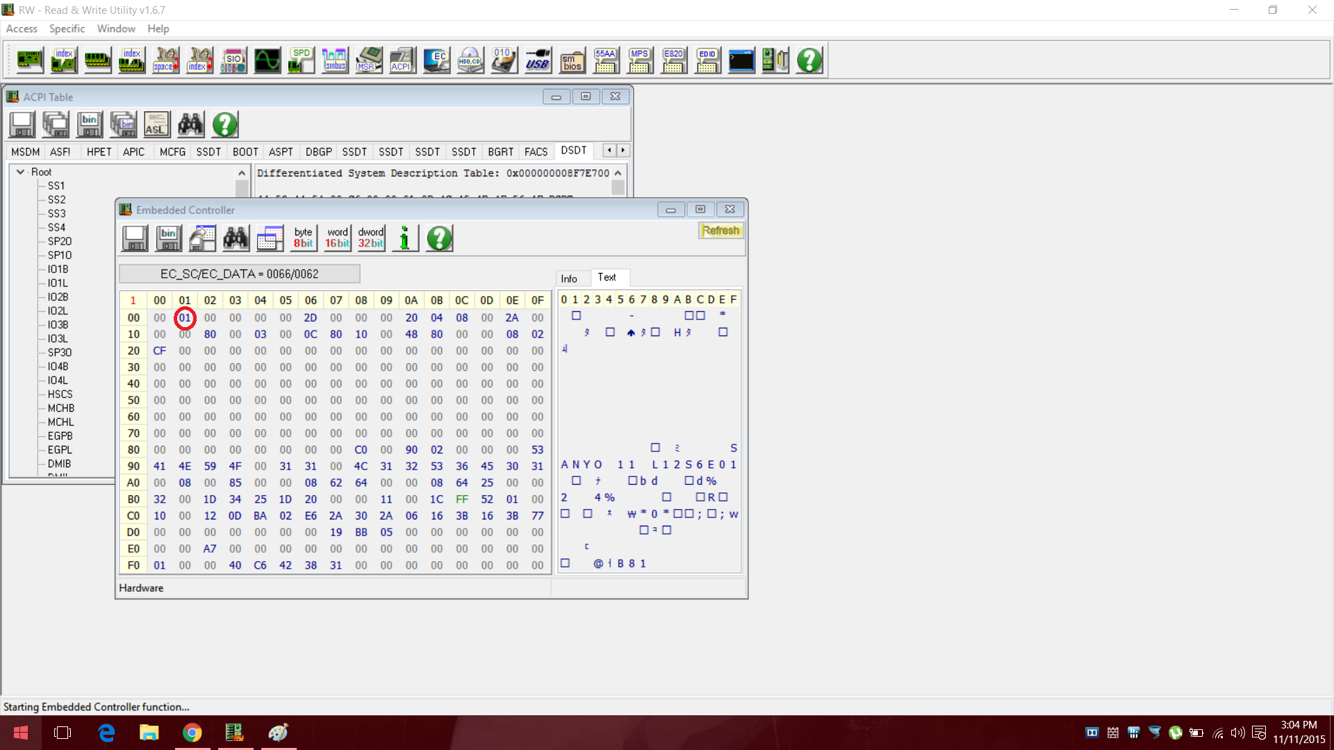

daicharade1 12 Posted November 11, 2015 @allstone I tried looking through the Embedded Controller with RW. I don't understand much of it so I didn't change values but I did notice one value changing when I switched on IdeaFan. Some pictures below: Quote Share this post Link to post Share on other sites

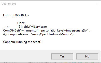

Cenkris 10 Posted November 24, 2015 Yo. Same situation as you are in right now. I've found a temporary work around for this:You might notice that even with this error message the program still actually runs without fail. However the error message would not go away. So what did I do? I basically use Virual Desktops feature implemented in Windows 10. You create another Desktop (google it up if you dont know how), Bring up the tasks with Windows Key + Tab => right click the error message => Move to => Desktop 2. Bam! There you go. Now you're free to do what you like with the error message out of sight since it's now displayed on another desktop.Epic, Thanks man!!! Quote Share this post Link to post Share on other sites
