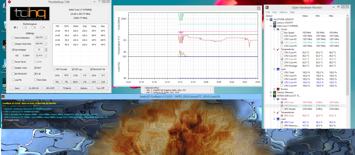

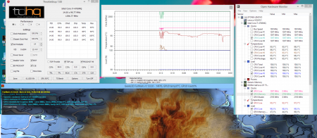

Basically, running Furmark, if I do not run this program, I constantly run into 97C and thermal throttling for my GPU (see Mhz of core and memory):
And when I do run this program, it manages to keep temperatures at 88-93C and there is no more throttling in a long run.

After about 20 minutes, I was greeted with these pretty amazing results: 1sHnyTxnzbvyD0472PdC2hl3IeMsj1_thumb.png
And that's with 99% GPU usage, actually playing games will make your usage fluctuate anywhere from 60-99, so expect even LOWER temps. Highly recommend this tool. You guys should definitely thank @allstone for making this.

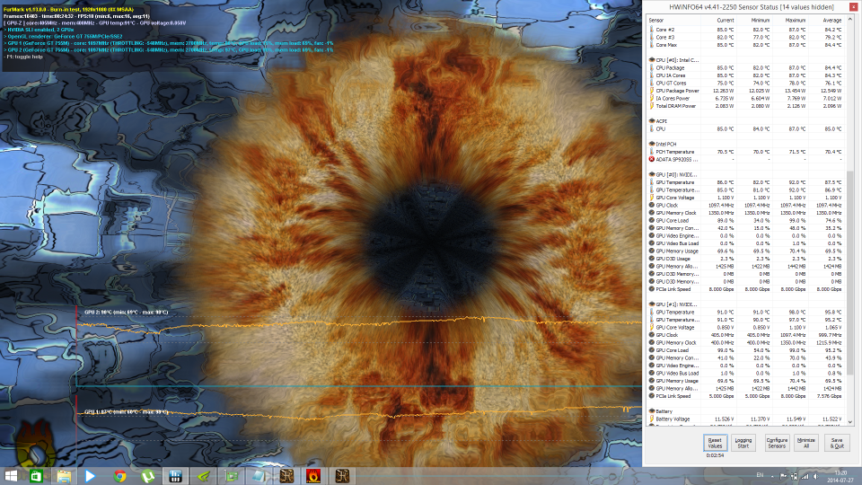

EDIT: @ghoul , I'm done...Man Heaven Benchmark gets boring to watch after the second run. Anyways, I'm on stock clocks(1058/2500) and undervolted -100mV and these are my results. I ran no MSAA, 1920x1080, and the Extreme preset..I forgot to turn on tessellation, but GPU usage is GPU usage.
After 5 runs:
Reset HWiNFO64 and 3 more runs:
Can't leave out the fact that my laptop is still sitting on top of my CM NotePal X3. I haven't tested temperatures with this test without the cooler, but overall, I'm still impressed with this script, and can't wait for it to be improved if it ever does.

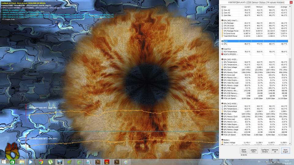

I redid it, only this time it wasn't as boring because I fell asleep. Still stock clocks at 1.0V(-100mV undervolt), but this time Heaven is completely maxed out, 8x MSAA, Extreme Tessellation, Ultra quality, 1920x1080, and fullscreen. I only took about an hour nap. Here are the results, you can see the exact time at the bottom of the HWiNFO64 window.
EDIT: Heaven was indeed in fullscreen. I just Prt Scr'd the HWiNFO shot and pasted it onto the screenshot I took of heaven, which you can see from the temperatures at the top left correlating with the Max temperatures in HWiNFO. That's why the "Current" temperatures are much lower than the temperatures you see in the MSI afterburner overlay.
