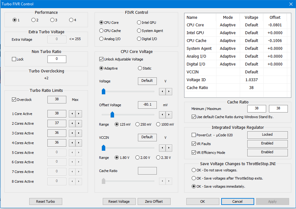

@iAchilles Dang, you got me. I lied about the frequency, thought nobody will notice :< I'm joking obviously. I never understood how 3dmark calculates the max turbo freq, but in reality the max turbo clock is set to 3.8Ghz. I've also attached some screens of my settings in TS as you asked before. I've changed my cache undervolt to -100mV instead of -125, because it crashed one time and undervolting cache doesn't really help that much. Just wanted to say - my settings won't give you maximum overclocking - my setup is designed to be quite balanced, so I'm conservative when it comes to CPU stuff. To get the most out of your CPU you should downgrade your microcode to 01,02 or remove the microcode updates completely, and then use TS to raise the voltage and overclock to insane freqs. Yet to my way of thinking without extra cooling it's pointless because the temperatures shoot through the roof when going over 4ghz and it requires insane amounts of voltage.

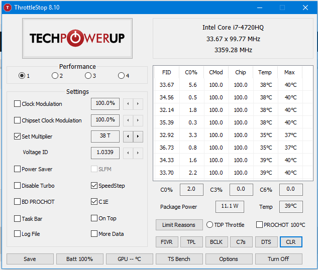

I'm using ThrottleStop to do it. Throttling isn't a problem at 3.6Ghz, especially with undervolting, which substantially lowers the temps. Basically if you have temps that are good enough, throttling will only occur at 4.0+Ghz where you have to raise the voltage and VRM temp throttling kicks in. That's why I settled on 3.8Ghz. @EDk-TheONE The thing is I didn't really try overclocking it to extreme core clocks since I finally learned how to unlock the vBIOS properly(not just forcing the clocks with MBT). I don't think the drivers differ in overclocking, because I'm getting artifacts at the same clocks as before. Actually my modded one allows for a bit more voltage so probably I could get even more points in 3Dmark but it's just pointless if it's nowhere near my stable clocks.
