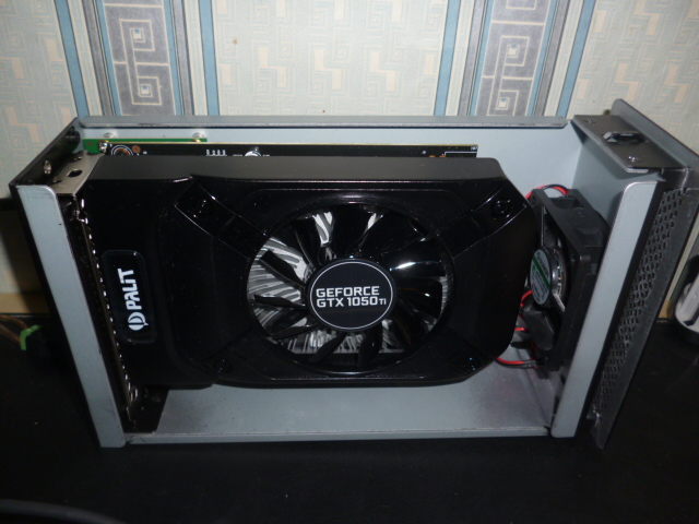

roman_kzn Posted November 13, 2016 Share Posted November 13, 2016 (edited) After many different attempts to start in boxing in Palit 1050ti came to the conclusion that it is possible nesomestimost hardware. Absolutely serviceable card: tested on 2 computers when running on the box gives an error 43. Resetting the system completely, replacing drayverov- install an older version of the drivers did not lead to success. Although the card consumes power 12V / 0.7 AAnd worst of all, the card is perfectly fit to boxing and would solve all my problems. Edited November 13, 2016 by roman_kzn Quote Link to comment Share on other sites More sharing options...

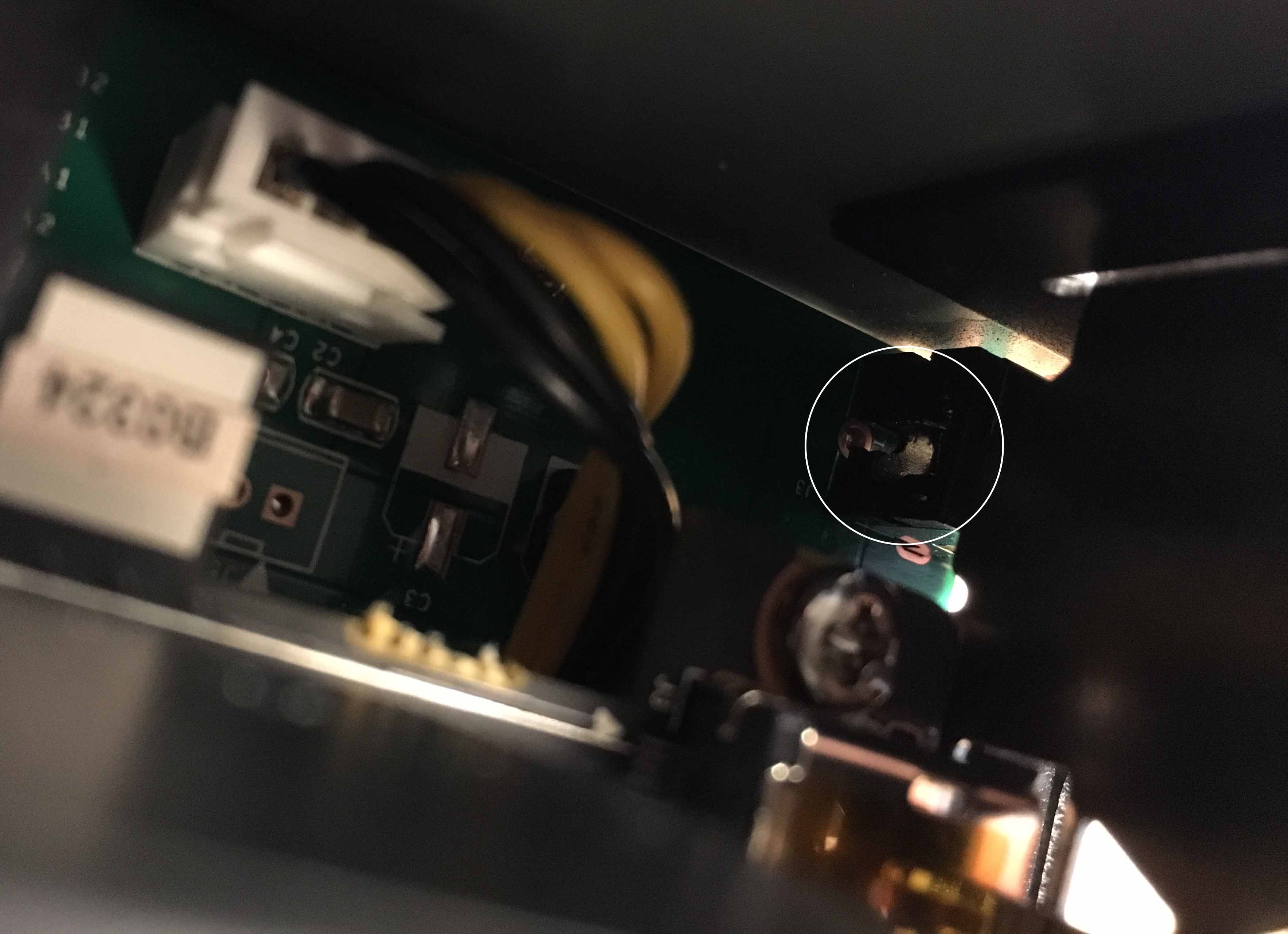

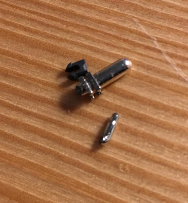

1366921 Posted November 25, 2016 Share Posted November 25, 2016 Hi, anybody can help me T-T Today, I received every component I bought from eBay and tried to set up my eGPU. I intended to power the Akitio and graphic card using the Dell DA-2. However, I didn't realize the barrel plug was not compatible and I pushed it so hard that the central part of the connector broke ....I have no idea how to power my Akitio in other ways and don't want to give up. Quote Link to comment Share on other sites More sharing options...
Dschijn Posted November 26, 2016 Share Posted November 26, 2016 You could directly solder cables to the PCB... Quote Link to comment Share on other sites More sharing options...

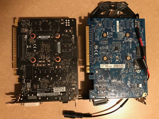

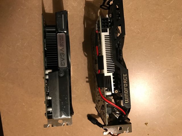

HutsonTech Posted December 4, 2016 Share Posted December 4, 2016 I have successfully built an eGPU using this box and a GTX 750ti. I used a female barrel plug to a positive and negative cables. I was able to solder the cables to the back side of the 750ti gpu of the 6pin PCI-e plug. This was a successful. Now I purchased a GTX 1050ti and it is lacking the 6pin PCI-e plug; however, it does have the holes. My question is, could I solder the two cables there again or are they not connected throughout? Thanks. Quote Link to comment Share on other sites More sharing options...
