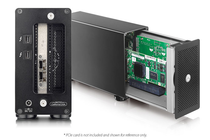

juniordiscart 33 Posted July 7, 2014 Although the device is advertised as Thunderbolt 2, the specs indicate that the device is limited to only 5Gbps, which is only have the performance of Thunderbolt 1. So I think you're better off bying a Sonnet Echo Express with e BPlus adapter or something similar. The advertising is correct - "PCI Express 2.0 compliant interface at 5.0Gbps" refers to a Gen2 single lane. The Akitio device is truly a Thunderbolt 2 product. B&H listing it at US$201, REF: Akitio THUNDER2PCIe BOX AK-T2PC-TIA B&H Photo Video . Meaning it price matches the US$199 Firmtek Thundertek Thunderbolt enclosure for value but gives Thunderbolt2 performance when attached to Thunderbolt2 notebooks. That makes it the best value Thunderbolt enclosure that can be adapted for eGPU use. Ah, ok. I misinterpreted that. Sorry for the confusion! That makes it a very interesting product then, indeed. I'm going to keep that on my watchlist. EDIT: And what about the powersupply? :/ The PCIe (x16) slot accepts half-length, full-height, double-width cards and provides a maximum of 25W. Quote Share this post Link to post Share on other sites
arclord 28 Posted July 8, 2014 Ah, ok. I misinterpreted that. Sorry for the confusion! That makes it a very interesting product then, indeed. I'm going to keep that on my watchlist. EDIT: And what about the powersupply? :/ Let's hope that the 25W power limit can be overcome by changing the supply adapter to another with higher A. Quote Share this post Link to post Share on other sites
arclord 28 Posted July 8, 2014 The advertising is correct - "PCI Express 2.0 compliant interface at 5.0Gbps" refers to a Gen2 single lane. The Akitio device is truly a Thunderbolt 2 product. B&H listing it at US$201, REF: Akitio THUNDER2PCIe BOX AK-T2PC-TIA B&H Photo Video . Meaning it price matches the US$199 Firmtek Thundertek Thunderbolt enclosure for value but gives Thunderbolt2 performance when attached to Thunderbolt2 notebooks. That makes it the best value Thunderbolt enclosure that can be adapted for eGPU use.Do you think the Akitio Thunder2 PCIe Box can supply the 75W needed by the graphics card? The specs stated a maximum of 25W. Quote Share this post Link to post Share on other sites
Tech Inferno Fan 20 Posted July 8, 2014 Do you think the Akitio Thunder2 PCIe Box can supply the 75W needed by the graphics card? The specs stated a maximum of 25W. It says maximum 25W, yet provides a 12V/5A DC PSU (60W). Is it fused? Go figure. "Supports half-length, full-height and double-width cards" makes me wonder, can it support a full length card without the chassis lid on? It does have a x16 slot. If not, then other than for GTX750Ti or mini ITX GTX670/760 you'd be using a PCIe riser to extend outside the chassis to get a full length card to work. A splitter with a 12V molex lead on it would solve the slot power issue. Sintech.cn makes some pretty good PCIe extenders: Sintech PCI-e express 16X Riser Extender cable | eBay <A HREF="http://www.ebay.com/sch/i.html?_nkw=Sintech+PCI-e+express+16X+Riser+Extender+-1x+-15cm+-15cms&_sacat=0"></A> 3 Quote Share this post Link to post Share on other sites
arclord 28 Posted July 10, 2014 It says maximum 25W, yet provides a 12V/5A DC PSU (60W). Is it fused? Go figure. "Supports half-length, full-height and double-width cards" makes me wonder, can it support a full length card without the chassis lid on? It does have a x16 slot.If not, then other than for GTX750Ti or mini ITX GTX670/760 you'd be using a PCIe riser to extend outside the chassis to get a full length card to work. A splitter with a 12V molex lead on it would solve the slot power issue. Sintech.cn makes some pretty good PCIe extenders: Sintech PCI-e express 16X Riser Extender cable | eBayI have placed an order for the Akitio Thunder2 PCIe Box. It will take a while before I get it since it is going through a forwarder. Quote Share this post Link to post Share on other sites

Sachin10 17 Posted July 14, 2014 It says maximum 25W, yet provides a 12V/5A DC PSU (60W). Is it fused? Go figure. "Supports half-length, full-height and double-width cards" makes me wonder, can it support a full length card without the chassis lid on? It does have a x16 slot.If not, then other than for GTX750Ti or mini ITX GTX670/760 you'd be using a PCIe riser to extend outside the chassis to get a full length card to work. A splitter with a 12V molex lead on it would solve the slot power issue. Sintech.cn makes some pretty good PCIe extenders: Sintech PCI-e express 16X Riser Extender cable | eBayLooks like a fantastic products but I'm afraid that even a GTX 750 Ti will not fit (length should be good but height is probably a problem because of the PCIe power cable that you need to add). Quote Share this post Link to post Share on other sites
arclord 28 Posted July 15, 2014 Looks like a fantastic products but I'm afraid that even a GTX 750 Ti will not fit (length should be good but height is probably a problem because of the PCIe power cable that you need to add).Most of the GTX 750 Ti cards do not require additional power from the PCIe power cable.- - - Updated - - -The advertising is correct - "PCI Express 2.0 compliant interface at 5.0Gbps" refers to a Gen2 single lane. The Akitio device is truly a Thunderbolt 2 product. B&H listing it at US$201, REF: Akitio THUNDER2PCIe BOX AK-T2PC-TIA B&H Photo Video . Meaning it price matches the US$199 Firmtek Thundertek Thunderbolt enclosure for value but gives Thunderbolt2 performance when attached to Thunderbolt2 notebooks. That makes it the best value Thunderbolt enclosure that can be adapted for eGPU use.The MSRP for the Thunder2 PCIe Box is $269.99. It comes with a thunderbolt cable though. Quote Share this post Link to post Share on other sites
Sachin10 17 Posted July 15, 2014 Most of the GTX 750 Ti cards do not require additional power from the PCIe power cable. Yes but the GTX 750 Ti normaly needs 75 Watt from the PCIe slot. But this device has apperently only a 60 Watt PSU to power the Thunderbolt hardware and the PCIe slot. Time will telll I guess. But even if you add a PCIe extender cable with molex connector for power you propably would still be able to fit a low profile GTX 750 Ti inside the chasis. Galaxy’s GTX 750 Ti GC Slim (low profile) PCIe Express x16 Riser Card Flexible Extender Cable w/Molex Connector (example) Quote Share this post Link to post Share on other sites

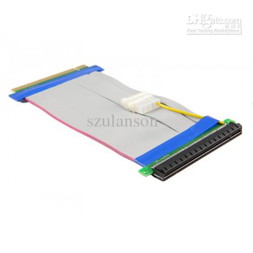

juniordiscart 33 Posted July 15, 2014 I am wondering why does PCIe slot in the card requires power? The graphics card itself is powered by 6/8 pins from the PSU, but I have seen 16x risers with Molex power too!According to the specs of the Akitio Thunder2PCIe Box, the slot only provides 25Watt of power. A normal PCIe slot, on say a traditional motherboard with CPU, delivers 75watt of base power. So to fully power a GFX card in the Akitio, an additional power source should be connected to the PCIe slot: the molex connector. I doubt that delivering that extra 50 watt through the 6pin and 8pin connectors instead of the molex will work. Quote Share this post Link to post Share on other sites
dj_khalsa 15 Posted July 15, 2014 According to the specs of the Akitio Thunder2PCIe Box, the slot only provides 25Watt of power. A normal PCIe slot, on say a traditional motherboard with CPU, delivers 75watt of base power. So to fully power a GFX card in the Akitio, an additional power source should be connected to the PCIe slot: the molex connector. I doubt that delivering that extra 50 watt through the 6pin and 8pin connectors instead of the molex will work.My GPU (GTX 680) requires ~ 250 W. I am not talking about the power it gets via 6/8 pins from the PSU. I am talking about the power required at the base (PCIe Slot of the card). Implementing eGPU with PE4L did not have such requirements. For it, I just powered the PE4L board (does that provided the power to PCIe slots of the GPU?) Quote Share this post Link to post Share on other sites

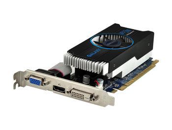

arclord 28 Posted July 16, 2014 Yes but the GTX 750 Ti normaly needs 75 Watt from the PCIe slot. But this device has apperently only a 60 Watt PSU to power the Thunderbolt hardware and the PCIe slot. Time will telll I guess. But even if you add a PCIe extender cable with molex connector for power you propably would still be able to fit a low profile GTX 750 Ti inside the chasis.I am hoping that a change to a DC 12V/7A (84W) power adapter would work. Will it damage the Thunder2 PCIe Box? I don't know... Quote Share this post Link to post Share on other sites
JWalk325 10 Posted July 16, 2014 Yes but the GTX 750 Ti normaly needs 75 Watt from the PCIe slot. But this device has apperently only a 60 Watt PSU to power the Thunderbolt hardware and the PCIe slot. Time will telll I guess. But even if you add a PCIe extender cable with molex connector for power you propably would still be able to fit a low profile GTX 750 Ti inside the chasis. I'd actually be interested in seeing how easily you could remove the board from the chassis and put it into a small ITX case that would support a full size ATX PSU and most modern GPUs. And it would also look a lot cleaner than leaving it lying around. I was considering this ITX case. It fits full-size graphics cards up to 343mm/13.5 inches in length and has a nice cooling system. Wondering if maybe the power button can be wired to the PSU, but if not could just use the paperclip method and use a PSU with a switch. It's also nice to see there is a dedicated grommet for wiring. For $45 bucks seems like a nice way to clean up a setup. Quote Share this post Link to post Share on other sites
