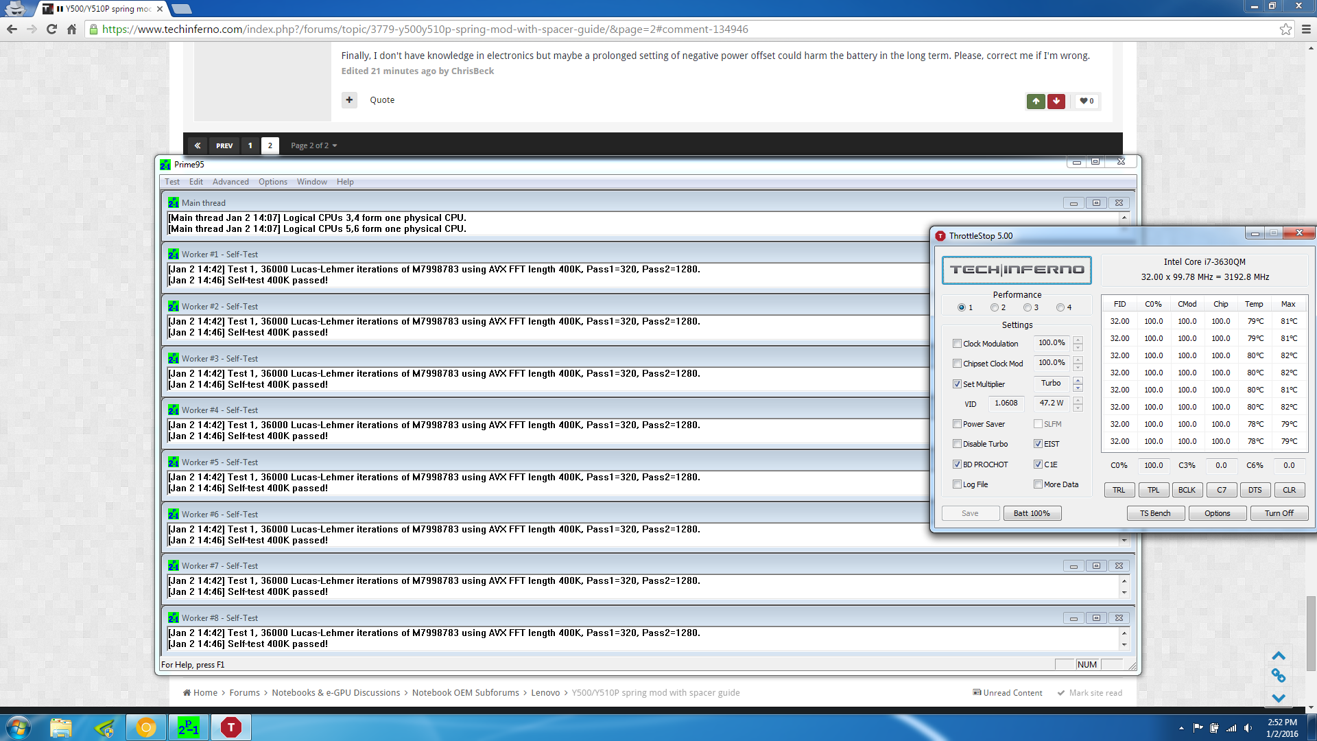

BTW I was running my 650M SLI @ 1150/1125 and 1.05V, CPU was stock speed 3.2x4 (3630QM is locked) but with TDP increased to 56W in ThrottleStop, although even in Prime95x8 threads it only reaches 47W which is barely more than the stock 45W. I observed the battery drain in TSBench/Prime95+Heaven/Valley and even in CPU&GPU intensive games like Battlefield series, particularly since my screen has also been OCed to 120Hz so the increased frame rate increases CPU usage. Although the battery drain is very slow, Prime95+Heaven overnight for 8 hours only consumed 50%.

I increased CPU TDP because 45W is too low to maintain full Turbo Boost (3.2 GHz for the 3630QM) in Prime95 8 threads. It would drop down to ~3GHz after a little bit to stay under 45W. It actually doesn't get that hot. Ivy Bridge runs cooler than Haswell, but to be fair Haswell has FIVR and can consume a lot more power due to AVX2. And I also repasted with CLU and cut the chassis to increase air intake. This is after 45 min Prime95 small/large FFTs 8 threads:
About the same temps while gaming. I can only make CPU break 90C if I simultaneously load GPUs and back Prime95 down to 4 threads (since 8 threads would bottleneck GPU hence reduce GPU usage and heat).
