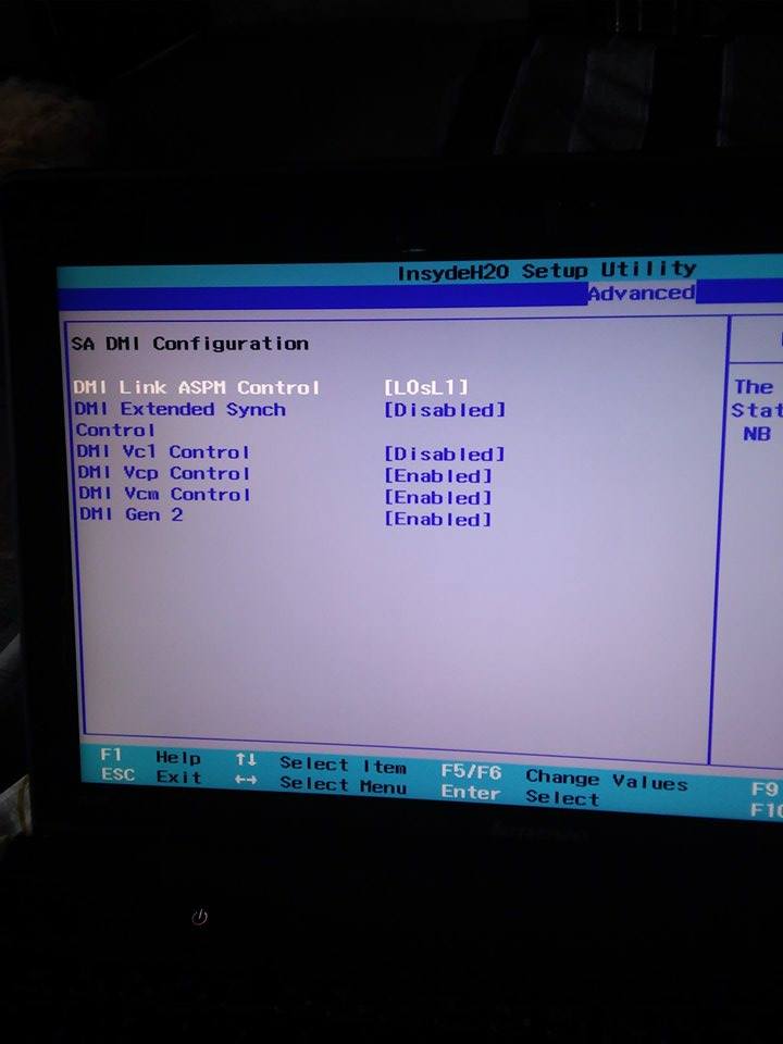

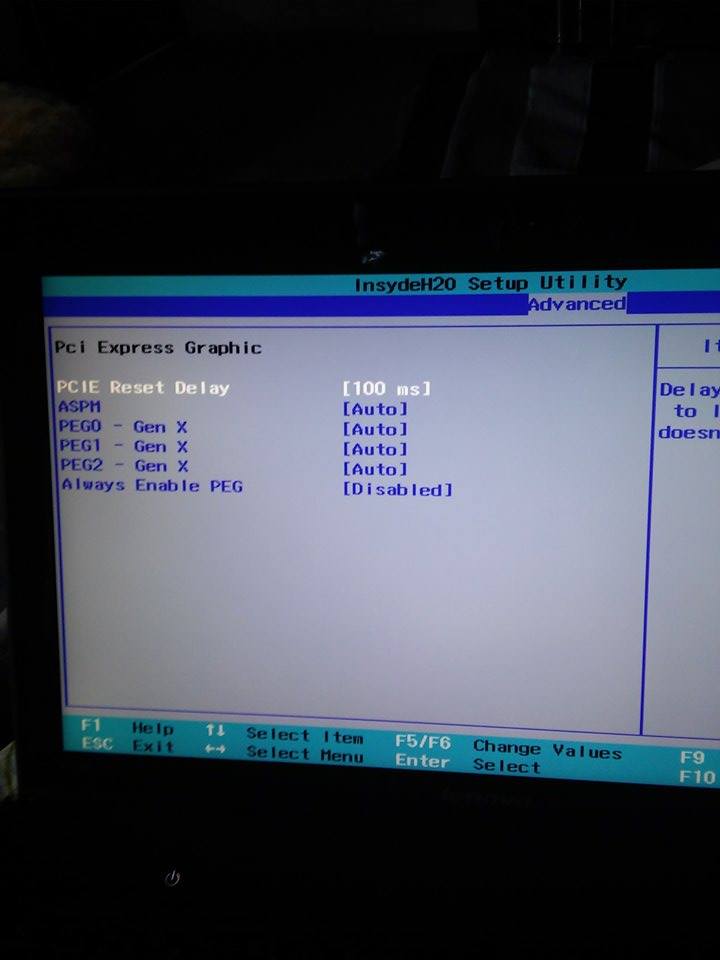

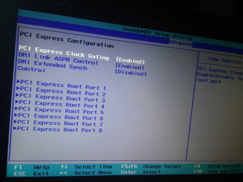

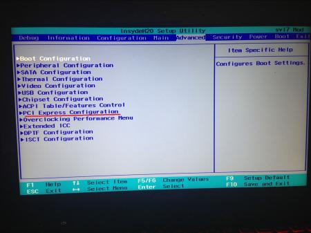

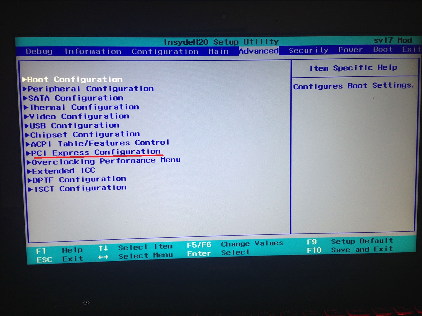

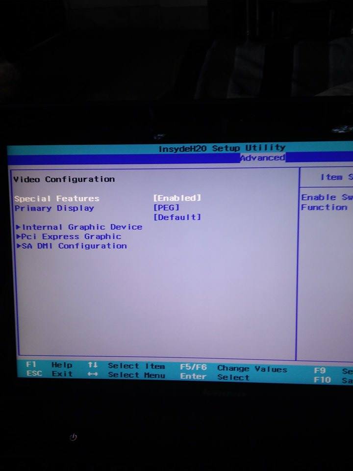

I was wondering if disabling a PCI-e slot will disable the Ultrabay graphics card while its plugged in, any brave soul having the SLI setup willing to test? :D

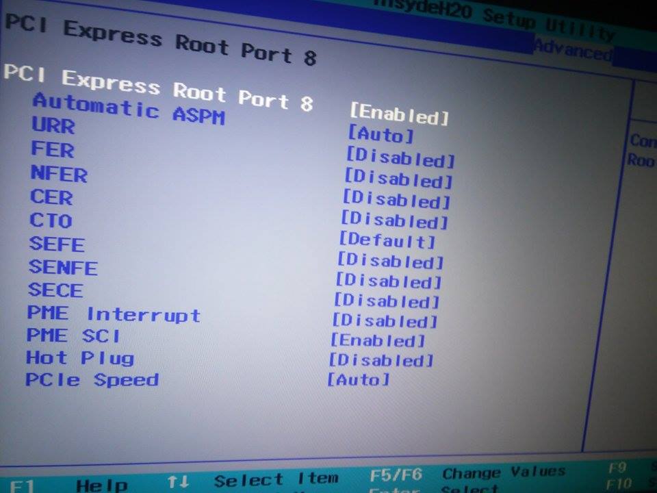

P.S: All the PCI-e root ports have the same settings as port 8, btw I would have tried but I'm not in the US and I still have warranty. @allstone share your thoughts.
[ATTACH=CONFIG]14231[/ATTACH][ATTACH=CONFIG]14232[/ATTACH][ATTACH=CONFIG]14233[/ATTACH]
Why would you want to disable the Ultraybay graphics? To enable the Intel? So you can boot OS X? Hmm, I might be game. Anyone know how to reset the BIOS settings in case this fucks up? I don't really care if I have to cut, solder, or buy a programmer (up to maybe $50? I mean, how much is this knowledge really worth) and overwrite the BIOS settings that way. I mean, I depend on this machine, but it can be out of commission for a few days.
I read some pages back if you short the CMOS pins (two pins) on the mainboard, the BIOS is reset. I'm not sure though please search this thread. (pages after 120)
I read every page of this post, and remember something like that. However, I also remember it wasn't definitive and/or the poster never returned to confirm if my memory serves me right. I won't take the chance unless someone confirms directly a method for BIOS reset or I have the time to pull apart the machine and find out for myself.

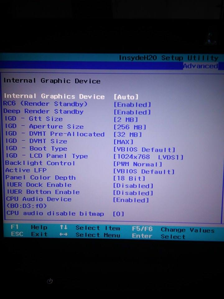

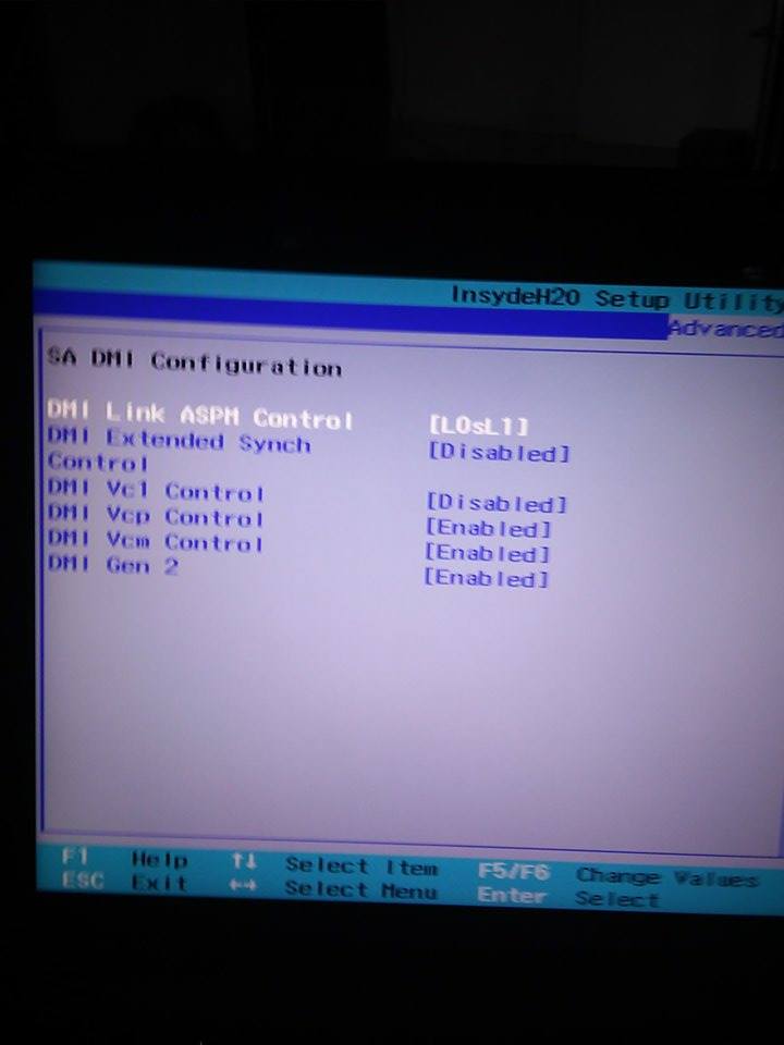

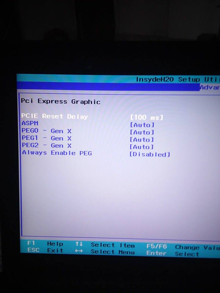

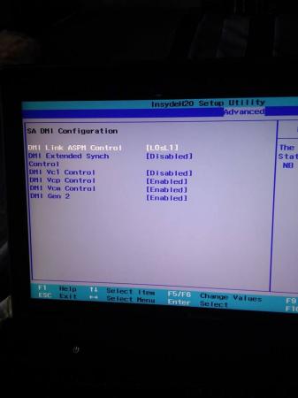

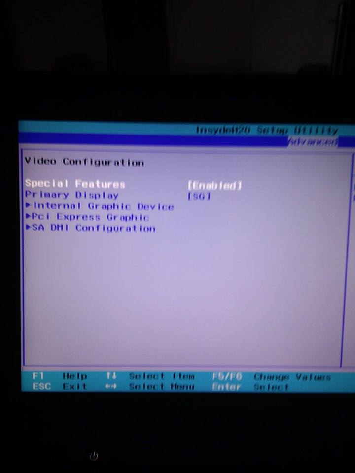

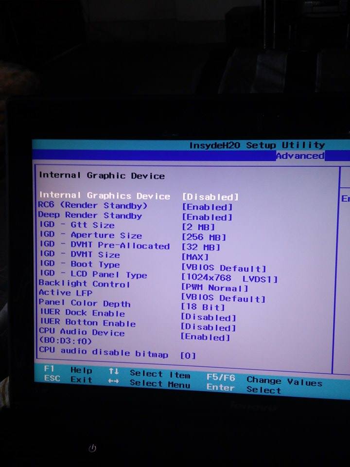

These are the settings which are automatically configured when Ultrabay is removed i.e iGPU enabled.
And with SLI enabled:
@svl7 @allstone shed your thoughts too.
