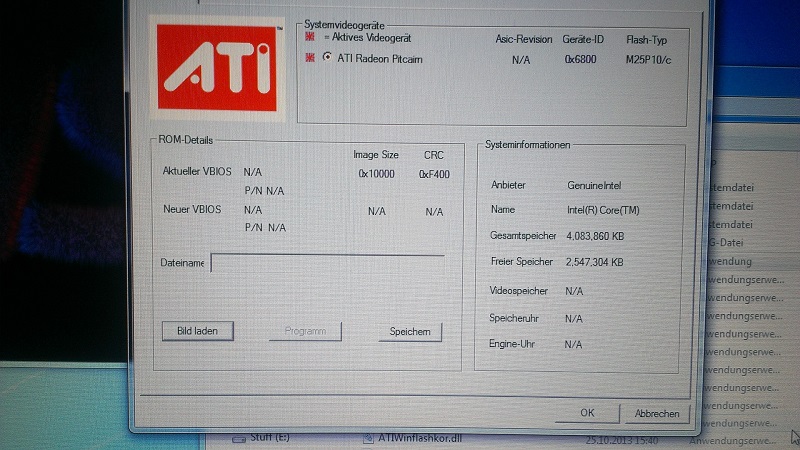

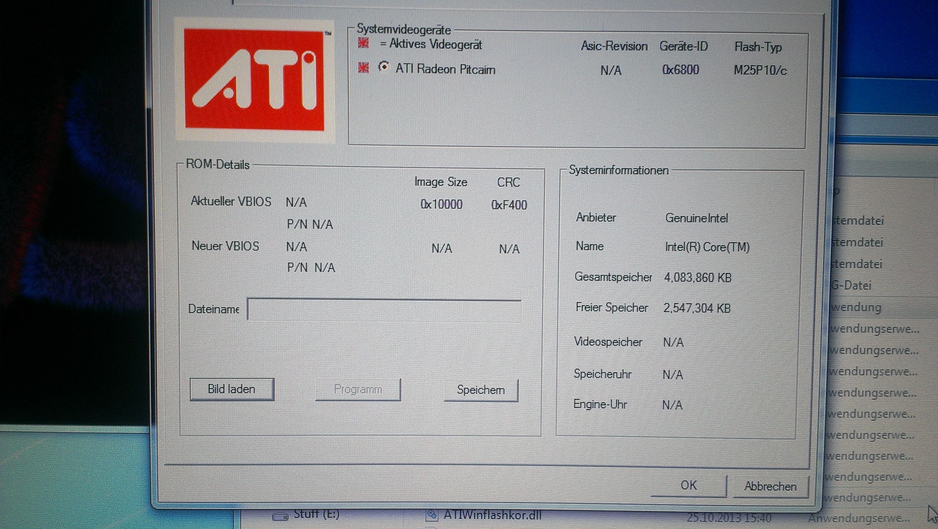

Sorry, i can not See the Pictures in the Startpost, because of no permission. Is it correct that atiwinflash only Shows N/A at BIOS version? I think it doesnt read the right values from my 150em.
