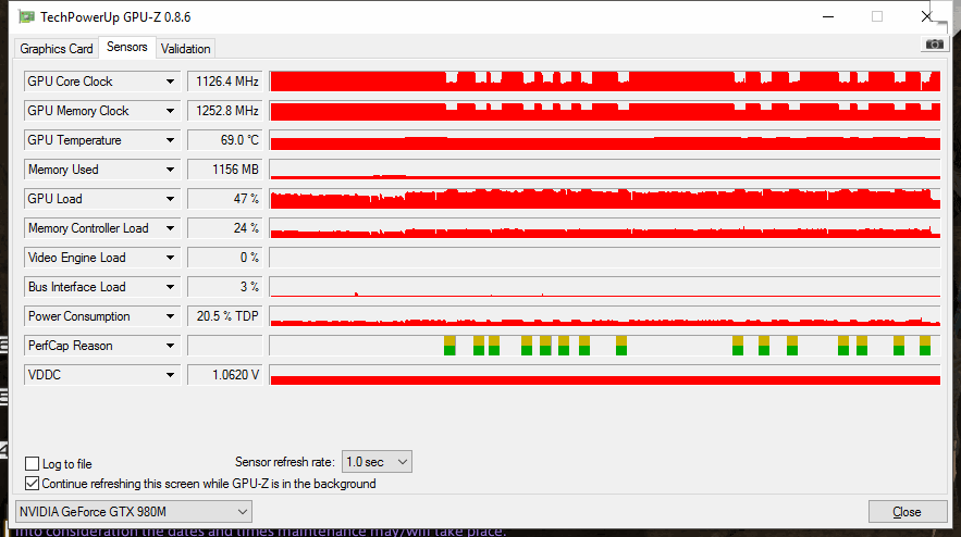

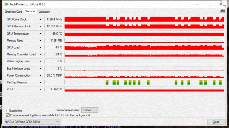

Flashed the new version onto my own cards as well. Fans work fine on M18Xr2 and voltages are nearly identical in both cards but I still get that inconsistent throttling down to 800 memory clock for a few seconds on FFXIV in certain areas (shows power/sli in GPU-Z but I dont see anything on it thats causing it to trigger, Im assuming this is a bug with DX11 in the game with this laptop configuration) . Has to be something with the drivers themselves as its wasnt throttling on 8.1 with 350.12 under the same conditions :/

j95 posted up mods. Installed the latest drivers. Good news: They look like theyre working. Bad news: Still got that DX11 intermittent throttle in certain locations of FFXIV :C
I put on nvidia inspector and watched it in the rising stones area of FFXIV with no FPS cap as this triggers it. Its dropping to P1 for whatever reason. Dunno how to stop this happening or whats triggering it :s Below SS is what im getting with the FPS on DX11 unlocked and in certain areas (Aetherite Plaza in Upper La Nocsea an example).

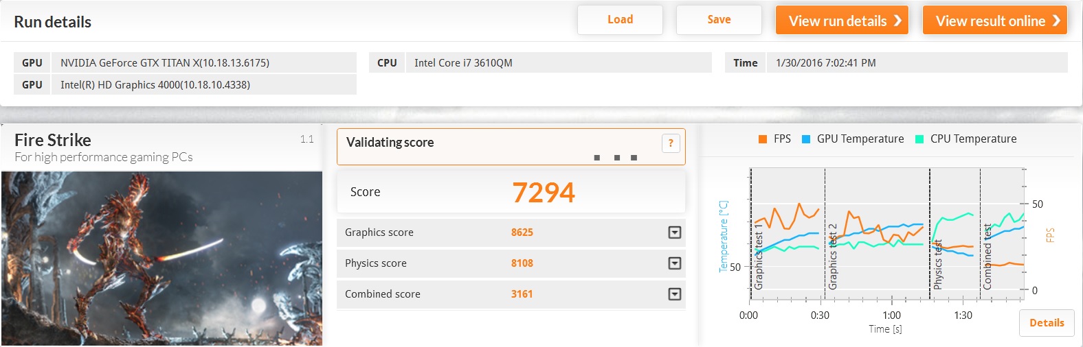

Hello - I have one small problem after flashing my GTX970m with v2 bios.
I can't change Vsync - it is locked at 60Hz = 60fps max in all DX11 games and programs.
After flashing Vbios I just tried to check 3dmark score but i can see max 60fps and score is low. I found one thing - all DX9 programs and games run great and lot of more than 60fps, but only DX11 games and programs are limited to 60fps. If I use windowed mode DX11 run normal again (more than 60fps). For example - I checked Heaven Benchmark full screen - locked at 60fps but windowed mode run great again much faster.
 Of course I set Vsync OFF in nvidia panel for 3dmark or for global settings. I tried google this problem. Only thing I found was something about Xbox and disable recording - I tried - no help.
PS. I have windows 10.

Because of the system BIOS: On M18xR2 you have to use NVIDIA Inspector to match P1-States vRAM clocks with the ones in P0, if you don't OC that would be 2505Mhz.

Ok guys I found some solution for my locked Vsync problem.
At first I google a lot. Lots of people have problem like me with locked Vsync but mostly in windowed mode.
I have problem only in full screen mode and only in 3d games and programs using DX11 (DX9 full screen and window mode at full speed 60fps+).
I tried:
1 - disable Xbox streaming (Xbox -> Settings -> Disable Game DVR - it can lock fps at 60)
2 - disable nvidia battery boost (it can lock fps from 30-60)
3 - disable Vsync in NV panel and in NV inspector
4 - disable Frame Limiter in NV inspector
5 - tried few NV drivers
Only thing I found was - full screen DX11 is 60fps lock only - windowed mode - full speed.
Some people wrote to try ---- run app or game and press alt+tab and back to app or game.
So I try Heaven benchmark - full screen locked at 60fps in DX11, then I pressed Alt+Tab and again back to Heaven.................WOW - full screen 200+ fps and no broken Vsync.
