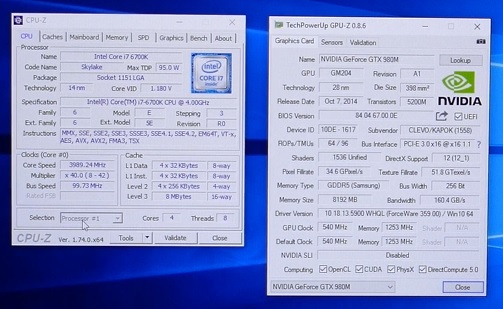

i realized that vbios of this gtx980m gysnc model starts throttling when gpu temp reaches 72C just like my older msi gt72 2qe..i ve been using prema custom vbios for msi nearly 1 year..but i see in the first post for vbios of my new model this --> "P77xDM-G (soon)"  :23_002:
but on your official page i see you already made it ( https://biosmods.wordpress.com/gtx9-g/ )
Prema..if you need that original or stock vbios file i can send you mine..
or should i download this one  " CLEVO_8GB_GTX980M-G_DM_OC_PM_v1.1.1from your official page  ?
