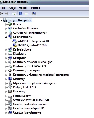

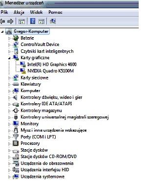

@svl7 Unfortunately with your bios I can`t install drivers I have : Btw could you unlock my posted bios ?
@svl7 80.04.AE.00.04 (P2053-0503). In my dell precision I have installed dell vga card but probably with hp customized bios and for example there is problem to turn off optiomus in bios - No display. Thats why I am searching oryginal dell bios for k5100m.
