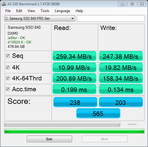

will definitely agree with R1 is not ssd friendly with the A08 bios version because of the sata speeds restricting to 2 and my seagate constantly BSOD's. i haven't tried the modded A08 version yet and am praying that this will be the cure to my blue screens.

I know alot of people that said 16gb works, but really 8 is as much as you need. The performance is bottle-necked by the gpu anyways. As for the HDD to SSD, highly recommend, just make sure your bios is either A05 or a modded A08 with the sata fix, since the regular a08 from dell/alienware limits the sata speed to sata 2. If you dont need your optical drive either, try getting a caddy to replace it with your old hdd and put the new ssd where the original hard drive was. This way you'll have your os and important apps on the ssd, and media on the hdd, since higher capacity ssds can be pretty pricey
