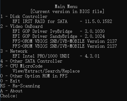

That's great. I am very happy that this is helpful to you. You mean IntelIvbGop and IntelS nbGop drivers?I replaced the new driver with the UBU tool(UBU_v1.71.1).
