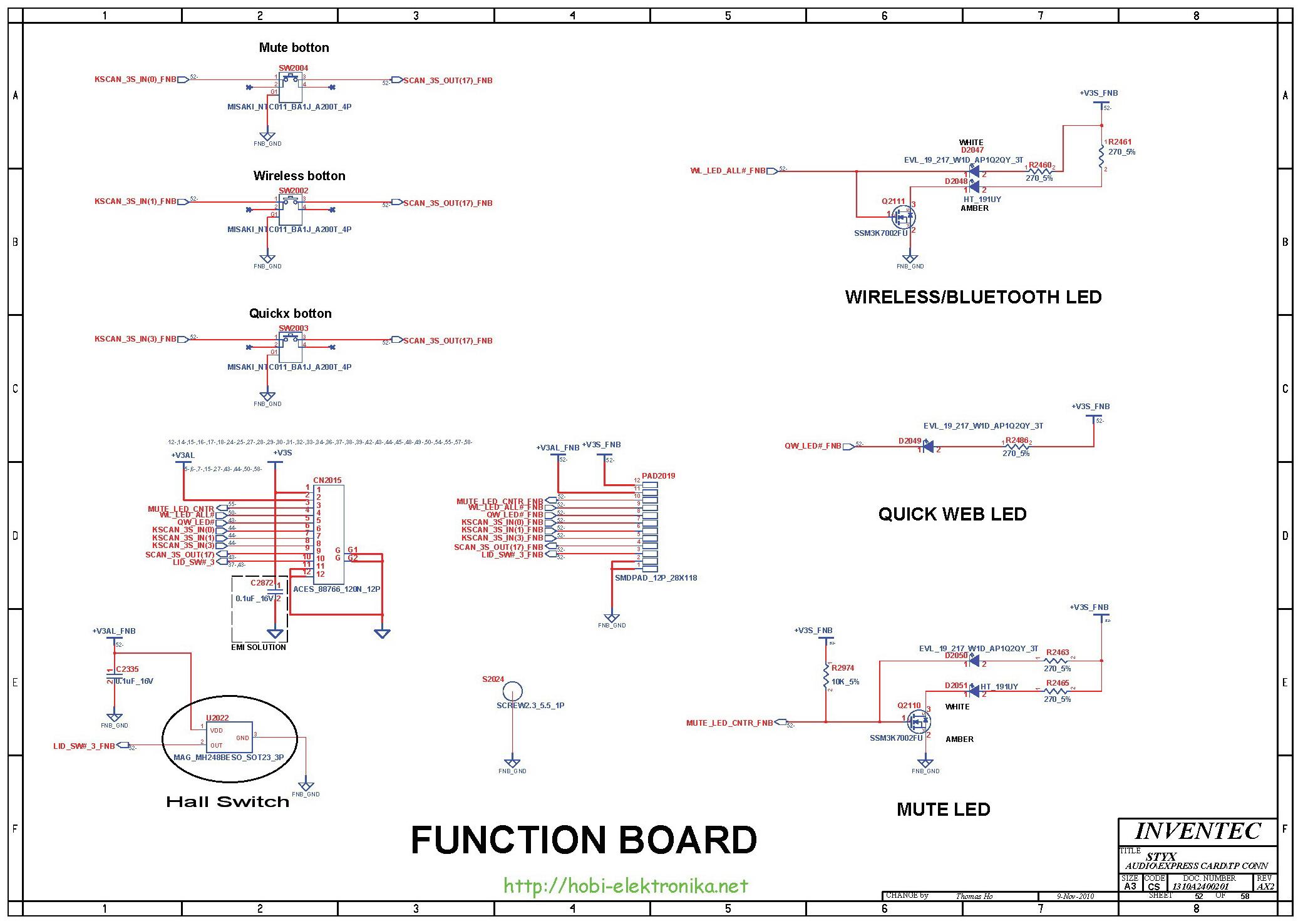

invait53 replied to Tech Inferno Fan's topic in HP Business Class Notebooks
That magnet sensor (Hall Switch) isn't on the motherboard. It is on the function board with Mute botton, Wireless botton, Quickx botton, leds. There is 3.3v on LID_SW#_3_FNB if the lid is open.- 1884 replies

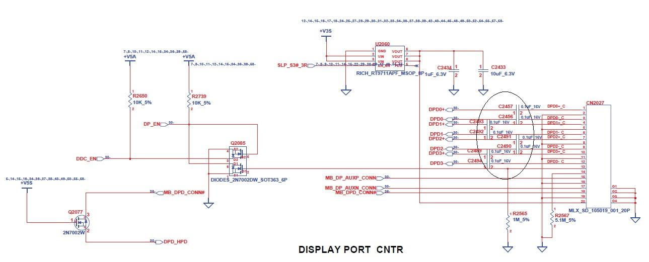

Thanks for advise but my SSD is Samsung and I use the program Samsung Magician with Rapid mode. I think it's the same functions. @adrian_sa, did you use for your mod capacities like in DisplayPort connector:- 1884 replies
