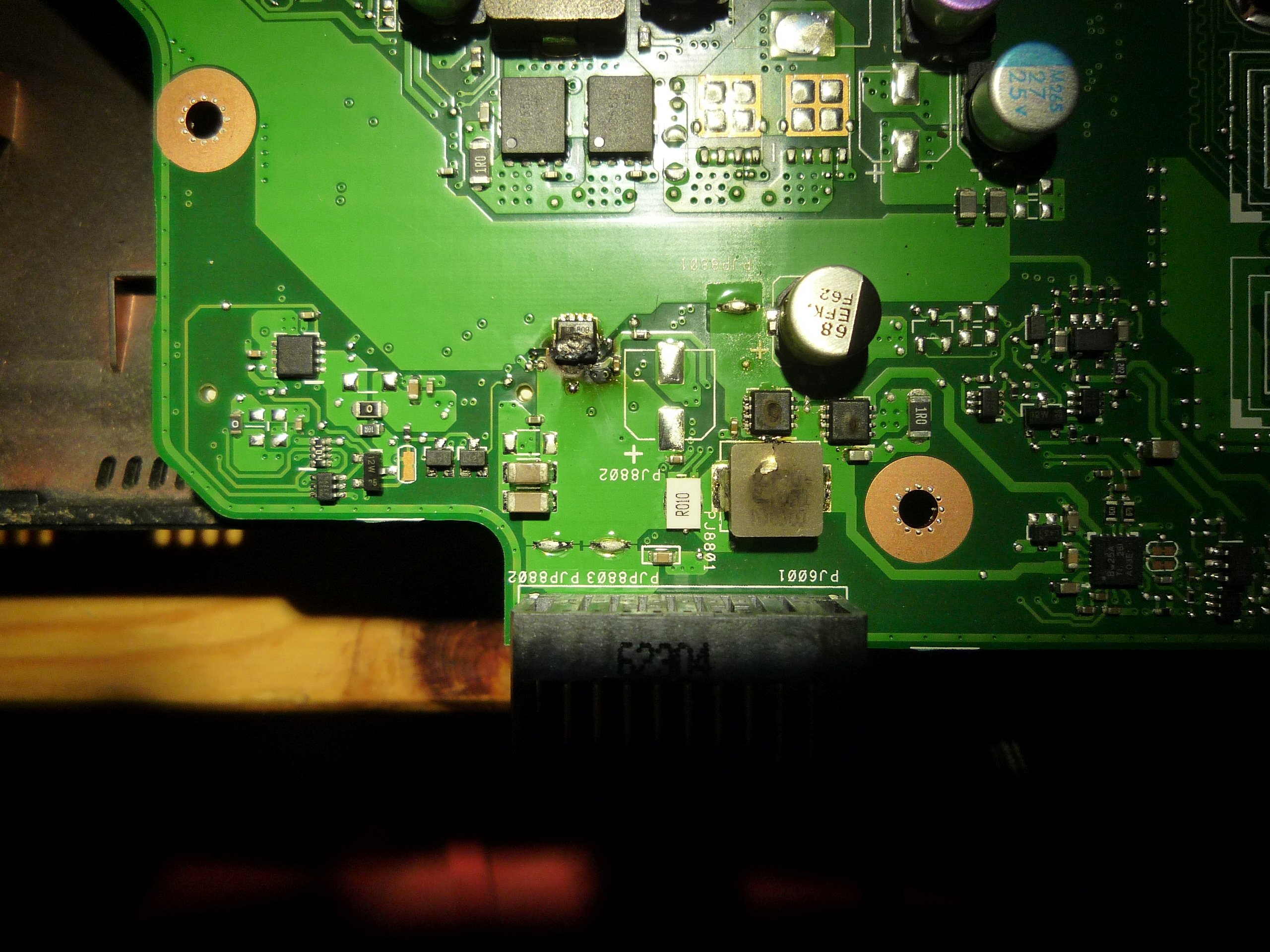

Hey, anyone actually tried the Ivy Bridge retrofit on 2560p? Does it work? -
Hi, one of my laptops went up in smoke some time ago. After disassembly found several components burned and now are impossible to identify. Could anyone with the same or similar model take pictures of this area here? Thanks!
