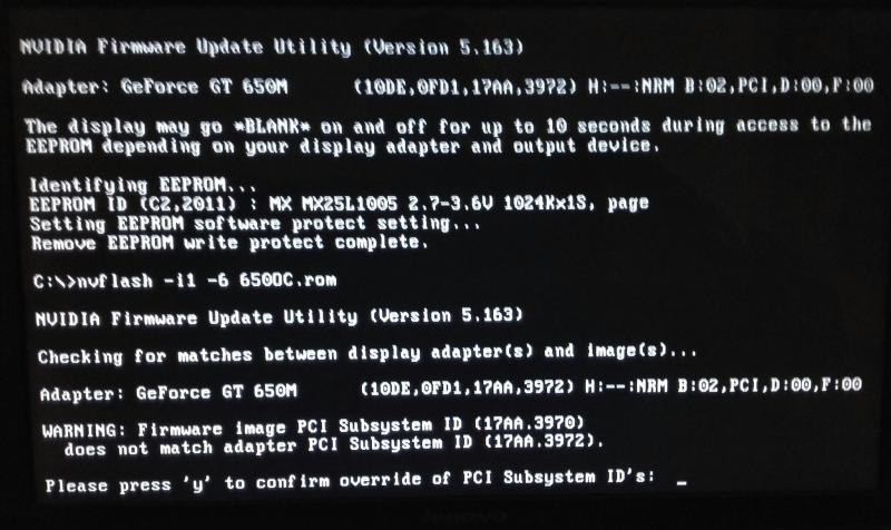

hey guys so i tried to flash my ultrabay 650m in my lenovo y500 with the files provided here:
i had to --protectoff to even get the process starting..
it ran through and it said the flash is completed..
i restartet and nvidiainspector doesnt recognize a modified bios nor does it let me get past the 135 limit.. everything seems to be the same.. what can i do??
something wrong with the pcie subsystem?
i have the modded 2.04. bios does this vbios only work when i have a modded 2.02 bios?
Edited by BigBuddha
