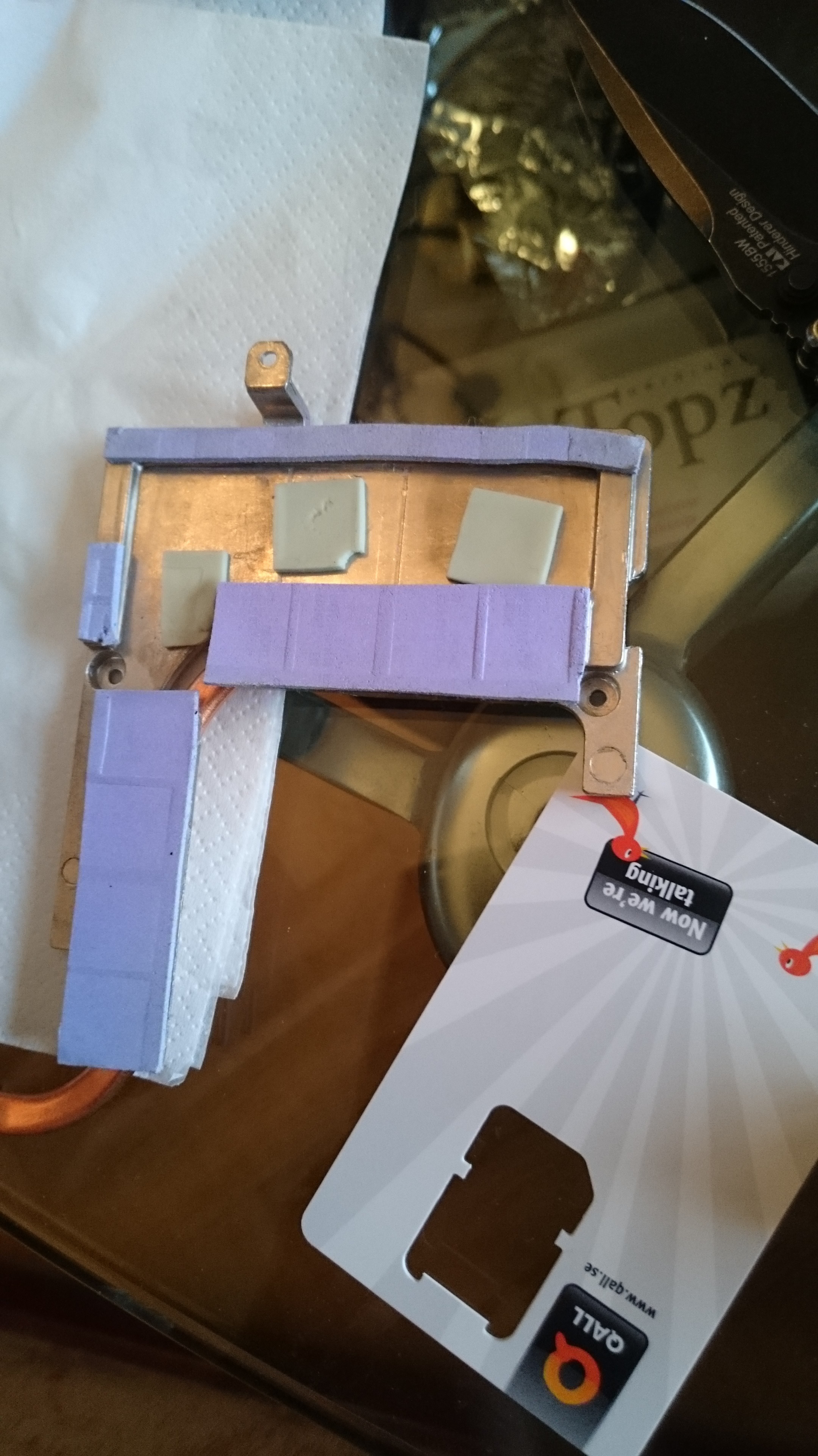

  8. Stacking thermal pads is not ideal. I'm going to use 1,5mm ARCTIC thermal pad, because it's not that brittle and I can repaste without braking the pad. I'll be installing 3mm+ on other side to cool the memory. Got the last tip from forum member. Picture with original pads will explain your R22 question.

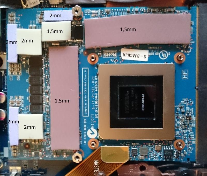

  9. 1,5mm on memory and 2mm on R22 should be correct. Original pads are strong and can be easily reused so you can measure it but make sure you put new thermal paste. This is what I measured on 680m in P370EM3

  11. That 1,5mm on top can't be right. It's more like 3,5mm if using 2mm on both sides.
