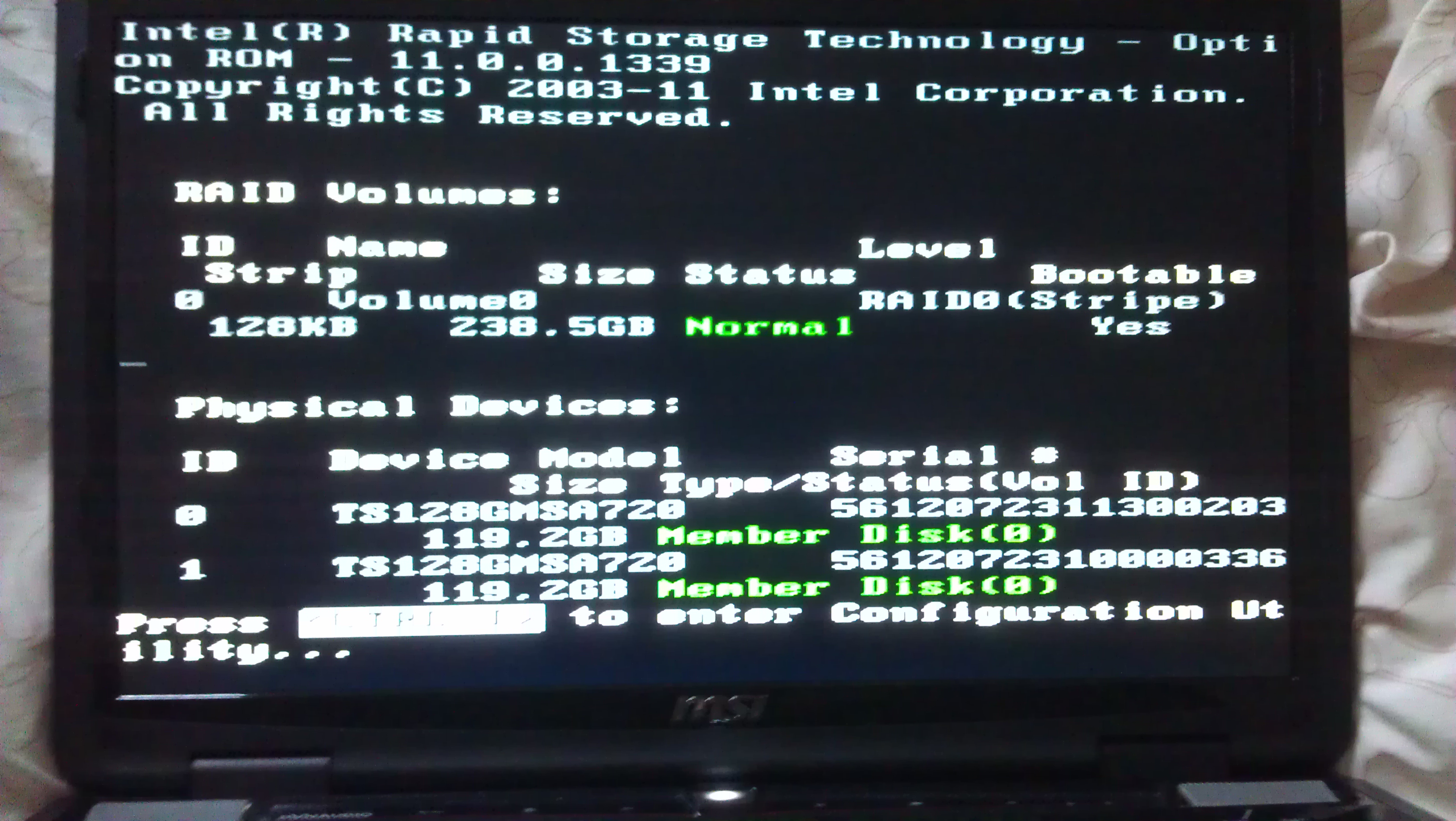

post-10635-14494994383618_thumb.jpgGuys please help me out .. I don't know what happened but after finally being able to get into Dos I nvflashed to Clevo 680m (80.04.33.00.10) 'OCedition' revised v01 rom(think thats where i fkd up sighh).ctrl alt deleted and restarted with usb unplugged and now it stuck at the screen with intel rapid storage with disk info thats it.. It won't boot past that!!
What did i do wrong? please help :( where do I go from here..?
svl7 please help me :( Im willing to donate to solve this problem just really want my pc back to how it was :/
If you can boot dos again, try flashing an MSI rom. Are you able to get to the bios? The idea is to boot dos again even if nothing comes on the screen and try to enter the commands blindly. You can download MSI roms from the second post or download the original MSI rom from here: http://www.techpowerup.com/vgabios/index.php?page=1&architecture=&manufacturer=&model=GTX+680M&interface=&memSize=0
If you can't boot dos, you might have to send you Notebook for repairs at the place where you bought it :(.
Very weird indeed I've searched everywhere for help.. when I attempt to boot without any HDD its just blank screen. I've been trying to blind flash but can't really tell(durr me its blind) i have the nvflash cwimd and the old backup along with that also the autoexec.bat. What I wrote in the auto exec is nvflash -6 new.rom. My next question is there anyway to tell if blind flash is working or loading?
