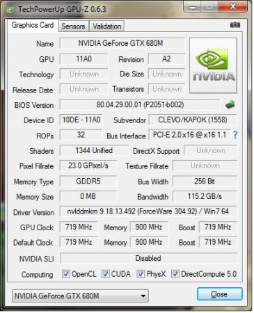

Tonrac Posted August 6, 2012 Share Posted August 6, 2012 Hi again ... like you know if you follow my thread, i successfully installed a GTX680M in a clevo P150HM (sager 8150 for US customers). I tried saltius vbios ... and vbioses based on msi board. But i have some strange behavior, all of them, randomly don't allow 3d clock. Even the non-OV version (MSI OC edition). So the original clevo bios work well, and the card is rock stable at 853/2400 ... But the OC is locked at +135Mhz ... Could you, please, made some modded bioses with the original clevo vbios like you did with msi and dell vbioses (OCedition ...)? Here is the original clevo vbios: https://hotfile.com/dl/165845735/dc4564e/Clevogtx680.zip.html And a Gpu-z screenshot like you requested : Thanks a lot ... I hope you will positively respond to my request All the best Quote Link to comment Share on other sites More sharing options...

Tonrac Posted August 7, 2012 Share Posted August 7, 2012 I have try 302.72, 302.77, 304.79 and 304.92 without success. It doesn't seem to be a driver related issue because the idle bug is not there with the clevo vbios. Quote Link to comment Share on other sites More sharing options...
