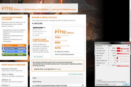

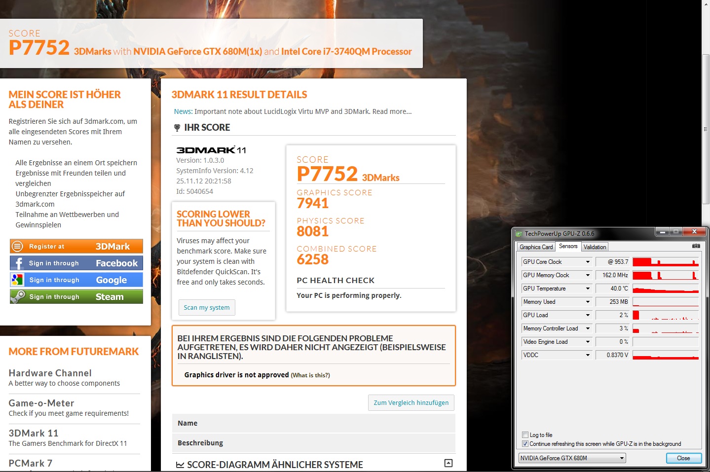

i got 7.7k with 950MHz GPU / 2200MHz Vram
