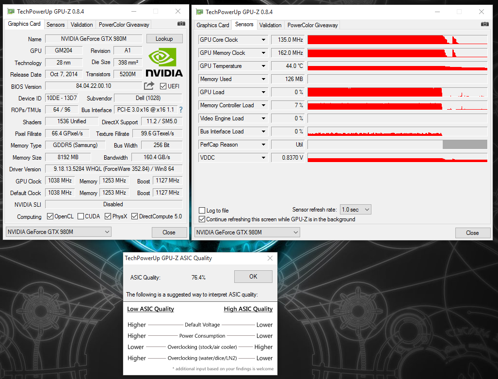

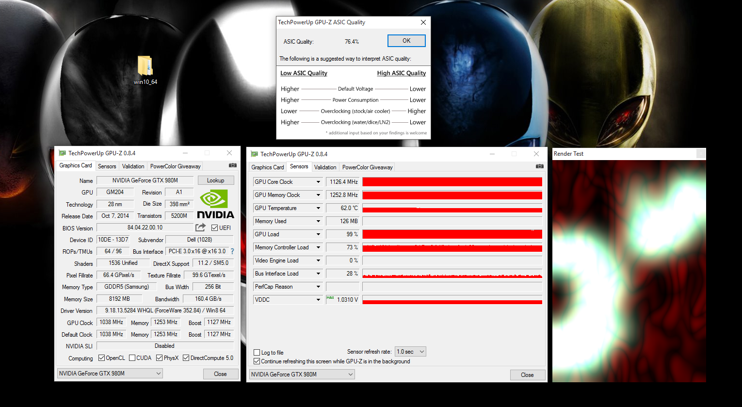

Don't know if you're still looking for these, I have a GTX 980m. Seeing an ASIC quality of 71.1% and a VDDC with the render test running for a few minutes of 1.0500 V.
Please set "MAX" VDDC reading and then take a screenshot of both ASIC & sensors readings.
@J95 , dont know if im doing it right, stock vbios with sli disable
[ATTACH=CONFIG]15531[/ATTACH]
*SLI Enabled* Try running 3dmark11 "Entry Level" for a few seconds to capture secondary GPU (ASIC 70.2%) VDDC reading.

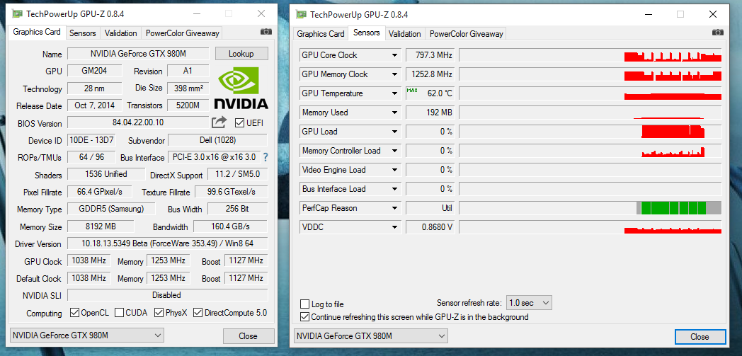

Installed 353.49 HF, here are the readings with Heaven benchmark 4.0 extreme.
Obviously, perfcap shows "PWR"
What I find strange is while doing the rendering test with 353.49 I have no throttling issues at all. The core + memory + GPU load = running @ 100%
As soon as I do a benchmark or game it throttles like a b****!!!
Also, when the core and memory speed throttles, GPU load goes up.

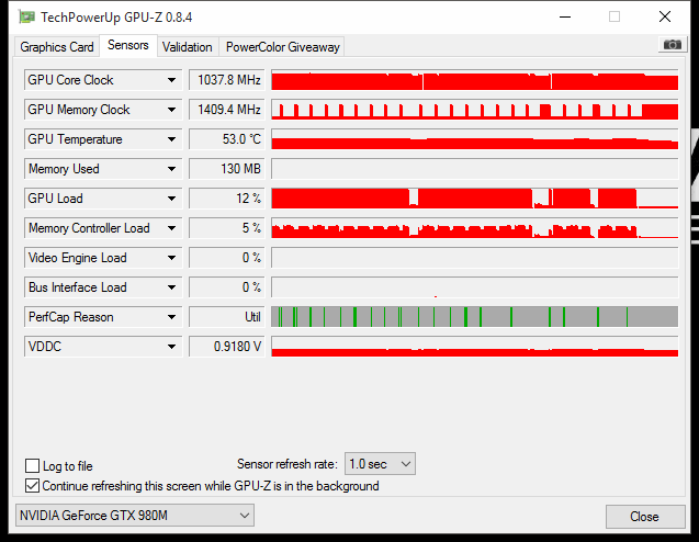

(353.84) strange throttling occurred while playing witcher 3. The core clock is running @ 100%
but the issue lies with the memory clock. If I switch back to the desktop (at idle) the memory returns to it's full speed as you can notice at the final seconds in the readings.
Also the voltage is supposed to be running @ 1.030v instead it's 0.9180v.

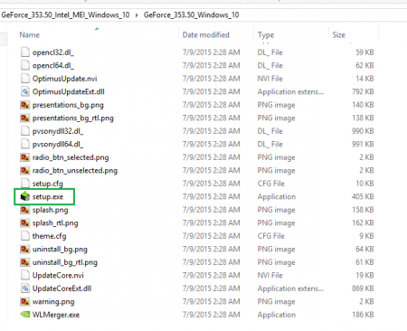

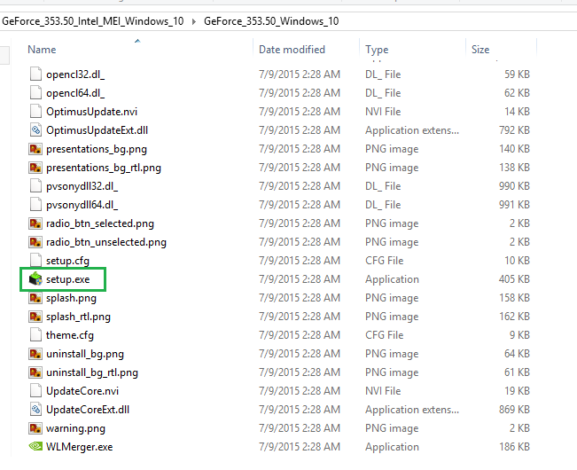

  • Extracted NV driver package -> copy/overwrite nvcvwu.inf -> run setup.exe
