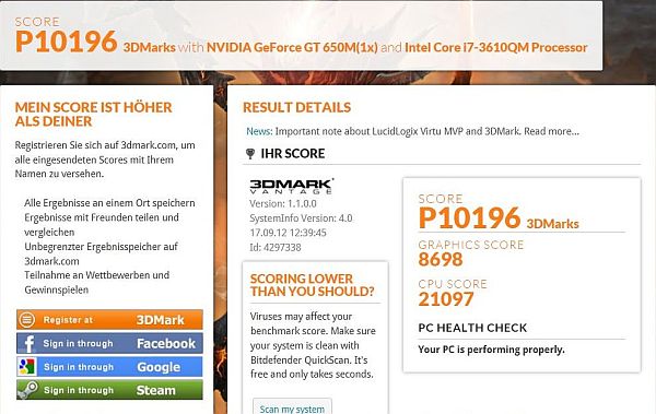

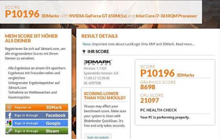

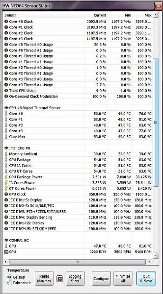

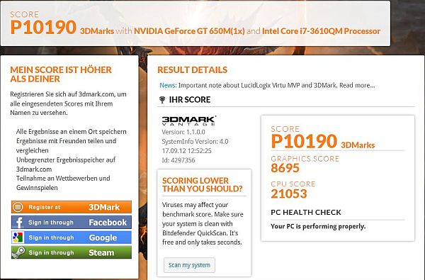

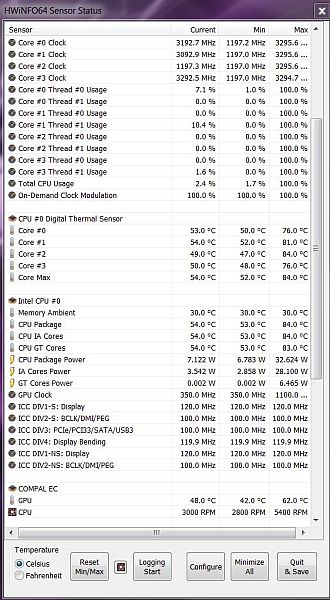

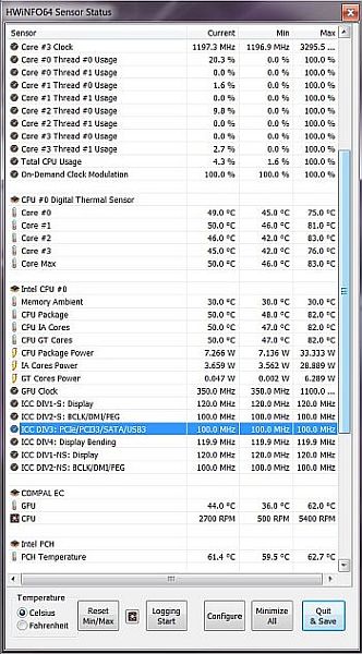

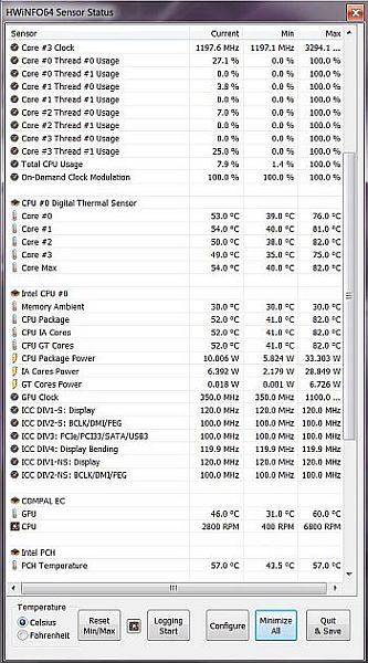

Here are my results:
CPU Overclocking enabled no setting changed. 45 Watt Long Duration Power Limit.
CPU Overclocking enabled. 35 Watt Long Duration Power Limit / Short Duration Power Limit disabled.
CPU Overclocking enabled. 30 Watt Long Duration Power Limit / Short Duration Power Limit disabled.
CPU Overclocking enabled. 10 Watt Long Duration Power Limit / Short Duration Power Limit disabled.
As you can it has no influence on anything at all. Any idea why that can be @mw86?
My suggestion is the settings are only for Overclocking but Downclocking doesnt work at all.
[ATTACH=CONFIG]4939[/ATTACH][ATTACH=CONFIG]4938[/ATTACH]
[ATTACH=CONFIG]4940[/ATTACH][ATTACH=CONFIG]4941[/ATTACH]
[ATTACH=CONFIG]4942[/ATTACH][ATTACH=CONFIG]4943[/ATTACH]
[ATTACH=CONFIG]4944[/ATTACH][ATTACH=CONFIG]4945[/ATTACH]
Okay I see your results and if the controls worked the watts shown in subsequent drops of watts whould have showed a lower max. Its as you say not applying as you had same max watts shown in each hwinfo screenshot.

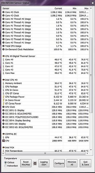

I tried to set Short and Long Duration Power Limit on default max of the Short Duration Power Limit. This has no effect also as you can see in my screen. Somehow its not possible to change anything even you can see the options. :(
The Guide doesnt help me since the changes seem to work with M14x R1. Im clueless what to do now. I guess it just dont work and i have to stick to disabling Turbo as only way to decrease temps.

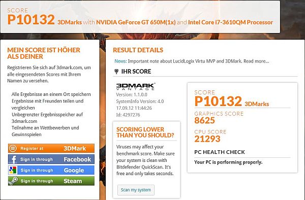

CPU Overclocking enabled. 56 Watt Long Duration Power Limit / 56 Watt Short Duration Power Limit enabled.
[ATTACH=CONFIG]4946[/ATTACH][ATTACH=CONFIG]4947[/ATTACH]
Do you have primary plane in your bios under advanced settings. That is equal to amperage limit. If you want to try, stock is 97amp and primary plane is divisible by 8 to give you amos. So stock is 97*8=stock primary plane (it may say 0 which is same as setting as default) so stock is 776.
If you set this really low like 200 does your cpu ramp up the same?
Forgive me for asking did you set the limits to lower values together not just 56watts? Anither thing is what did you attempt. Were you using bios only in a combo of bios and intel XTU, have you tried XTU. @Widezu has overclocked non xm maybe he can shed some light as these non xm arent completely locked.
Bios may need to have a larger or smaller value set or stock and adjust from XTU its hard to say. I hope Widezu can shed some light on this. Ivy should be adjustable as Sandy was on non xm. Strange R1handles so different than R2.
Hey sry for the delay. I gave up on lowering the Watts on the R2. There is no amperage control in the advanced BIOS options. I disabled short duration and changed long duration in my tests. Seems no change in these settings do anything at all. About XTU im not going to try this since i only wanted to do it by BIOS options. Thanks for all the attempts @mw86 but i guess if not someone genius can manage to lower it by some trick in the BIOS it wont work at all.
Too bad this would have been another way to lower the temps.
