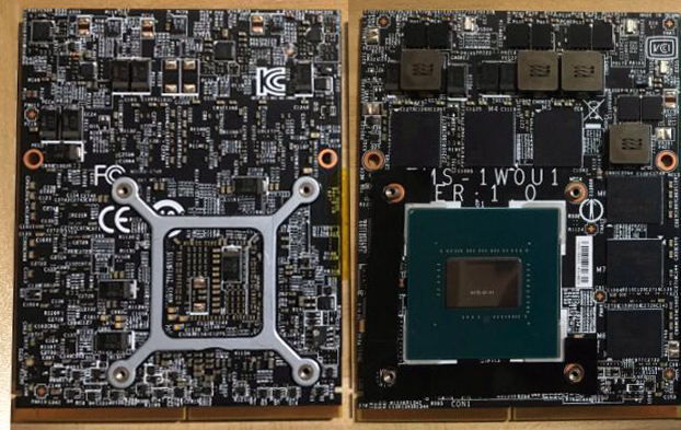

Khenglish Posted September 15, 2016 Share Posted September 15, 2016 (edited) @Prema do you have any pictures of the 1060? Looking at the desktop cards, the BGA seems to match the 1070. The desktop boards even have the 2 missing memory chips, knocking the bus down to 192-bit. If the 1060 mobile pcb also has the missing memory chips... could be a fun mod assuming the pcb is smaller to fit in a regularly mxm slot. Edited September 15, 2016 by Khenglish 2 Quote Link to comment Share on other sites More sharing options...
Guest Posted September 15, 2016 Share Posted September 15, 2016 @Prema do you have any pictures of the 1060? Looking at the desktop cards, the BGA seems to match the 1070. The desktop boards even have the 2 missing memory chips, knocking the bus down to 192-bit. If the 1060 mobile pcb also has the missing memory chips... could be a fun mod assuming the pcb is smaller to fit in a regularly mxm slot. This enough? Quote Link to comment Share on other sites More sharing options...
Khenglish Posted September 15, 2016 Share Posted September 15, 2016 2 hours ago, Prema said: This enough? Yup. Same pcb as the big 1080 and 1070 cards unfortunately. 2 Quote Link to comment Share on other sites More sharing options...
Guest Posted September 19, 2016 Share Posted September 19, 2016 On 9/15/2016 at 8:13 PM, Khenglish said: Yup. Same pcb as the big 1080 and 1070 cards unfortunately. Here an MP MSI 1060 (low-quality) shot with backside: Quote Link to comment Share on other sites More sharing options...
Guest Posted September 19, 2016 Share Posted September 19, 2016 1 hour ago, Prema said: Here an MP MSI 1060 (low-quality) shot with backside: Hide contents It looks so "busy" that it makes me cross-eyed just looking at it. What a gigantic mess of stuff in such a small space. Looking at the back of it reminds me of a satellite view of a severely congested city. Quote Link to comment Share on other sites More sharing options...
Khenglish Posted September 19, 2016 Share Posted September 19, 2016 (edited) 6 hours ago, Prema said: Here an MP MSI 1060 (low-quality) shot with backside: Hide contents That looks fully mxm compatible. 1060 is stronger than the 980m, but not by a lot, but at least there is some form of a pascal upgrade path for standard mxm systems. Although MSI cards are almost impossible to find. Core swap to a gp104 won't work with only a 192bit mem interface. Edited September 19, 2016 by Khenglish 2 Quote Link to comment Share on other sites More sharing options...

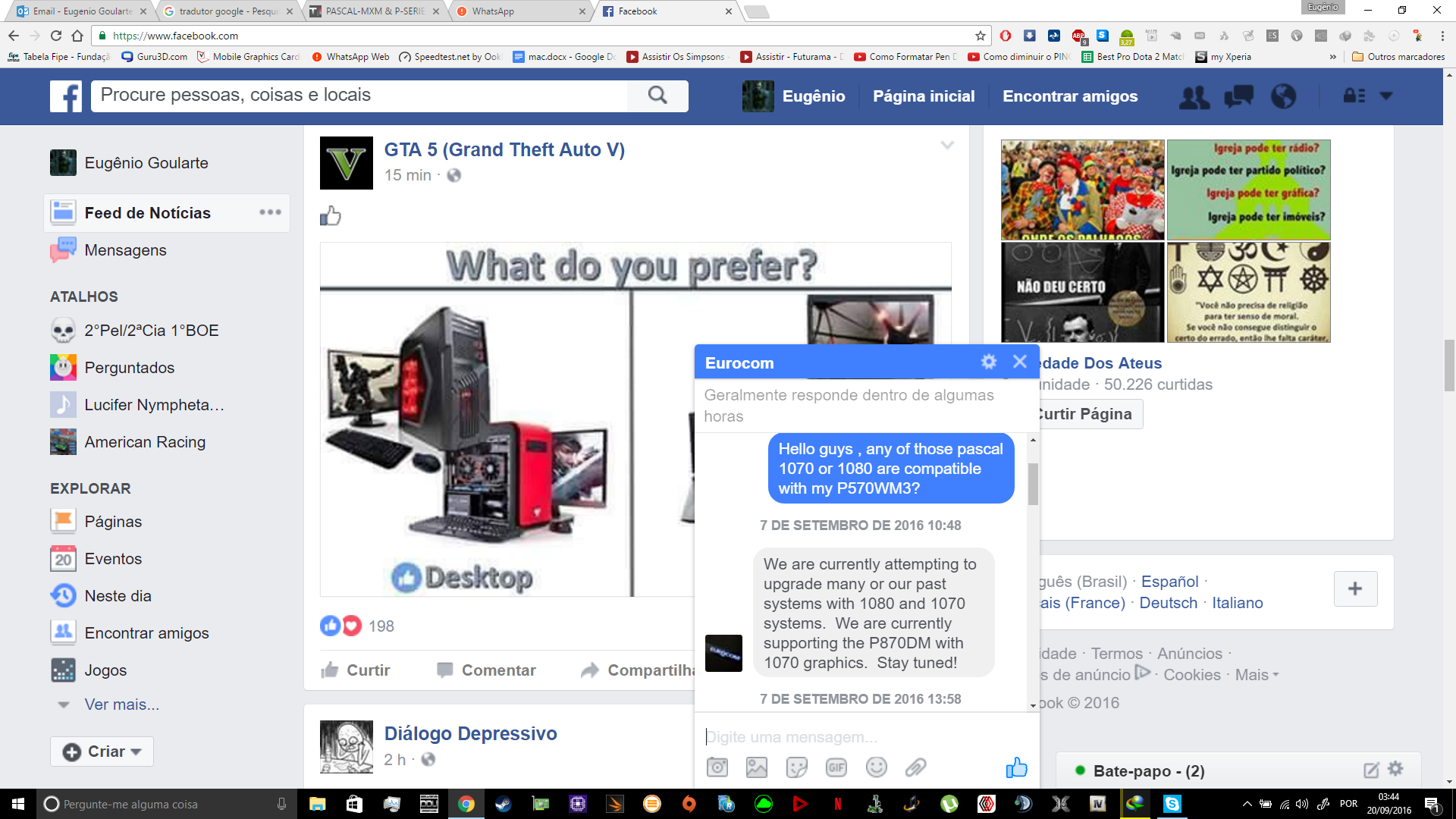

Lucifer Nymphetamine Posted September 20, 2016 Share Posted September 20, 2016 @Prema So MSI 1070 can work on P570WM3 ? SLI of 1070? they are same size of my mxm 3. (780m) ? Quote Link to comment Share on other sites More sharing options...
Guest Posted September 20, 2016 Share Posted September 20, 2016 55 minutes ago, Lucifer Nymphetamine said: @Prema So MSI 1070 can work on P570WM3 ? SLI of 1070? they are same size of my mxm 3. (780m) ? If you can cool it... Essentially most Mobile Pascal are just OCed, UVed & optimized DIE-shrinks of existing Maxwell cards: - GTX1070 ≈ GTX980 ≈ M5500M - GTX1060 ≈ GTX970M ≈ M4000M Currently the only real new addition to the mobile line-up is the GTX1080... Quote Link to comment Share on other sites More sharing options...
