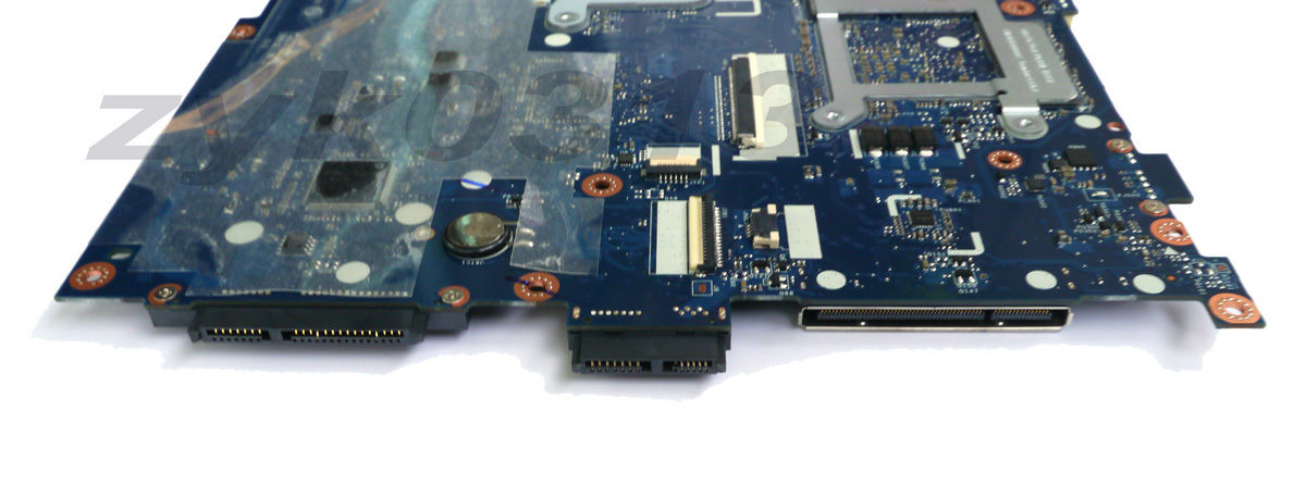

Can someone upload an HD picture of Gerald's board (I want to see how it's wired)
Looking at this image, I just noted that there is a strange connector between the Standard SATA connector and the Ultra Bay connector.
lenovo_y510p_VIQY1_NM-A032_gtx755_gtx750
What is the purpose of this connector? It is used to house another Drive instead of the eGPU?
So, I can use the eGPU and this adapter at the same time?
As I mentioned before, it IS just another standard SATA connector. It is originally for the optical drive. So it is just running at SATA2 speed(3Gbps)
