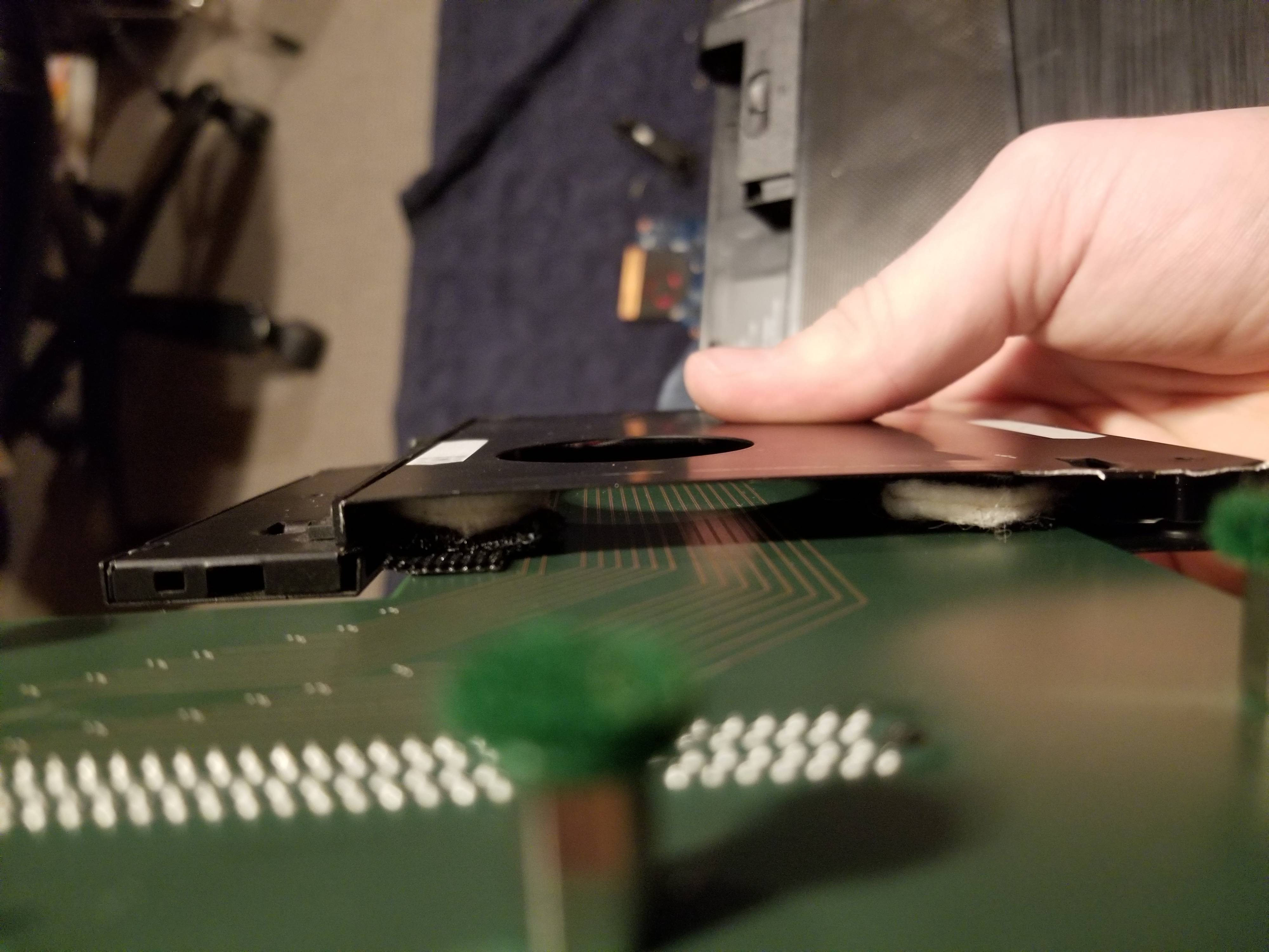

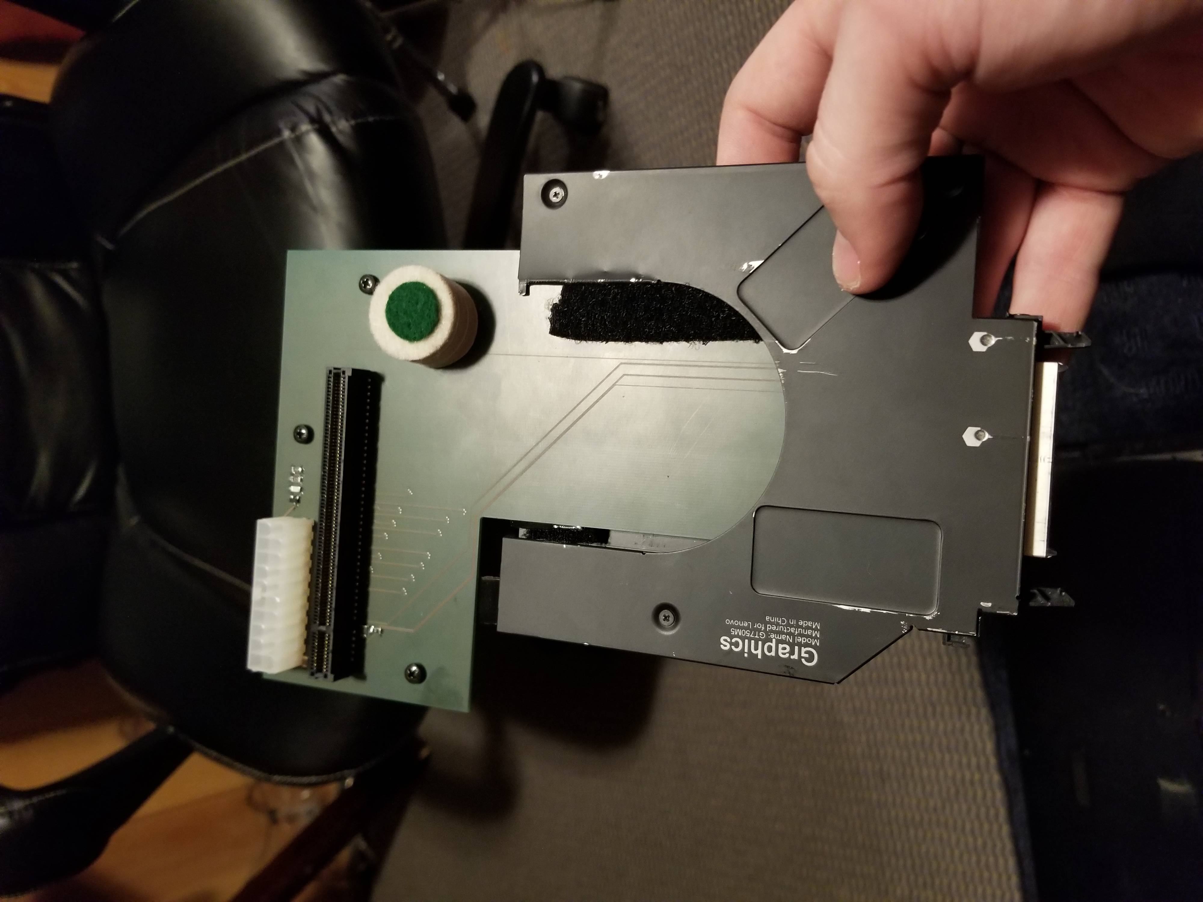

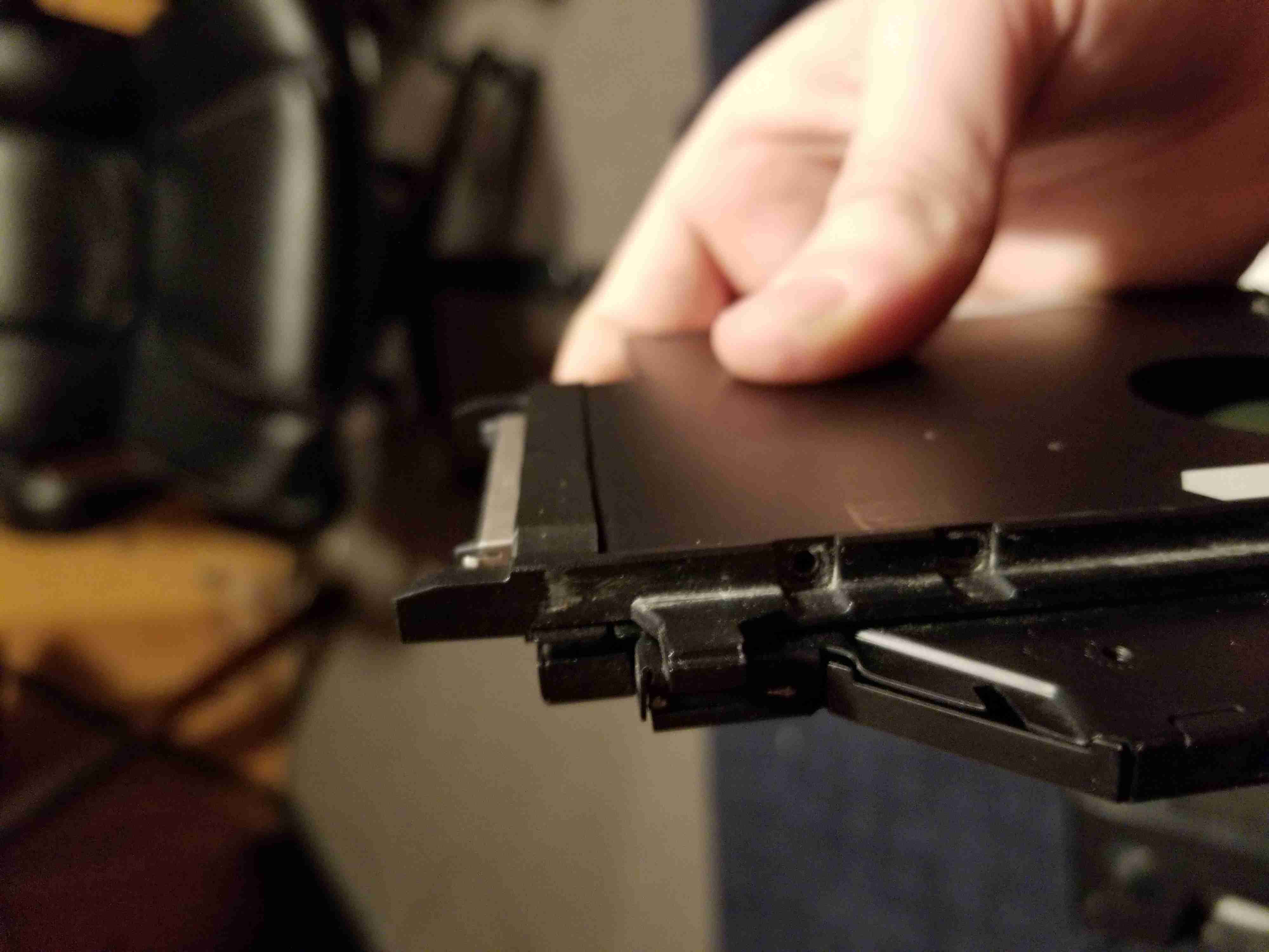

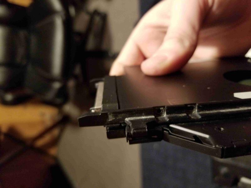

  2. For those of you who don't care about your secondary graphics card anymore, you can dissasemble the card and use the case with padding / velcro strips to house the adapter fairly easily. You just need to make sure you bend some tabs out the way and line up the connection in the same way. Its similar to an earlier post I saw, just without the hard drive connection. I used chair tips (protection for chairs against floors) for spacing and that strong velcro strip stuff that has a a strong glue stick to it on either side for securing the adapter inside the 750m ultrabay graphics card housing. Everything is much more secure this way as the housing still locks in the same way as the old GPU did. If I really cared I would run a PCI extention but my setup is pretty sturdy and is in a safe location where things won't get bumped.
