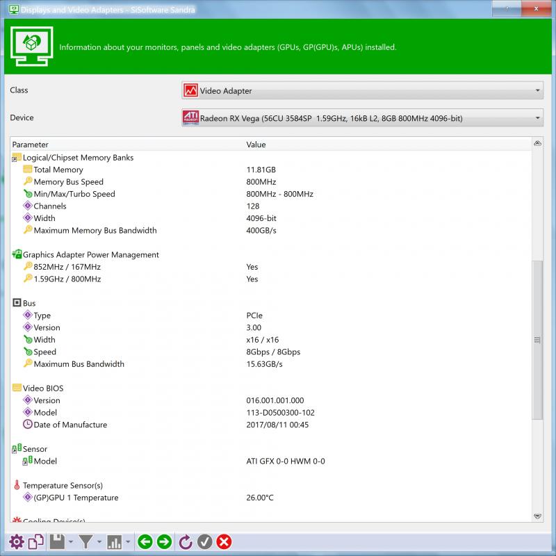

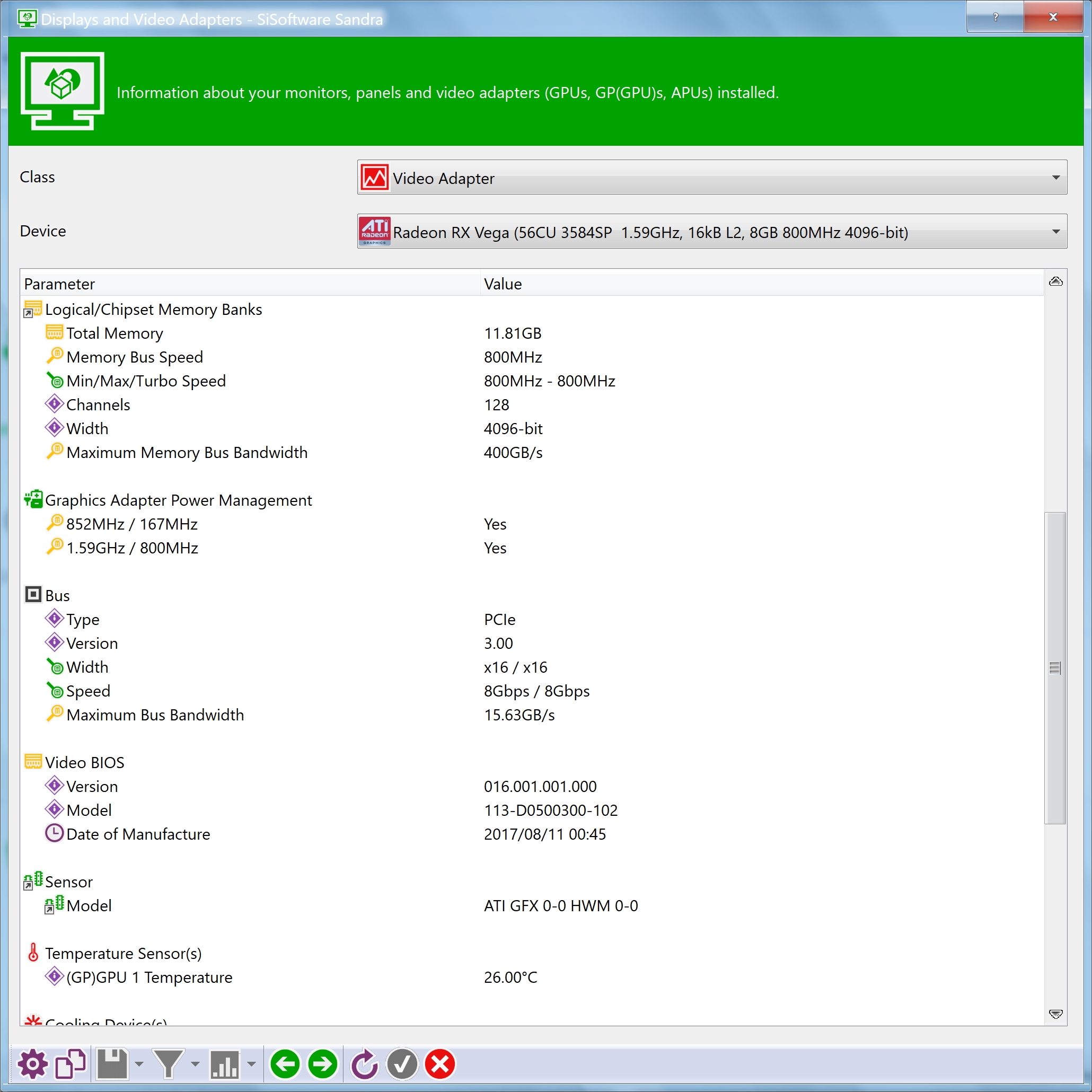

Well, here is something that is interesting.
If I interpret this correctly, SiSoft Sandra is now telling me that the Vega card is using the full 16 PCIe lanes. IIRC it previously said that the bus width was x8 / x16 . This was before I once again disabled my NVIDIA module (Windows reenables it now and then).
I cannot reproduce the original reading, though. Although I've reenabled the NVDIA module, SiSoft continues to tell me my Vega card is using all 16 lanes. What is more, the programme no longer detects the NVIDIA Video Adapter (oddly, it does detect the same module as a 'GP Processor'.
Could someone else verify these readings? Does the external graphics card use all lanes if you disable the NVIDIA card?
The bus width is x16, but the actual speed is 8GB/s(reported in Gbps which i think its a typo in the software) which translates to x8.
Think about it like a street width, you have 16 lanes but you are only occupying 8 of them at any given time.
By design; of the laptop; you can't use more than 8 for your Vega card since Lanes 0 to 7 are hardwired to your nvidia card and 8 to 15 are wired to the ultrabay slot.
Different Softwares may read a maximum theoretical bandwidth of 16 but in reality there are only 8 lanes. and I believe even if the software does read x16 used, it is because of a read error.
Either way it dosent matter how many lanes you have, as pcie 3.0 8lanes is enough to run 1080ti without any bottleneck (and that card is 30% better than vega 64/gtx1080 ), it only matters for sli witch is not the case for our adapter.
Maybe navi and/or volta will need more but for the time being it really dosent matter ^^
Thank you both.
It was mostly with an eye on the future that I asked this. :-) The Vega should last me two or three years, and perhaps by that time I'll need/want to replace the laptop anyway. The idea of potentially being able to use future cards, which will likely require more bandwidth, was rather appealing, however.
