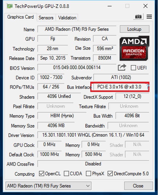

you say ''no need to change the BIOS'' .  how can you do that?
when y500/y510p owners try the sli with different ultrabay gpu (650m&750m or 750m&755m) an error message on screen at startup.
Yes, I can send the adapter to turkey too.
The BIOS has a whitelist for the one PCIe lane for WLAN. The 8 lanes from the ultrabay port has no restrictions. The BIOS supports plug & play on this port and Windows find the new device on this port.
