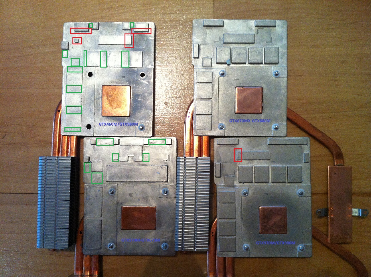

You can use Cards on Keplerchip from GTX 670MX to GTX 880M,Cards on Maxwellchips from GTX 970M-GTX 980M or Ati Cards like HD 7970M/8970M.
For Keplerchip You can use the old Heatsink from GTX 570M - GTX 675M without Modification,You only need more Thermalpads.
For a HD 7970M/HD8970M You need to modify the Heatsink.
You can buy a MSI Heatsink for HD 7970M/HD8970M and also for Kepler-and Maxwellcards for MSI.
If the Card are not from MSI You need to flash the MSI Vbios or a modified Driver INF.
If it is no Problem for You to modify a Heatsink,flash a Vbios or modify a INF then look for a cheap Card with Power and take it.
Are You not shure look for a Keplercard with MSI Vbios,but it is not complicated to flash a Vbios.

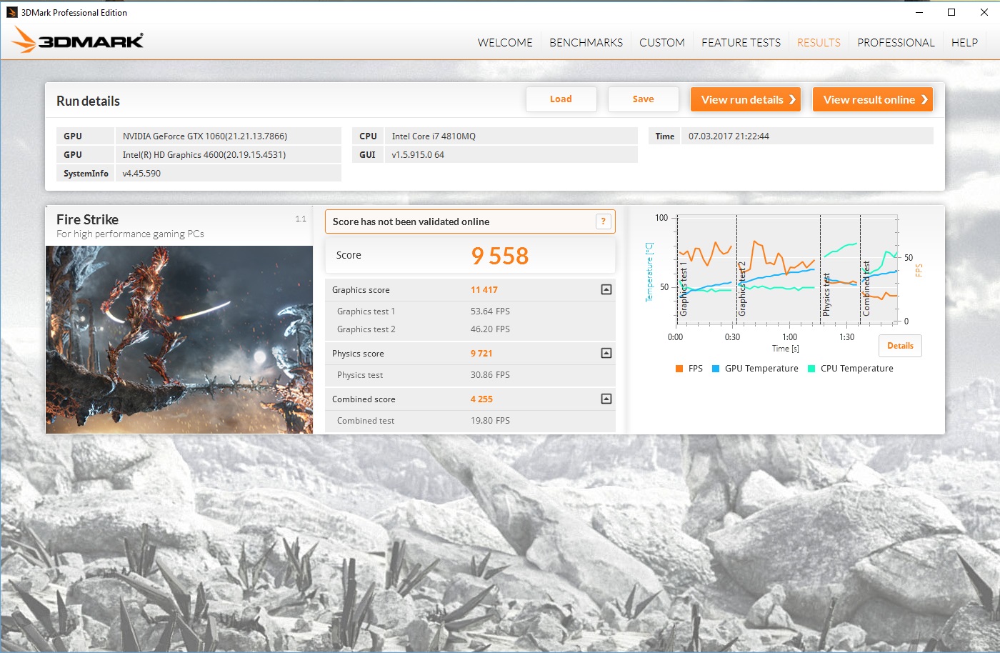

I have no graphics card at the moment, but will be ordering a gtx 1060. If you will find Zotac 1070, then try to order it.
