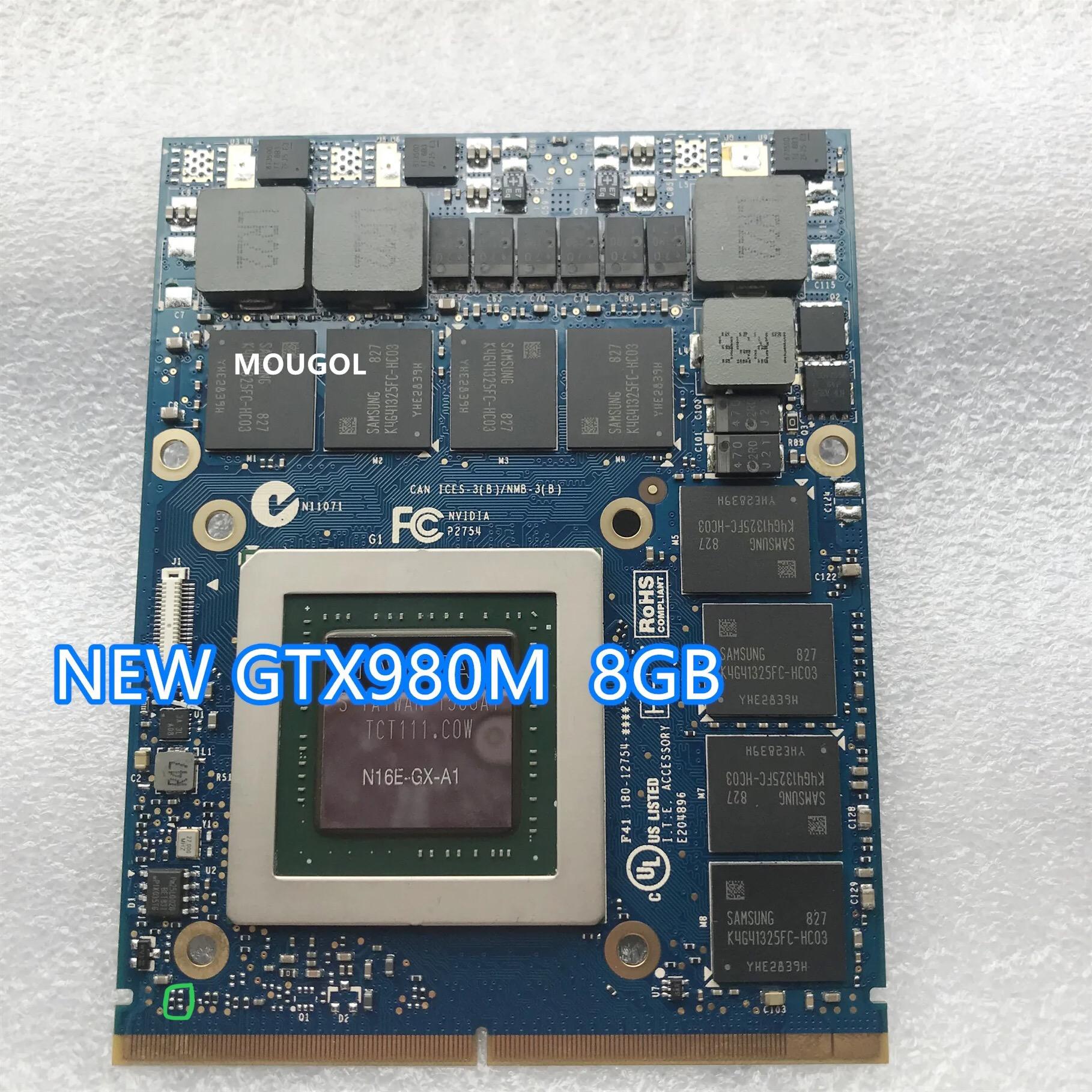

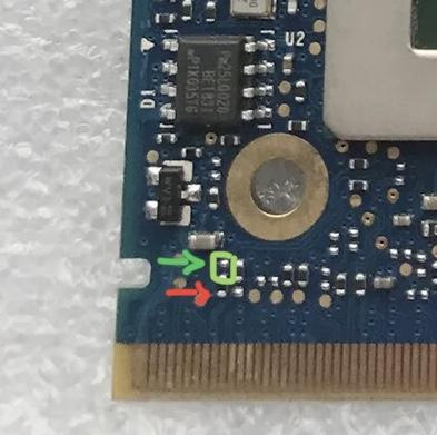

Hello, the fan can work by switching a resistor. Had the same issue and got it fix. After is just to mod the NVIDIA  drivers.
this also changes the GPU ID number.
if the resistor is placed down is 13D7. If is placed up becomes 1617.
to my understanding this is for certain ranges of laptops models compatibility  and no so sure if is also enable and disables G-Sync like some people has told me. 13D7= disable, 1617=enable.
just  becareful not to burn the resistor. Has 1~3ohms. I am not responsible for any damages, try at your own risk.
good luck.
