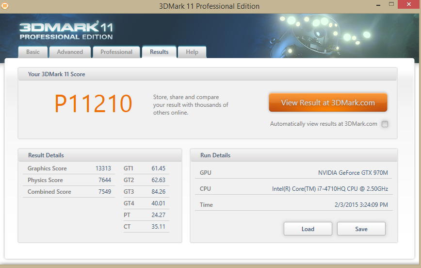

managed to overclock my gtx 970m on my asus g751 JT temps around 83-84c core at 1400 mem at 6200 [ATTACH=CONFIG]13899[/ATTACH]
Wow, excellent Graphics Score! How much voltage are you using on the GPU, is it 100% gaming stable?
Wow! That's nice! Did you get your vbios unlocked? What voltage your running?
Thank you :) yes im using a custom vbios allowed me to add +500 on the core. my voltage is at 1.2 maxed out basically :)
Thank you mate. 1.2 is my voltage and yes i've finished dying light on it running around all maxed out with 60-110 fps at max settings view distance at the middle didn't crash once. no artifacts. just heated up a bit after a few hours and I've managed to control the gpu fan and set it to %100 now its around 82c -83c while gaming
