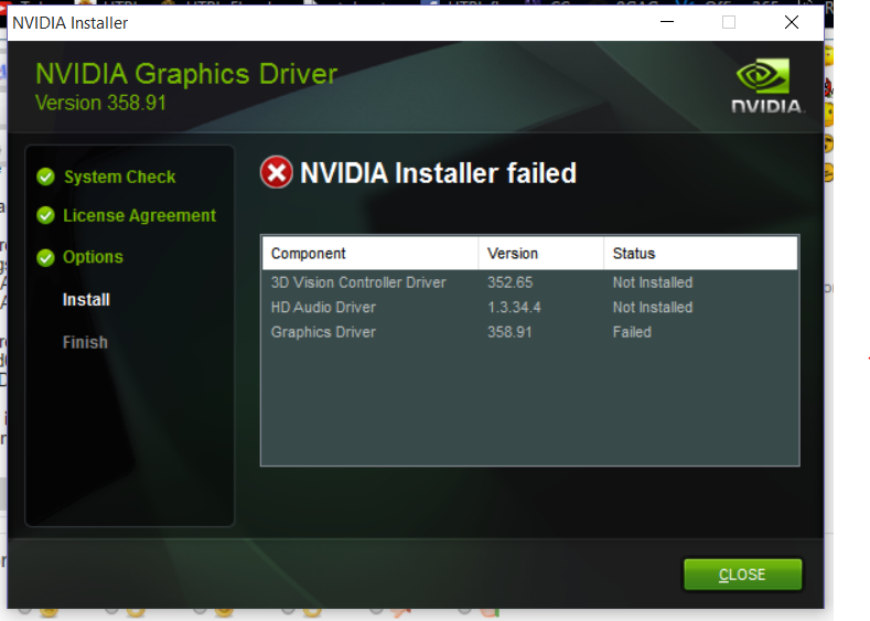

litoid Posted November 15, 2015 Share Posted November 15, 2015 i HAD IT WORKING! now i tried to update my nvidia driver from 355.60 up to 358.91. i had modded inf and i can't remember the steps very well.. i ended screwing my drivers and im driverless now my hardware ID is: PCI\VEN_10DE&DEV_119F&SUBSYS_04901028&REV_A1 the file i have is for 780m (notebook) v 358.91 for windows 10 358.91-notebook-win10-64bit-international-whql.exe These were the data for replacing in the file: nv_dispi.inf Data added: < Search and paste under > [strings] NVIDIA_DEV.119E = "NVIDIA GeForce GTX 780M" NVIDIA_DEV.119F = "NVIDIA GeForce GTX 780M" < Search and paste under> Ntamd64 %NVIDIA_DEV.119F% = Section002, PCI\VEN_10DE&DEV_119F Driver is recognized but when installing i get Driver Failed. It's annoying to get issues when trying to update nvidia 780m drivers on my Alienware R3 MX17 for Windows 10. [h=3]How to Disable Driver Signature Verification[/h] Already disabled Driver Signature Verification; but have no idea what am i missing... Please, j95, i've seen you save lives here. Help me! Quote Link to comment Share on other sites More sharing options...

litoid Posted November 18, 2015 Share Posted November 18, 2015 Yeah actually when i got to F8 activated (no idea why windows didn't let this option available by default) and login underDisable Driver Signature Enforcement it worked. the codes i used are for file nv_dispi.inf: Hardware ID: PCI\VEN_10DE&DEV_119F&SUBSYS_04901028&REV_A1 < Search > [strings] < Paste > NVIDIA_DEV.119F = "NVIDIA GeForce GTX 780M" < Search > NTamd64.10.0 < Paste > %NVIDIA_DEV.119F% = Section002, PCI\VEN_10DE&DEV_119F Done. updated and running; no broken screen. Thanks 1 Quote Link to comment Share on other sites More sharing options...
