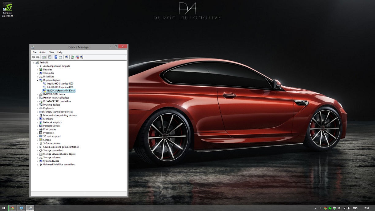

Balamut 11 Posted May 27, 2014 @Balamut M17xR4/GTX 870M, BIOS settings: IGP disabled (integrated graphics) PEG enabled (Display) PCI\VEN_10DE&DEV_1199&SUBSYS_05801028&REV_A1- Disable driver signing. - GeForce 337.88 WHQL - Extract driver 7-Zip/winrar - Display.Driver folder -> open nvdmi.inf (notepad) CTRL+H -> Find What: 05AE Replace With: 0580 -> Hit 'Replace All' -> Save. - Find What: 1198 Replace With: 1199 -> Hit 'Replace All' - Find What: 880M Replace With: 870M -> Hit 'Replace All' -> save. - Nvidia 337.88...International folder\ run setup exe. Windows has stopped this device because it has reported problems. (Code 43) Disable Driver Signature hello! thank you for help. :confused:does not work. installation without drivers. what could be the reason? maybe I should remove the driver on intel? J95 - you're a magician!!! all works!!! within 4 hours attempts ... thank you so much I'm very happy Quote Share this post Link to post Share on other sites

Balamut 11 Posted May 27, 2014 @Balamut driver signing?yes...did everything you said 1 Quote Share this post Link to post Share on other sites
