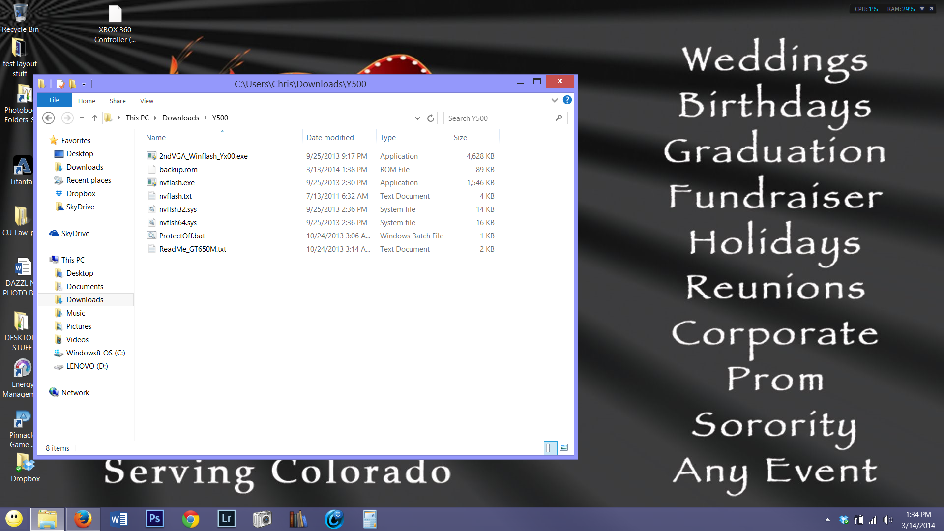

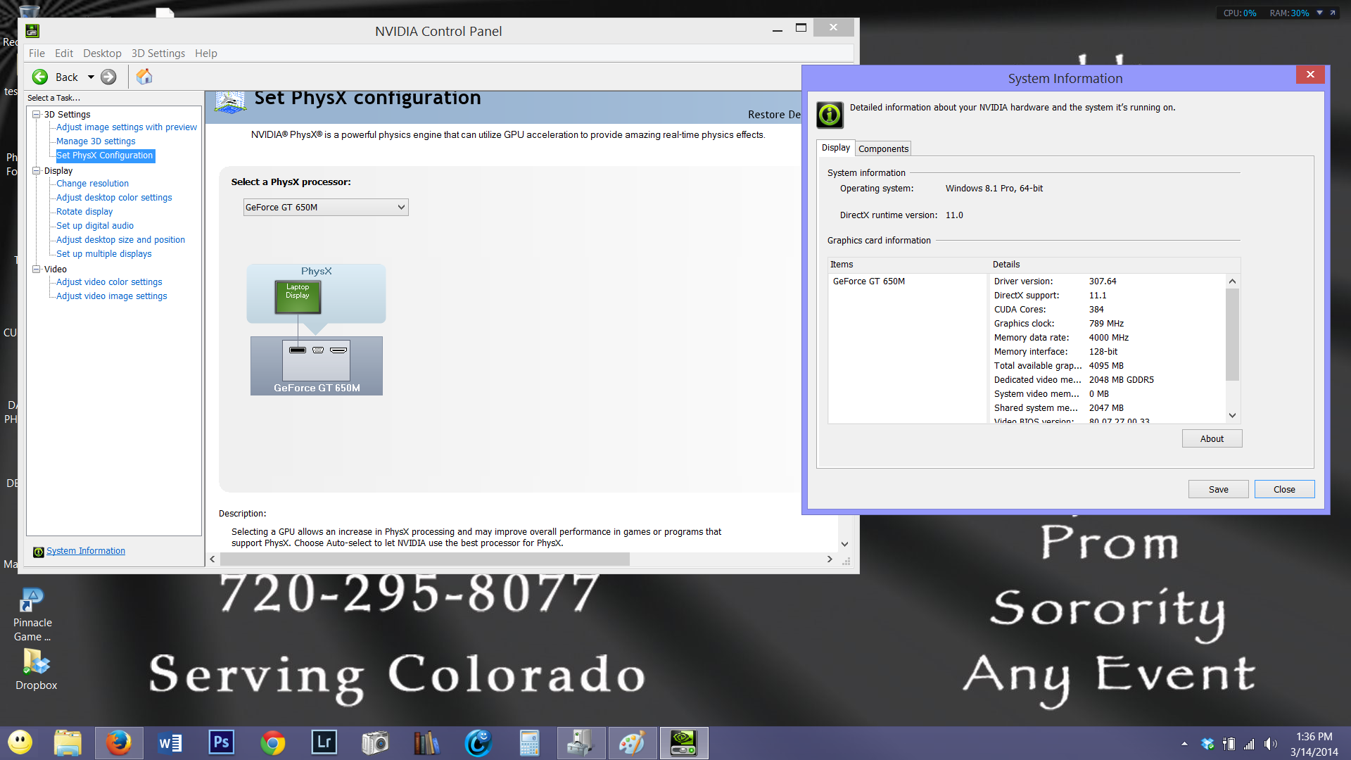

Ok, read every page on this thread. I've been working on updating my bios via the official lenovo release update for my Lenovo y500 dual SLI 650M. But no luck and soooo frustrated. I have Titanfall and plays well I guess (I'm use to PS3) but want what I paid for and that is Dual graphic cards SLI to work in Win 8.1 Pro.
I uninstall the latest nvidia cards and went back to default nvidia cards 307.64 as a few mentioned on the lenovo forums that worked for them for nvidia to see the 2 cards and allow the bios flash. Then you would update to latest (335 I believe after it worked).
I've tried every way I found online to do. Have not tried to install to DOS USB stick and boot to it.

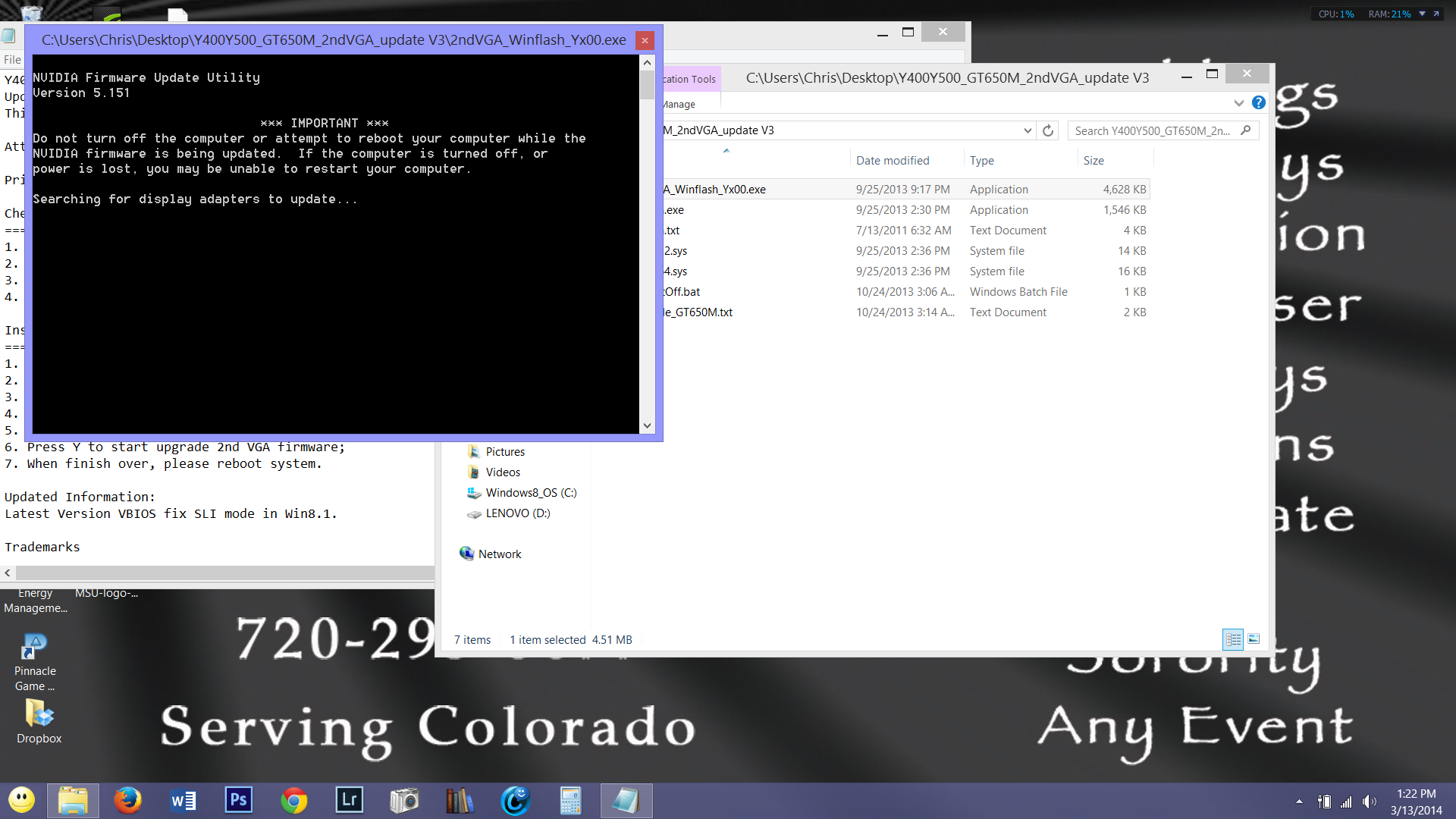

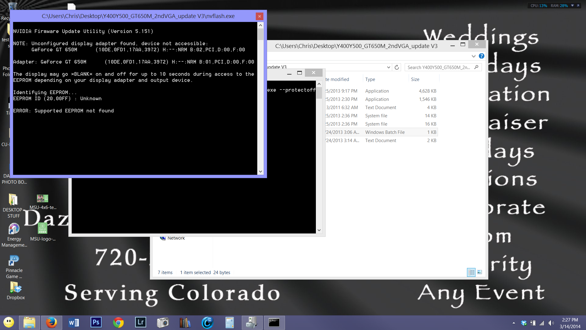

Here are some images of what errors and stuff I've gotten to hopefully help you help me. And I WILL buy you some beers or whatever $30 bucks gets you via paypal for the help!
My ignorant understanding this it is from the cmd prompt say Unconfigured Display adapter, etc. But don't know why?
Thanks in advance for your time and help!
Chris
From my point of view, there are a lot of mistakes you did.
1. Always do it in DOS mode. It is better when upgrading firmware versions.
2. If not in DOS mode, be sure that you CMD is launched as an administrator (run as administrator). Doesn't matter if your account has local admin rights, it is not the same.
3. What does it say when you hit nvflash --protectoff? (I can't see because the windows are overlapping) . Run it again with cmd as administrator.
4. Don't use that version of nvflash, try with 5.128.
Advice for future use: don't place important files on desktop profile. Use a folder in a local partition, because how you have it now, makes everything to depend on your profile, every path needs to access your account.

Doing nvflash --protectoff it says Unconfigured Display Adapter every time: post-24442-14494997365442_thumb.png
Will use nvflash version 5.128 as well.

Hmm, let's rewind.
Please try to update using DOS mode.
Use these 2 files:
nvflash: https://dl.dropboxusercontent.com/u/35135276/NVFLASH/nvflash.exe
vbios.bat: https://dl.dropboxusercontent.com/u/35135276/NVFLASH/Vbios.bat
edit the bat file to reflect the name of your rom. or simple rename your rom file to match the one in the bat file.
Copy these 2 files on the stick.
Boot to DOS and run vbios.bat
The bat file has everything it needs to perform the update of the vbios.

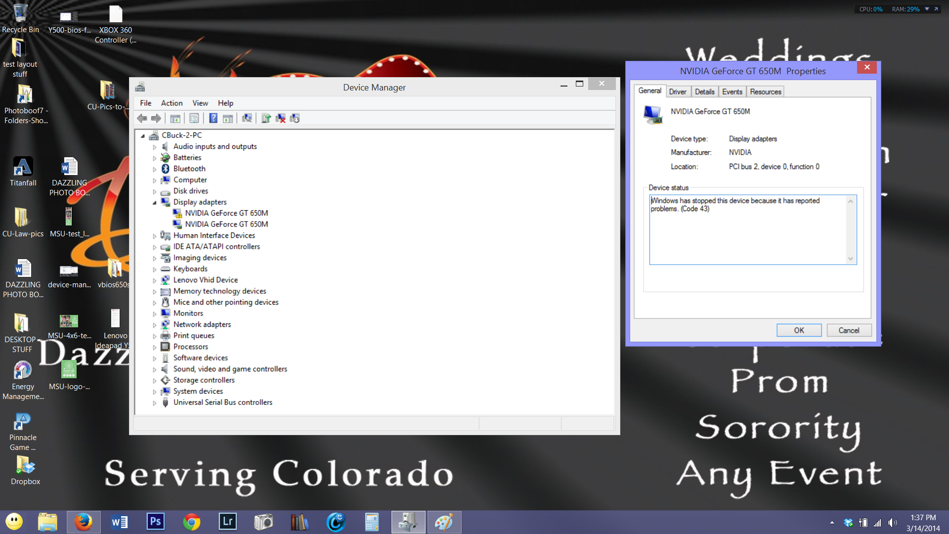

Again, the biggest thing to me and I am no pro at this, is windows say error 31 and disabling the 2nd graphic card and then in all the trys to re-flash and such, it says Unconfigured Display adapter for it. The time it seemed to flash was when I disable and re-enabled the graphic card in device manager and it stuck and said working then did the lenovo bios update files and seemed to work but after restart back in same situation.
Thanks again!
