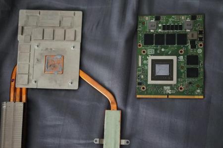

Hey guys
Just want to share my experience. I installed a gtx 770m card and gpuz recognised it right away. Windows found the drivers, rebooted and it there it was fully installed. no vbios flash, no modified drivers, nothing.
Here are some pics of install.
