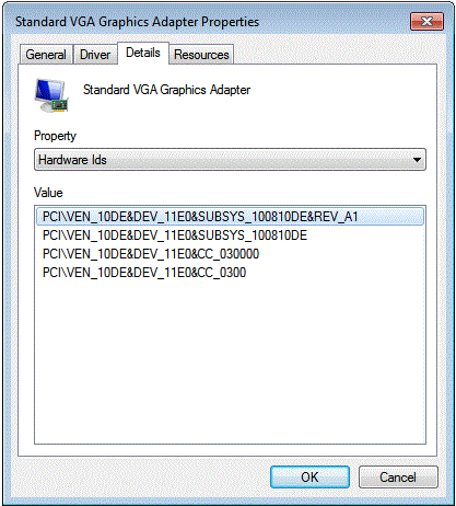

  1. Hi guys, A while back, I upgraded the video card in my notebook to a GTX770m, but I could not install the nvidia drivers normally. svl7 helped me out about a year and a half ago by providing an nvcvn.inf file that I could copy into my drivers folder and this allowed me to install the driver. I have attached all of the necessary hardware information in images. Can anyone produce one for me for 344.11 and/or show me how I would go about making one if it is not too difficult to do? Thanks a bunch! Kevin *edit* I tried following the guide on this forum but I failed

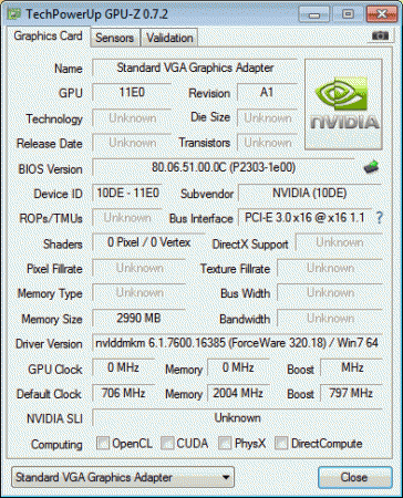

  8. Hey Xonar, I bit the bullet and bought a GTX770m for the MS-16F2, although I'm having installation problems. The computer won't detect the card (Nvidia drivers, GPU-z), although I can see that Nvidia autodetect is identifying the new card. Any idea on how to troubleshoot this? Thanks

  11. Well, the current vBios, as far as I can see, is what GPU-Z is telling me about the adapter. I saved the rom file, but I cannot upload it apparently. Thanks a bunch!
  12. Hi guys, I've gotten myself into a sort of funky pickle: I have installed a GTX770m in my MS-16F2 to replace the now antiquated GTX560m. After some heatsink modification on the mill and new thermal strips, the card went in quite easily. Now, my problem is that Nvidia's software, nor GPUz or any other install-able software will recognize the card. Nearly everything recognizes my display adapter as "Standard VGA adapter". However, when running Nvidia autodetect on my machine, it does detect the GTX770m. Additionally, I backed up the existing vBios on the card and the display adapter was recognized correctly, so I know its not just a matter of having a dead card. I already tried flashing my computer's bios with a newer and unlocked version. The flash was successful, but the video card situation hasn't changed. Does anyone have a version of the GTX770m vBios, or even better, and MSI specific copy? Any help in solving this issue would be greatly appreciated. Thanks gents
