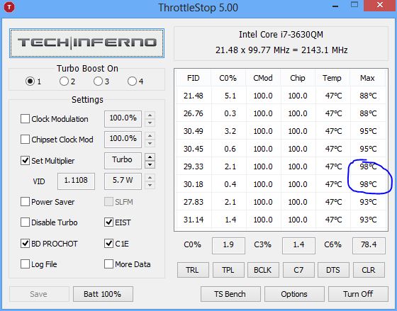

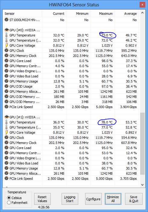

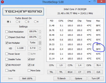

But what CPU temperature increase at load, for example in Battlefield 3, Far Cry 3, 3DMark 11, or anything else that stresses CPU and GPU simultaneously. That's what is most concerning, not how hot the GPU gets, 'cause I'm sure that will be fine. I'm not happy at all with temperatures at stock voltage. This happened to me in Battlefield 3 today. :(
It was only 75F (~24C) in my room today and I was using the cooling pad turned all the way up too. There's a lot of dust caked on the bottom where the fans are so there's probably a lot of buildup due to me benching almost non-stop for a week, but it's no excuse for how hot the CPU is getting.

You shouldn't be forcing that turbo multiplier. The 3630QM or any other CPU isnt meant for that. All you are doing is screwing up your computer doing that. You should select the BALANCED Power Plan in energy management settings. And use that and dont force turbo multiplier.
If you do that your laptop should decrease temperatures a lot. I don't think the cooling is the problem here. The problem is just the way it scales up. I also have 75C just when doing VMWare stuff when that program is idle.
What you can do to prevent stuttering is disable core parking. You can google how to disable core parking on Windows 7. I have written several tutorials for it in the past. It should also work on windows 8.
I7's are good things. But in laptops, if you pack them with turbo multipliers, you are destroying everything.
On the other hand you shouldnt be worried, I have seen 3770Ks and 3570Ks running for almost over a year on 90C temps overclocked to 4.5GHz or something similar. So should you be worried? No. But you may want to take my advice removing that setting of forcing the turbo multiplier :) !

I paid for the i7 and I'm gonna run it at full speed because it increases my FPS in PlanetSide 2, which is very poorly optimized and only uses one core, by a lot. And core parking is already disabled out of the box on the Y500 i7.

Intel designed their CPUs to continue to use full Turbo Boost right up until the thermal throttling point. I am not sure why you keep saying that it is not supposed to be used all the time.
As long as the CPU is operating within the power and temperature limits set by Intel then yes, it should be using full Turbo Boost.
octiceps: Nice to see ThrottleStop being used and that you are getting or trying to get all of the Intel intended performance out of your CPU. Some laptop manufacturers have decided to limit their laptops with some ridiculous throttling schemes rather than spend the time and money designing some better cooling solutions. As long as your CPU is operating under the 105C thermal throttling temperature, Intel says that it is at a safe operating temperature. Intel sets high throttling limits because they fully believe in their CPUs ability to run 100% reliably at these temperatures, including full turbo boost.
Edit: Here's an example.
Both the CPU and Intel GPU are hot as hell and both continue to run at full speed.
http://img27.imageshack.us/img27/6216/torturetest.png
It's not Intel that dreams up all these CPU limitations. It's laptop manufacturers that could all use a kick in the ass. Both are over 100C and both are running at full speed and then some. Fantastic technology.

At max load, with CPU fully un-throttled (running at close to 56W, 53W on mine), and both GPU running at max load at 1.15V at 1250MHz, the 170W power supply DOES NOT provide enough power for the laptop.
