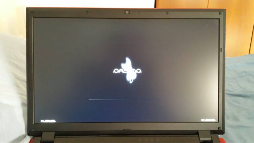

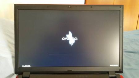

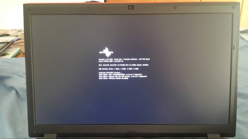

premamod bios v2 on p370sm
...it's normal to see the premamod logo start at bios, in a small windows in the centre of the screen? i remember the premamod logo view in fullsreen on p170em... if i enter into bios, i can see all in fullscreen. only the initial logo it's small!!
Inviato dal mio GT-I9505 con Tapatalk 2
I am not sure what you mean...maybe you never used the P170EM in UEFI mode, where the logo is high res and smaller?
Could you please make a screen shot to make sure they didn't re-introduce the logo bug?
Did you change CSM settings? Like forcing UEFI vBIOS in non UEFI mode? Are you using fastboot or is an external screen connected, too?
Please load setup defaults, save and exit and confirm that it looks the same...
