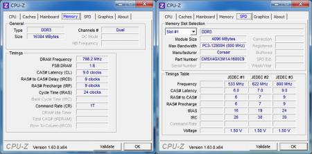

Corsair Vengeance 1600mhz probably works fine with 1T, right?

I have Corsair Vengeance 1600MHz 9-9-9-24 4GB*4.
[ATTACH=CONFIG]7238[/ATTACH]
It works fine with 1T.
same here, i have 4 gb x 4 as well and it is working at 1T alrteady, even if i didn t update with the ltest Prema bios, they are fine.
