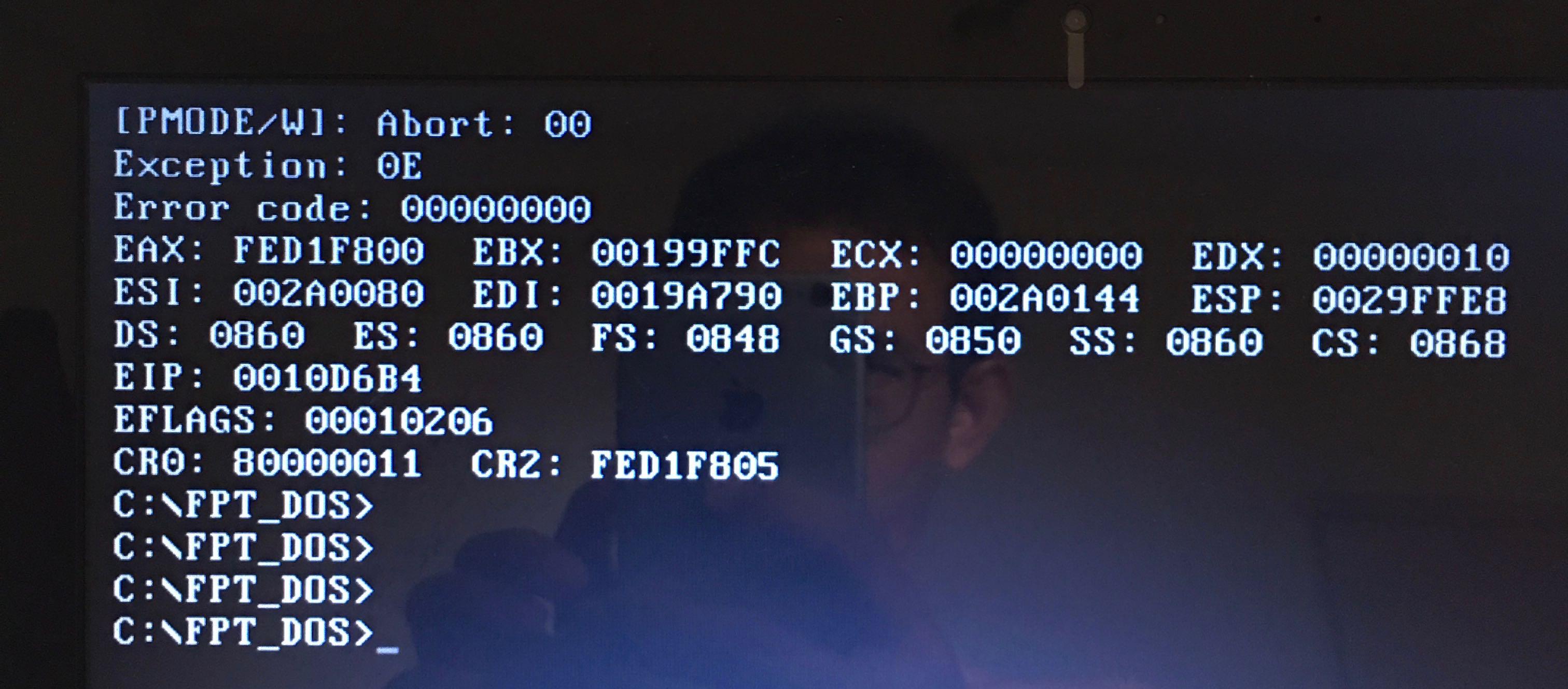

yag1z Posted July 17, 2019 Share Posted July 17, 2019 (edited) Hi, I have changed boot to legacy support with usb boot but DOS screen is not execute. It stuck at lenovo bootlogo. Edited July 17, 2019 by yag1z Quote Link to comment Share on other sites More sharing options...

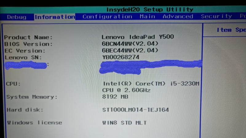

Sykriss Posted September 9, 2019 Share Posted September 9, 2019 So I have spent the last four hours scouring the internet trying to find the 2.02 update file as I have 1.05 and need to update to flash a modified BIOS. Turns out that the ONLY place to find it is in the file pack linked by OP, however obviously new users cannot download attachments without the whole five posts, approved by moderators, account promotion blah blah blah. In an attempt to save time, I tried to pay the six dollars for the Elite membership on the site so I could download it, but guess what? The page seems to be broken and I cannot add a new card to pay with. Can someone PLEASE PM me a link to the 2.02 update? I have the 2.04 but cannot use it without updating to 2.02 first. Please! Thank you so much! Quote Link to comment Share on other sites More sharing options...
Bios Modder Klem Posted September 9, 2019 Bios Modder Share Posted September 9, 2019 56 minutes ago, Sykriss said: Can someone PLEASE PM me a link to the 2.02 update? Lenovo's original stock bios you can download from this link: https://www.sendspace.com/file/e7wymz Quote Link to comment Share on other sites More sharing options...
Sykriss Posted September 9, 2019 Share Posted September 9, 2019 7 hours ago, Klem said: Lenovo's original stock bios you can download from this link: https://www.sendspace.com/file/e7wymz Thank you so much man! Successfully updated from 1.05 to 2.02 then 2.04. I have my bootable disk ready, however I just realized that the package I downloaded did not include "y500-y400-sli-650m-80.07.27.00.33-oc.rom.zip". Is there any way you could PM me a link to that? Quote Link to comment Share on other sites More sharing options...

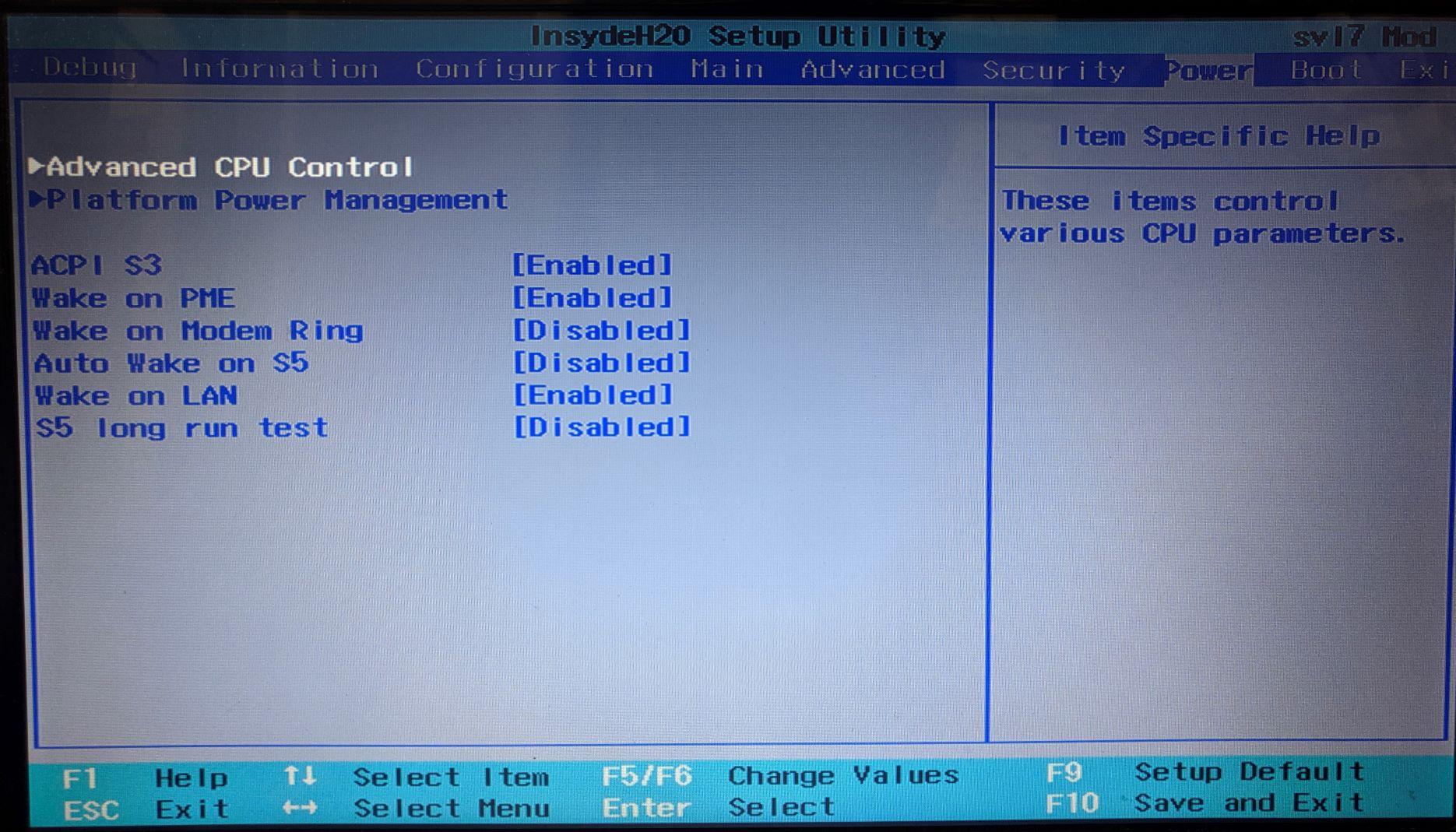

wdnmd Posted October 6, 2019 Share Posted October 6, 2019 (edited) On 3/5/2018 at 6:06 PM, MI19 said: Is anybody able to use Wake On LAN from S5? Only when shutdown to S3 state the keyboard an mouse are working for waking up the Y500. When going to S4 or S5 sleep state keyboard mouse and networkcard are dead (seems without power). So no possibility to wake the laptopp. Waking is the only posible with On/Off switch. In the Bios i activated WOL. Any idea? @MI19 Hi MI19, I have the same question with you. My laptop is y410p and I flashed the modded bios thanks to svl7. I found wake on lan config in the bios, but it seems has no effect. I can only wake from sleep state, unable to wake from hibernate and shutdown. When laptop sleep the network adapter's light remains blinking but goes off when hibernate or shutdown. Edited October 6, 2019 by wdnmd Quote Link to comment Share on other sites More sharing options...
