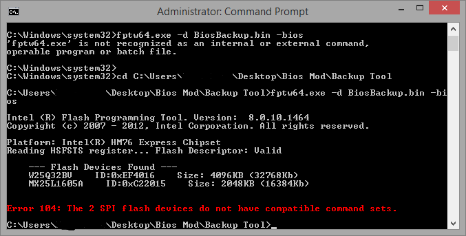

I cant seem to create my backup. With the dos and 64 version when I click the backup.bat it opens a window and closes so fast I can't even see what it says.
If I try to use the provided command line (-d BackupBiosY500.bin -bios) I get error
'Error 200: Invalid parameter value specified by user. Use -? option to see help."
I cannot launch the DOS application, windows alerts me saying "this application can not run on your system"
Am I just stupid and doing it wrong? haha.
Yeah I was stupid. I ran it from the cmd and got it.
