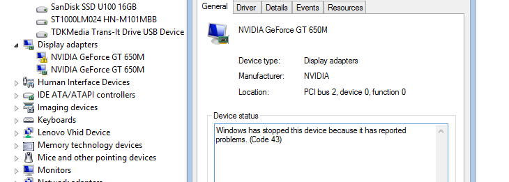

i issue some problem... after flashing ultrabay video card with modded rom windows give me a drive problem on second video card and don't enable SLI (seem driver don't recognize the video card). i'm using win 8.1, some one have any kind of idea on how to solve this problem? i already tryed reflashing ultrabay card, reinstall driver, but nothing to do!post-13796-14494995894571_thumb.png
