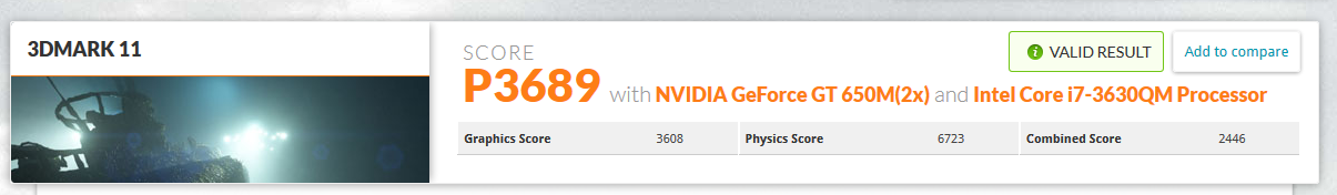

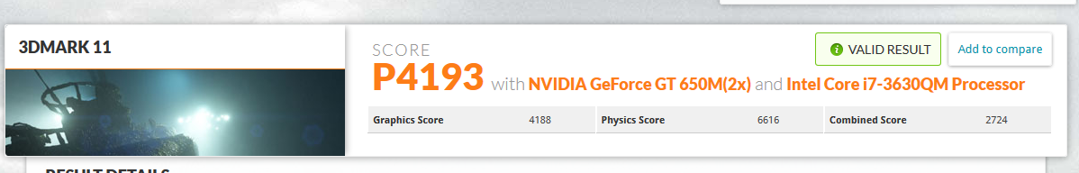

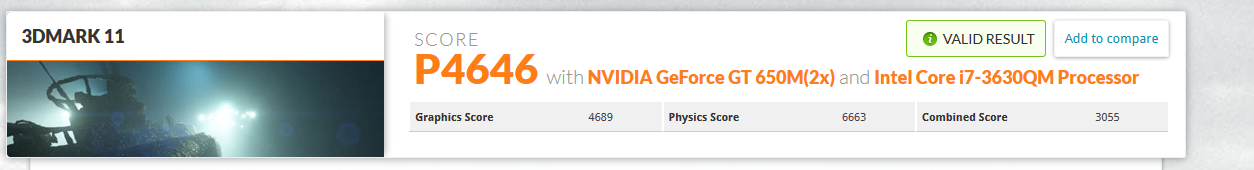

These are what I got from 3D Mark11:
Stock clocks:
Ultrabay OC at numbers above, stock internal:
Both at OC:
The difference is quite noticeable, and the low ASIC of my Ultrabay GPU bothers me because it's most clearly limiting potential, though thankfully not as much as if they had to be synced.
With my testing I can't seem to get past the numbers above on core or mem too too much without Heaven or my drivers crashing on me at some point during the short benchmark. When I was testing my OC with Skyrim I was getting artefacts if I went higher, but hard system lock-ups much more frequently.
EDIT: I can see in those pics the physics score going down, the CPU is likely throttling a little bit.
