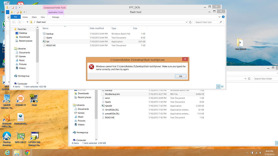

Alright so I am new to overclocking and thought I would try it on my y500 sli on bios v.2.02. But I ran into some problems that I was hoping someone would be able to help me with. I was able to put dos on my flashdrive, but when i try to create a backup of my bios I keep running into problems. I tried using the ftpbios program and got this error message...post-14852-1449499568101_thumb.png
I got that message after I ran the .bat file, and i tried running it as an administrator, but that didnt do anything.
So after that I used the win64 version and tried doing the same thing and got a "fptw64.exe is not recognized as an internal or external command. operable program or batch.
Ive done hours of reading through forums (mostly this one) and cant find anything.
Also Ive tried replacing the fparts doc and it didnt help.
Any help what so ever will be greatly appreciated.

Right click the fptw64.exe, properties, compatibility tab, check mark 'Run as administrator. Then try double-clicking the backup.bat that is within the fptw64.exe folder. Report back.
+1 this is the solution.
You need to be in the same folder as the fptw tool, shift-right click in the folder where you saved it and then click on "open cmd here". Then try again.

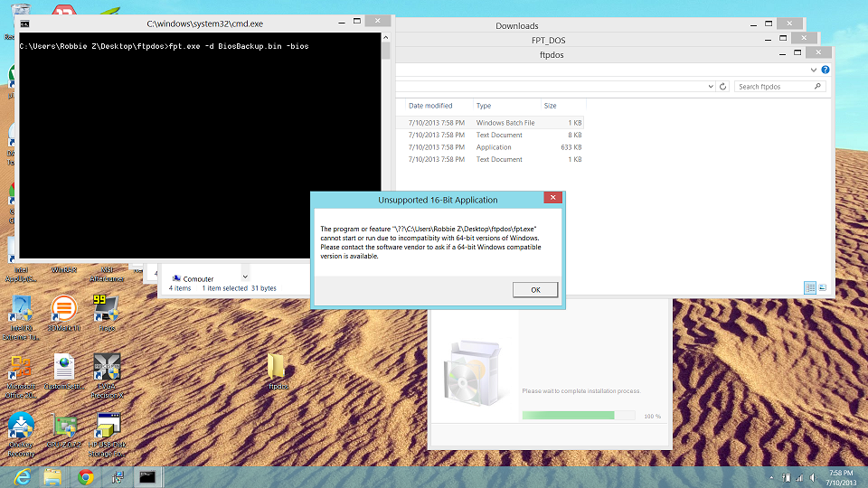

yeah sorry im new at this. So I was able to make backup bios (thanks again) but i'm not able to run the flash tool, it just gives me this error message...post-14852-14494995681436_thumb.png
Im sure its something simple, I just dont know enough about computers to figure it out myself
Really appreciate the help
yeah sorry im new at this. So I was able to make backup bios (thanks again) but i'm not able to run the flash tool, it just gives me this error message...[ATTACH=CONFIG]8231[/ATTACH]
