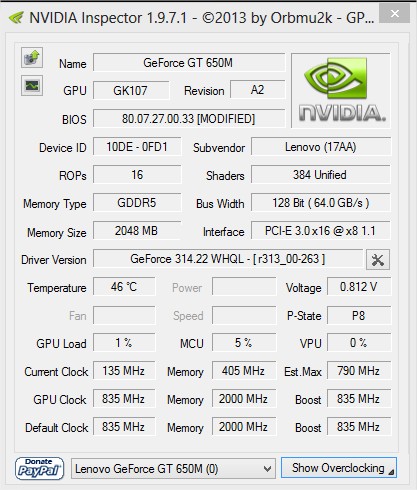

I can confirm the new version of updates [for both bios and ultrabay] works great - gpu say it's 835mhz gpu clock without oc [my stock version was 790 without oc]
So the problem still exists

[ATTACH=CONFIG]7326[/ATTACH]
It is weird... this is what I have on stock with nVidia Inspector right now...?
Yes I can confirm that the bug is still there. As long as Est. Max and Default Clock differ there's gonna be that 45 MHz offset between reported core speed and actual core speed. Maybe this has something to do with Lenovo disabling GPU Boost on the 650M? Anyway, it's just a small error that I thought could be fixed but it's not a big deal and doesn't affect anything. Just keep in mind if you're overclocking to subtract 45 MHz from whatever core clock GPU-Z and Nvidia Inspector report.

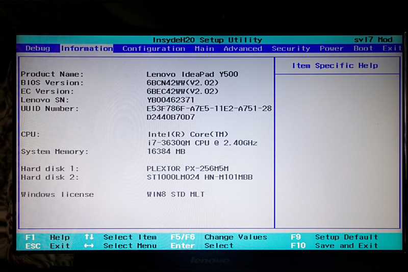

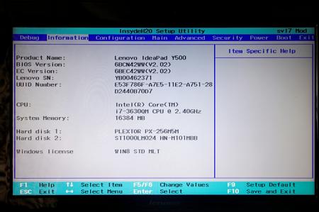

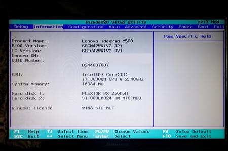

I took some pictures of the latest v2.02 modified BIOS.
Perhaps they are useful for some of you...
Greetings,
Auke Nauta
[ATTACH=CONFIG]7334[/ATTACH][ATTACH=CONFIG]7335[/ATTACH][ATTACH=CONFIG]7336[/ATTACH][ATTACH=CONFIG]7337[/ATTACH][ATTACH=CONFIG]7338[/ATTACH][ATTACH=CONFIG]7339[/ATTACH][ATTACH=CONFIG]7340[/ATTACH]
[ATTACH=CONFIG]7341[/ATTACH][ATTACH=CONFIG]7342[/ATTACH][ATTACH=CONFIG]7343[/ATTACH][ATTACH=CONFIG]7344[/ATTACH][ATTACH=CONFIG]7345[/ATTACH][ATTACH=CONFIG]7346[/ATTACH][ATTACH=CONFIG]7347[/ATTACH]
[ATTACH=CONFIG]7348[/ATTACH][ATTACH=CONFIG]7349[/ATTACH][ATTACH=CONFIG]7350[/ATTACH][ATTACH=CONFIG]7351[/ATTACH][ATTACH=CONFIG]7352[/ATTACH][ATTACH=CONFIG]7353[/ATTACH][ATTACH=CONFIG]7354[/ATTACH]
[ATTACH=CONFIG]7355[/ATTACH][ATTACH=CONFIG]7356[/ATTACH][ATTACH=CONFIG]7357[/ATTACH][ATTACH=CONFIG]7358[/ATTACH][ATTACH=CONFIG]7359[/ATTACH][ATTACH=CONFIG]7360[/ATTACH]
You should probably black out your Lenovo SN and UUID.
