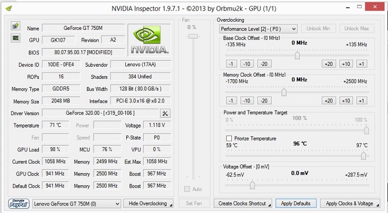

Also this is what my nvidia inspector looks like.
Though sliding the voltage around and applying didn't seem to change what the voltage was registering.
It was at 1.118v the whole time, when I overclocked it by 135mhz it jumped to 1.125v but never beyond that no matter what I did with the voltage slider.
Also the Priorize Temperature feature worked moving the slider around and applying it would cause the fan mhz and voltage to throttle down/up to maintain that temp with in around 1C variation.
I used furmark to simulate load and since base clock offset and temp setting and memory clock worked in real time (can apply and settings take effect immediately) the voltage settings should as well if it worked so I have to assume it isn't actually doing anything.

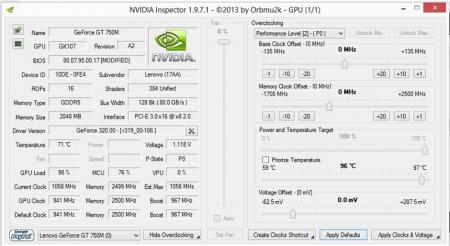

[ATTACH=CONFIG]7197[/ATTACH]
I figured it probably didn't do anything. You never see software voltage control on mobile GPU's. vBIOS flashing is pretty much the only way to go about it.
