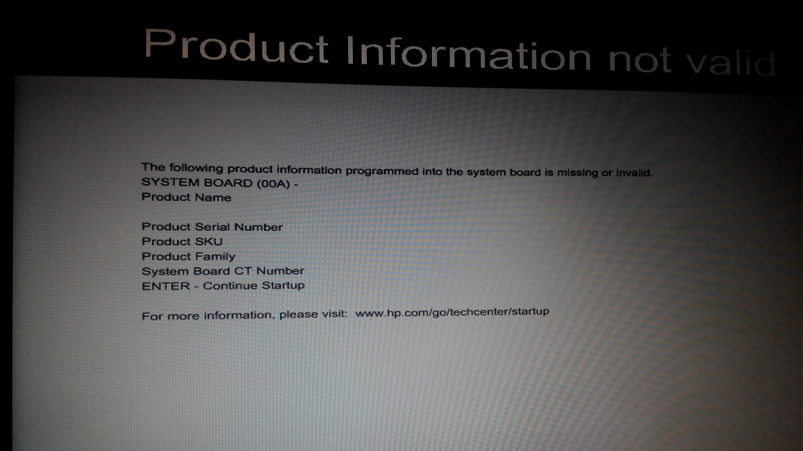

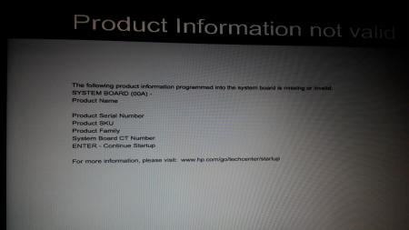

When it powers on it displays a message about machine not state, and Product information not valid, and it waits for ENTER to be pressed. Thankfully, other functionality does not seem to be affected. I tried the WIN+B option, but it does not begin to beep, or do anything else other that the fan spinning fast and the CAPS LOCK led blinking; I left it for about 7 minutes in this state. I have attached the start-up messages
Right. SO it's more than cosmetic then. Please follow the directions carefully given in my previous post. I no longer have a 2570P to be able to try them myself so that's the best I found by googling around/

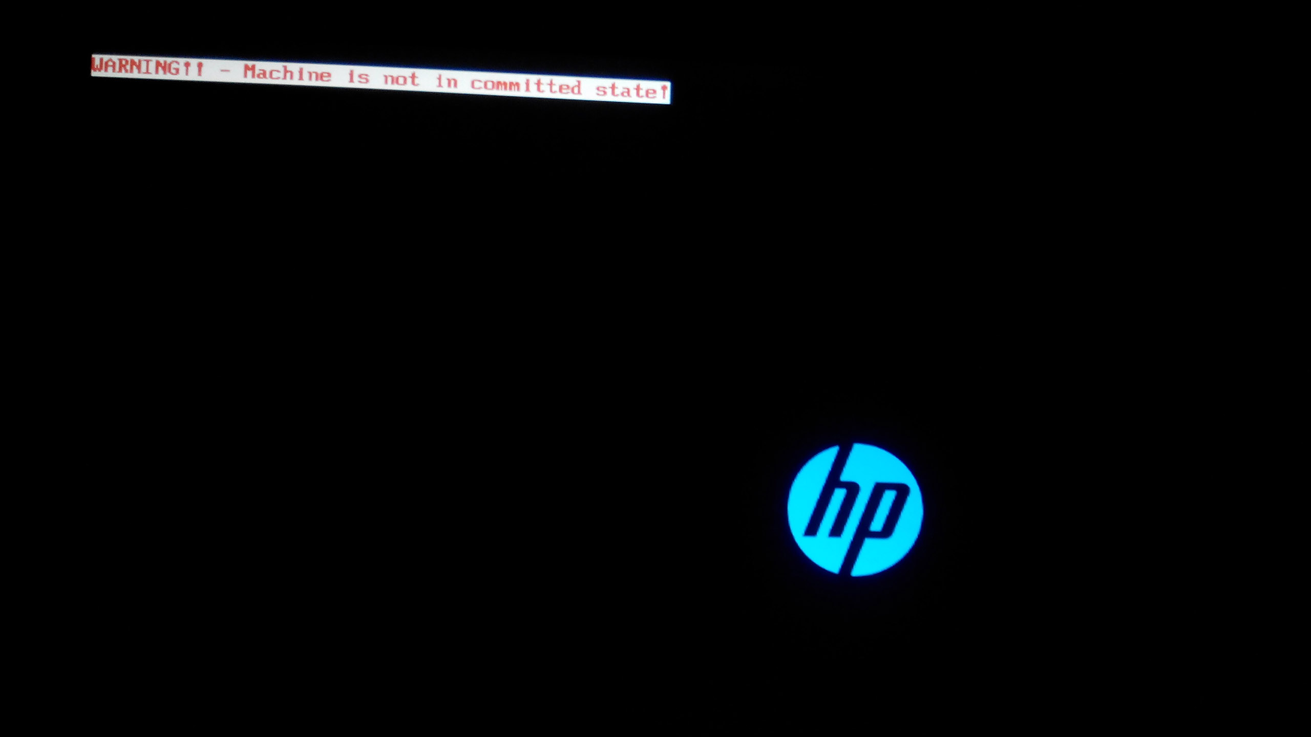

I managed to commit it, the key combination was WIN+UP+DOWN and the power button, HOLDING IT FOR at least 2 seconds ( I was not holding it in my first attempts), then follow the instructions, with wndmifit, and then setting MPM back on. Thank you, Tech Inferno Fan!
PS : Now I wish to disable the ME, but I cannot modify it, because it is not uncommitted anymore, and the UUID is not FFFF.... anyway, another experience, faster startup

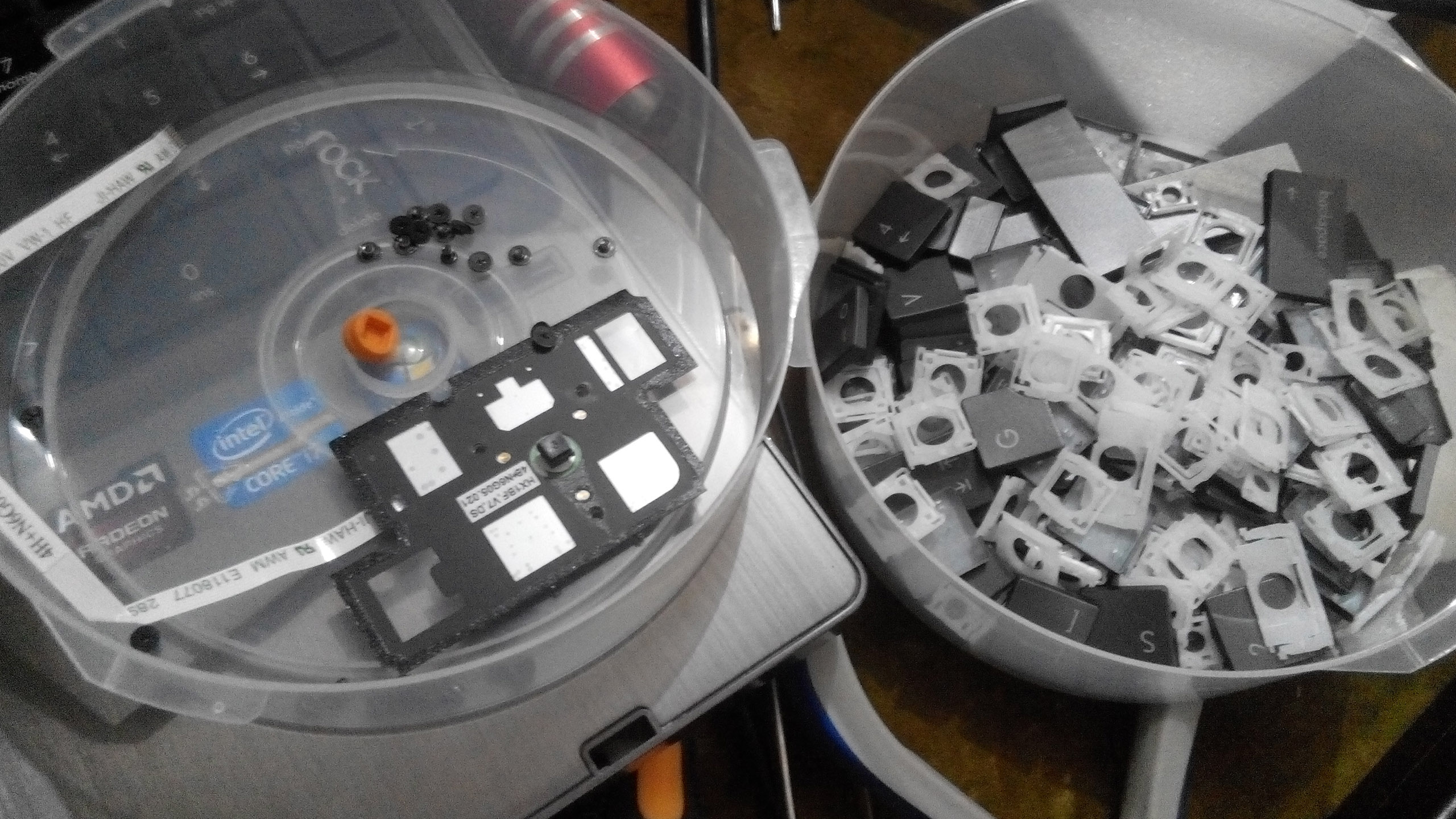

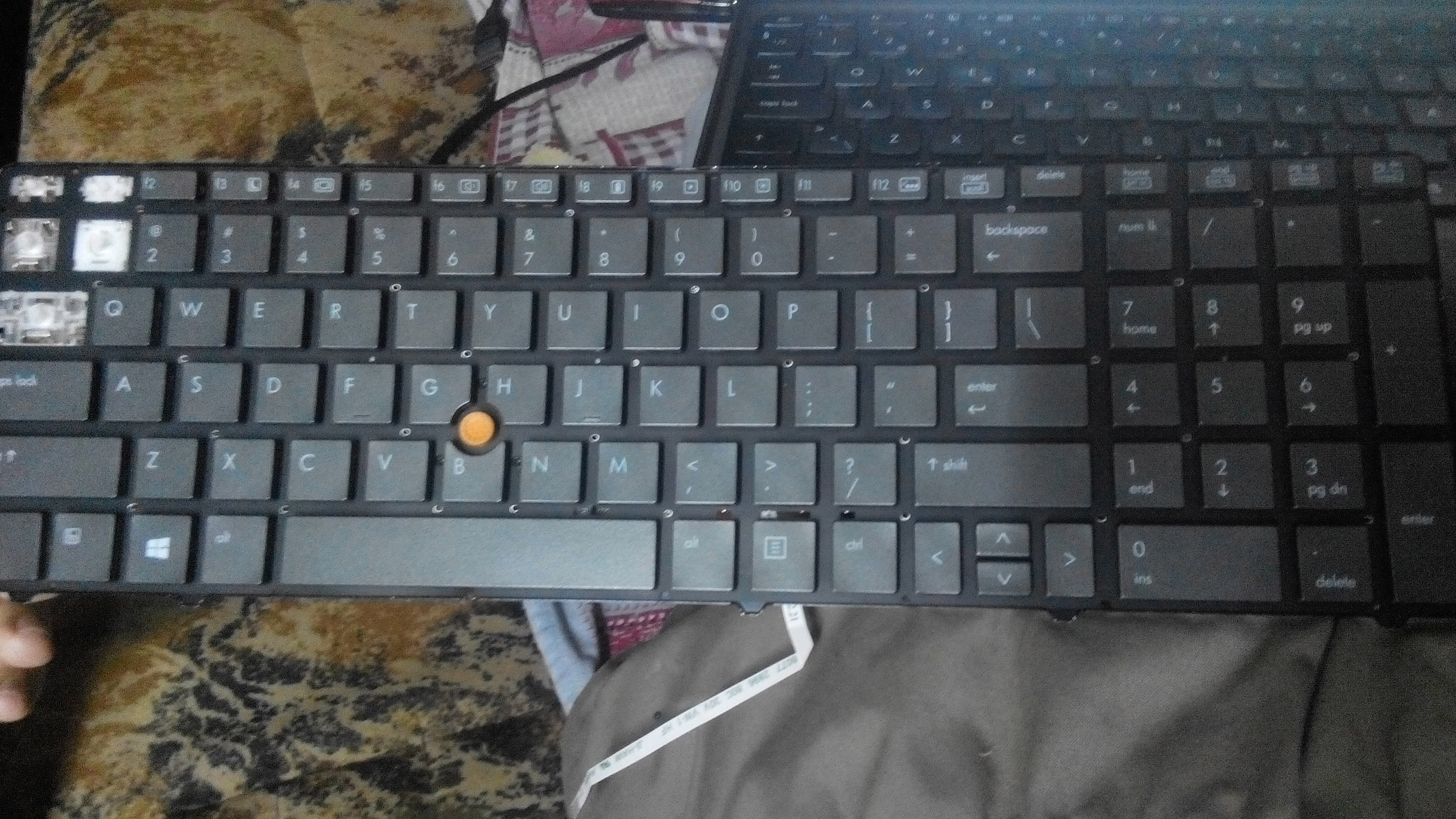

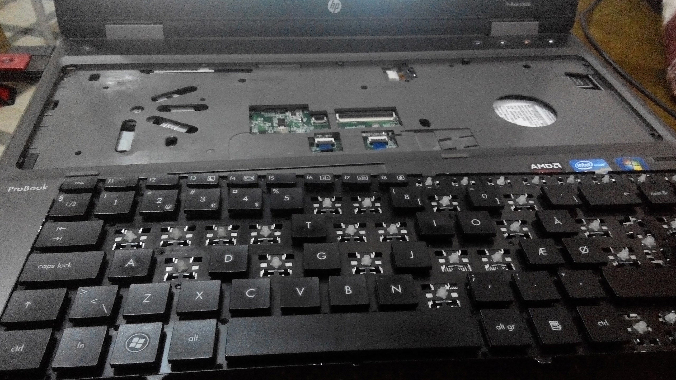

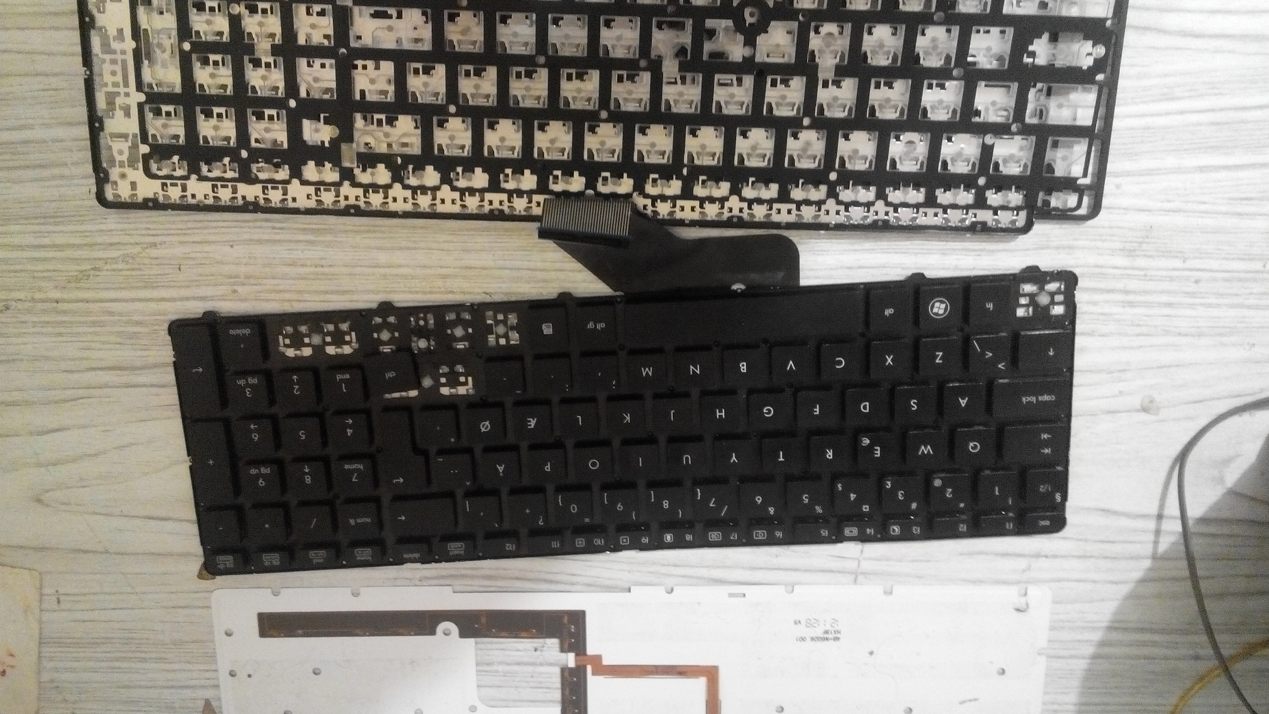

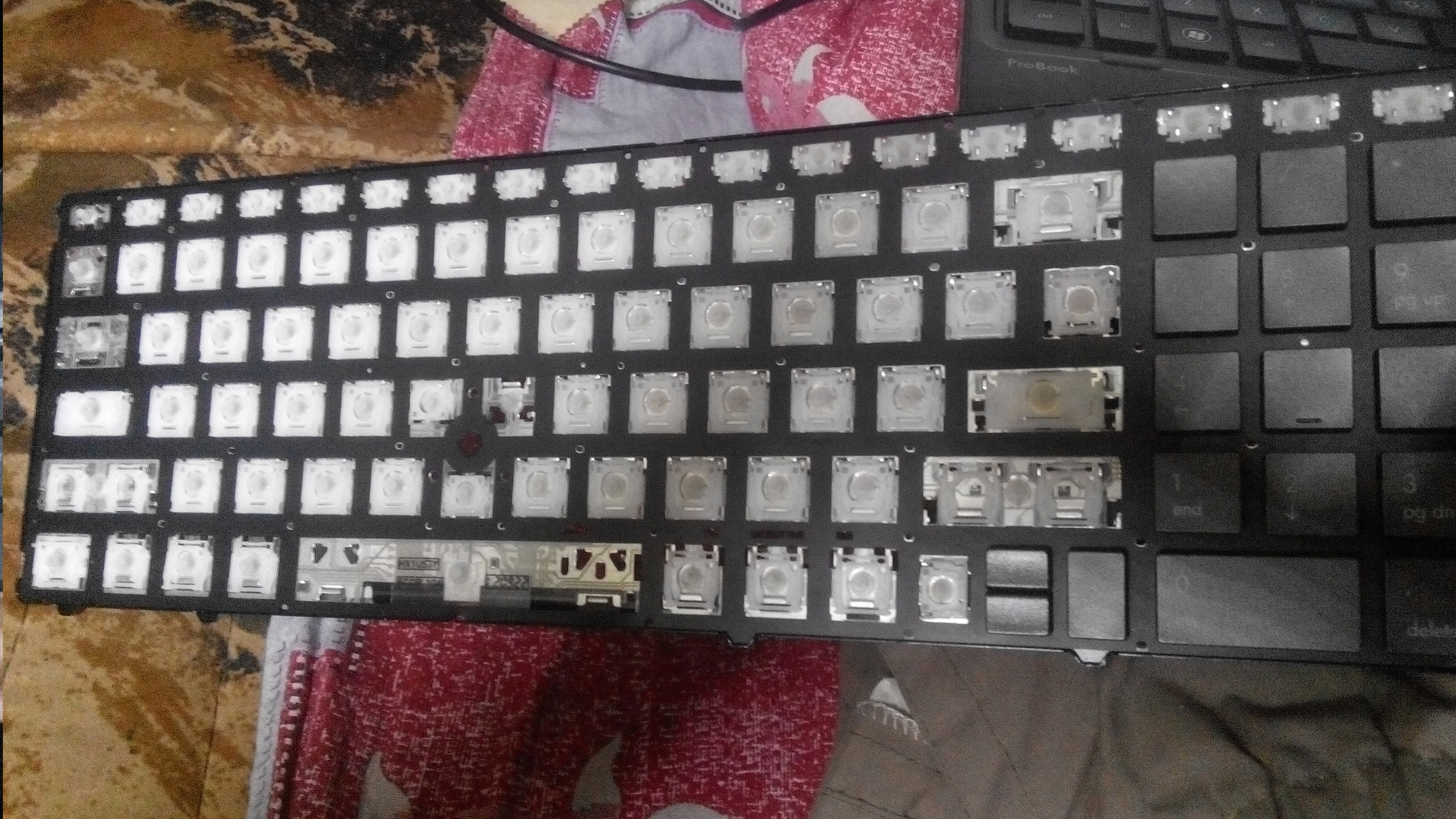

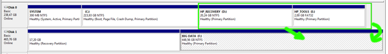

post-28261-14494998395736_thumb.jpggetting angry, this is the second attempt, after writing a whole article IE crashed and lost all the writing :( EDIT: Third
back: I want to tell about 2 things, one I have tried and other I would like to ask about. I repeat, I have the 8570p and not the 2570p model, but as I cannot find a dedicated thread and community such as this, and I think the differences are unsignificant
and mostly about layout, I will still post here.

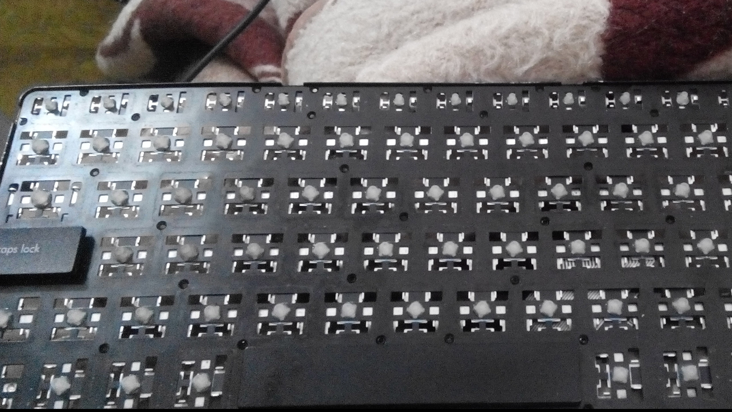

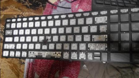

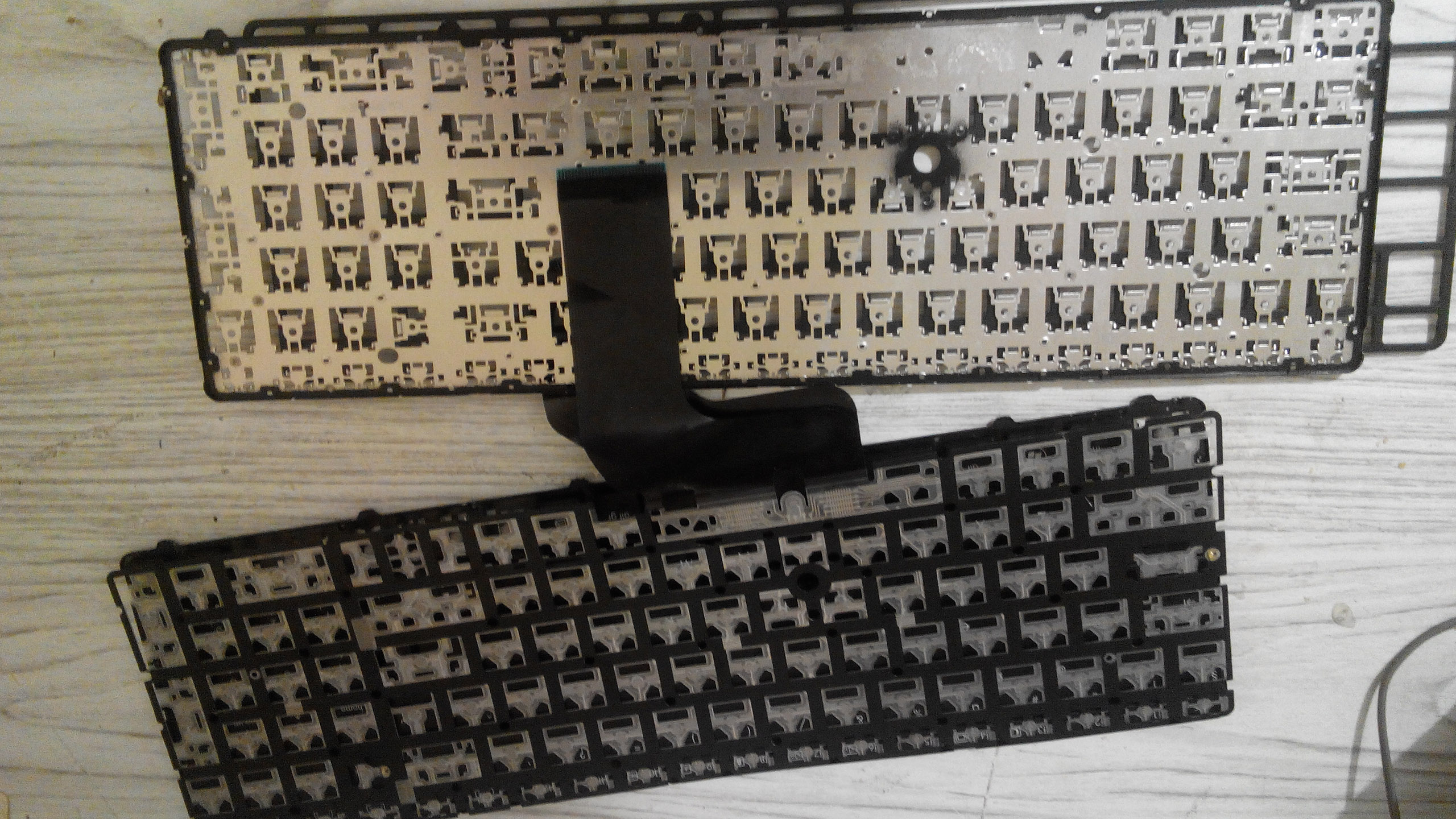

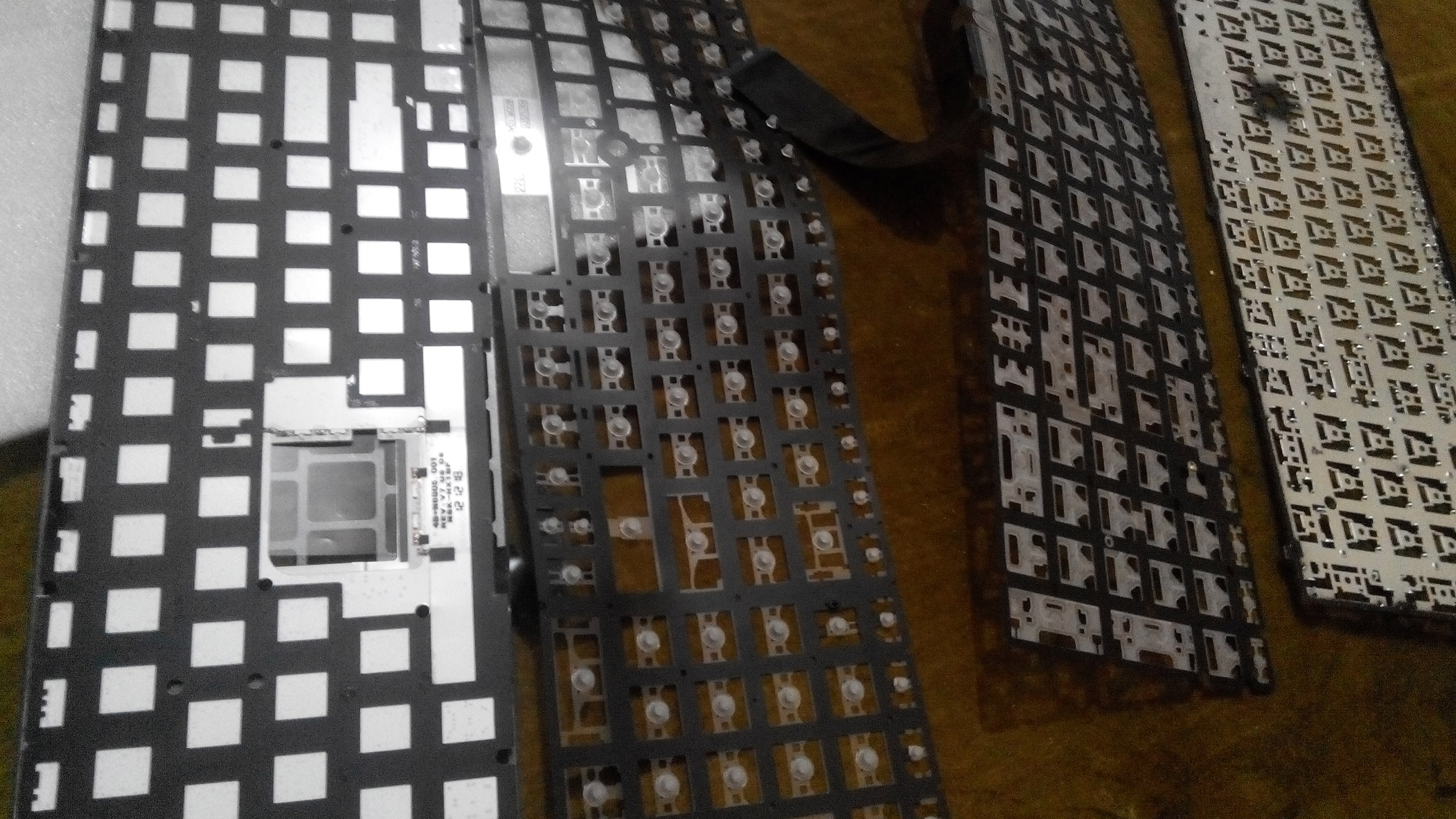

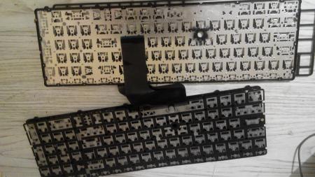

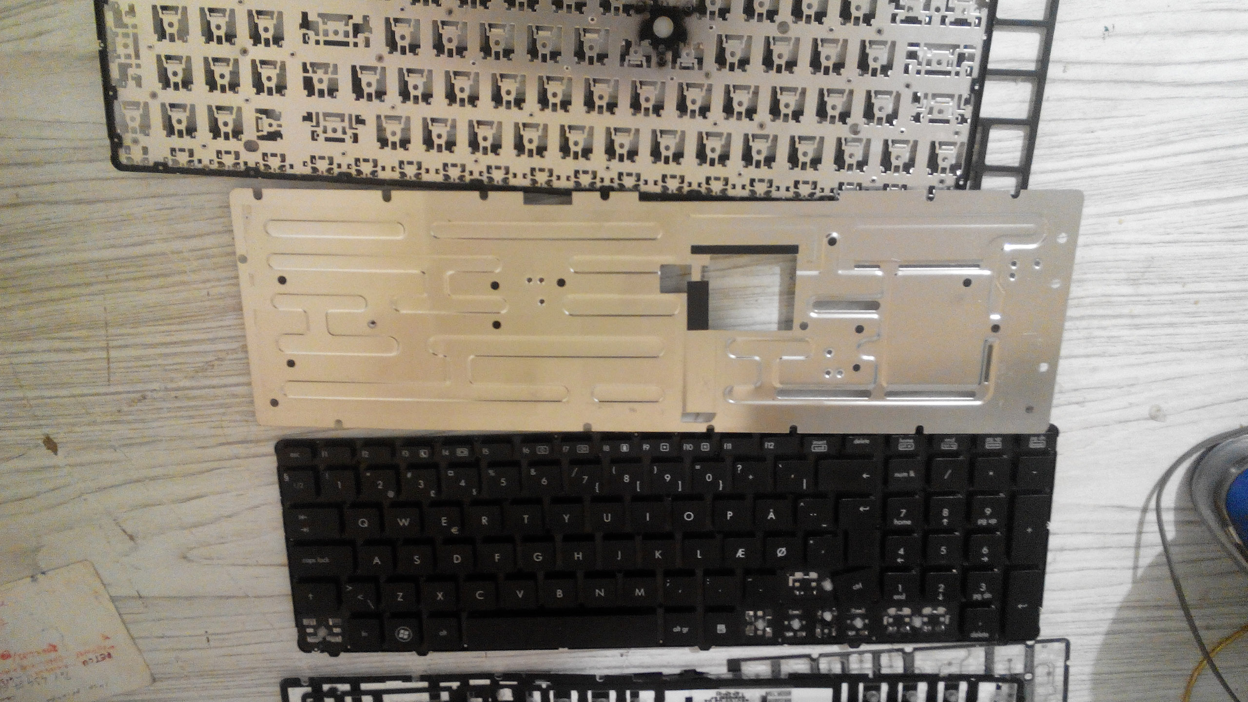

One: I tried to replace the keyboard with a backlit one, from 8570w (it's cousin, the "professional" branded elitebook with the "professional" gamma GPU's ( and the cooling system of a smartphone ) ). Firstly, the pinout matched, but the contacts not.
As I read, the keyboard is only a connector matrix, with the controller on the motherboard. So, I tried to match the pinout. Then I thought about dissassemblying them and take the ribbon with the connector "ribbon" (I am sorry, I barely know the terms in my language) and to put them into the backlit keyboard enclosure. So I took them apart, but the ribbon and the other enclosure were impossible to match, and the enclosure (bottom metalic plate) was needed to hold the special keys that have transparent letters, that let white characters glow. So, with this conclusion, I am posting the pictures, and let it be, as I don't know how to make the old ribbon stay attached to the new keys that are not opaque, as the "ribbon" with leds
can easily be attached to any other keyboard, but as log as it's layout does not allow the light to come through, it's pointless.

PS: I am sorry about the keyboard pictures, as they are beyond accepted resolution, and momentary I do not have the editing software available. Waiting for any response, thank you
