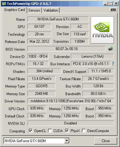

Coming soon, most is ready, need to add some stuff to the first post. Can you post a GPU-Z screenshot showing your 660m? Also I could use a second dump of the v8.01 bios.

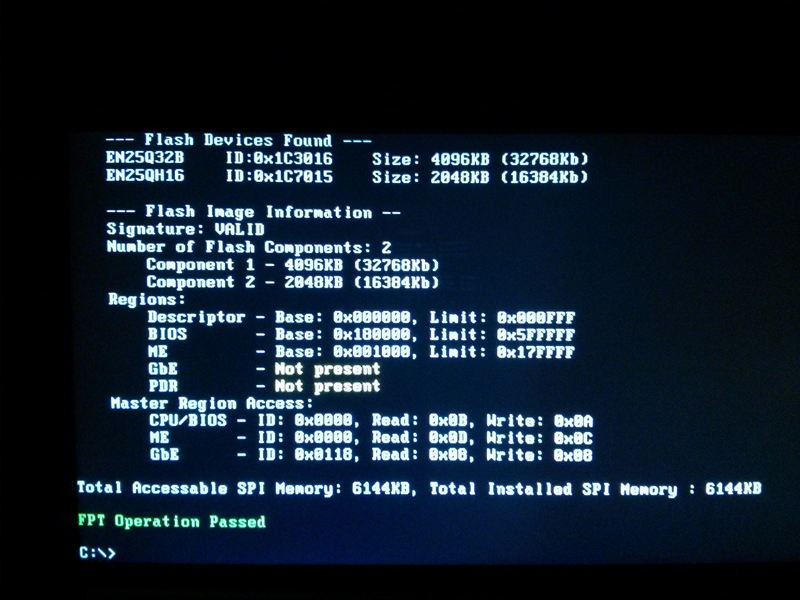

Can anyone who doesn't get 'Error 104' please run the fpt tool with the -i flag and post the output here?

I'll do this when I get home and can boot to dos. I can't seem to get the application to run with administrator privileges using runas so I'll boot from the a win98 boot disc and run it from there.

Also, here's the -i output:
Intel ® Flash Programming Tool. Version: 8.0.10.1464
Copyright © 2007 - 2012, Intel Corporation. All rights reserved.
Platform: Intel® HM76 Express Chipset
Reading HSFSTS register... Flash Descriptor: Valid
--- Flash Devices Found ---
EN25Q32B ID:0x1C3016 Size: 4096KB (32768Kb)
EN25QH16 ID:0x1C7015 Size: 2048KB (16384Kb)
--- Flash Image Information --
Signature: VALID
Number of Flash Components: 2
Component 1 - 4096KB (32768Kb)
Component 2 - 2048KB (16384Kb)
Regions:
Descriptor - Base: 0x000000, Limit: 0x000FFF
BIOS - Base: 0x180000, Limit: 0x5FFFFF
ME - Base: 0x001000, Limit: 0x17FFFF
GbE - Not present
PDR - Not present
Master Region Access:
CPU/BIOS - ID: 0x0000, Read: 0x0B, Write: 0x0A
ME - ID: 0x0000, Read: 0x0D, Write: 0x0C
GbE - ID: 0x0118, Read: 0x08, Write: 0x08
Total Accessable SPI Memory: 6144KB, Total Installed SPI Memory : 6144KB
FPT Operation Passed

Ok, thanks for the help guys, I've looked at some datasheets and I'm pretty sure I found the cause of 'Error 104'. For those who experience this, grab this file, and use the included fparts file instead of the original one. This should do the trick.
I already added the instructions to the first post, but I would appreciated if someone can confirm that it really works as expected.

I modified the vbios, if you have a 660m you should have a new default clock and higher overclocking limits. If you have a different card please post a GPU-Z screenshot.
