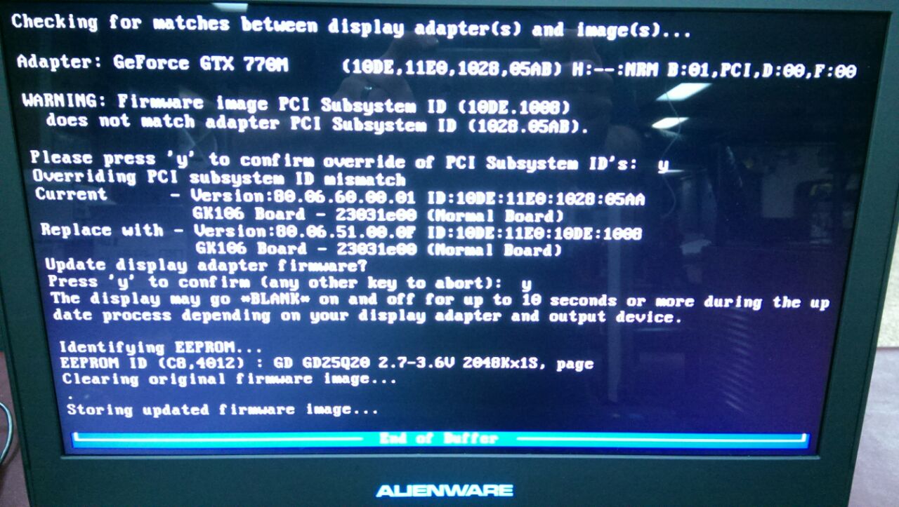

issdar Posted May 3, 2015 Share Posted May 3, 2015 Hello all, I am attempting to flash my alienware 18 770m sli, I did a backup of the bios , when attempting to flash with nvflash -I0 -6 vbiosfilename.Rom I get a pci subsystem mismatch of last 2 octets and accept with y, now screen is stuck saying the following. How long does flash take ? It's been 5 minutes, I used the Dell 770m rom posted by svl7. I rebooted system with ctrl alt del because I noticed End of buffer when scrolling down I was using freedos booting from UBCD so figured it was done. Now I am getting 8 beeps on startup ;( do I have to do a blind flash now ? EDIT: Solved problem, vbios got corrupy, with help of Mr. Fox swapped cards and removed sli cable. Was able to POST and reflash both cards with correct bios using freedos from rufus not UBCD. Quote Link to comment Share on other sites More sharing options...

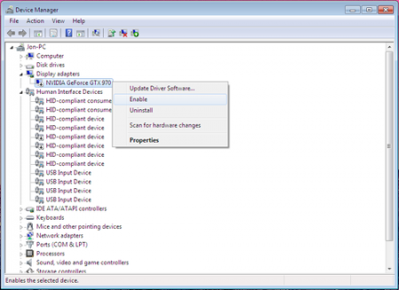

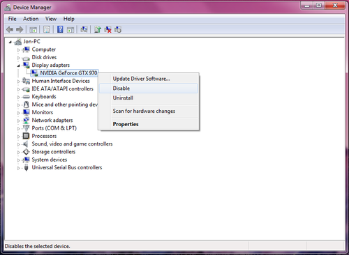

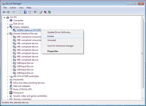

Founder Brian Posted November 20, 2015 Founder Share Posted November 20, 2015 @ewentas try what operating system are you on? Check to make sure you are using the correct file name. You may need to disable the 880M in the device manager before attempting to flash it. Then you can re-enable it: Quote Link to comment Share on other sites More sharing options...
